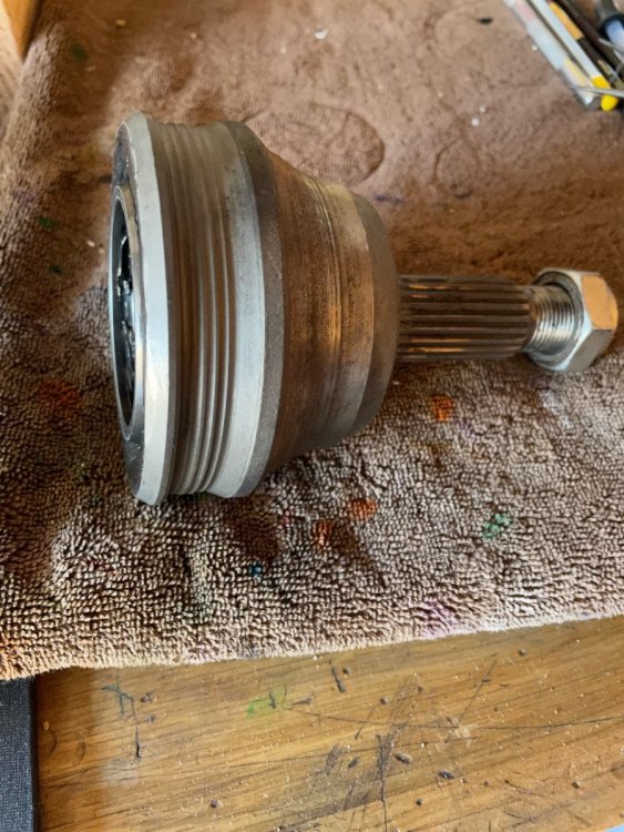

papak Posted March 10, 2022 Posted March 10, 2022 It seems that I have picked up a bit of "play" in my outer CV joints. My Birkin utilizes a mildly modified VW front joint purportedly from an early VW Golf. Tom Carlin gave a part number from one in the shop (Interpart HK VW 1-051 0516). I haven't found a cross reference to this part number in all of my searching so far. After comparing mine to several Lobro joints in local parts stores, the consensus is that this is from a 2.0l car, ruling out the earliest Golfs. As is apparent from the attached photo, the outer mass has been turned down a bit in order to fit in the inboard side of the hub. Nominally 90mm on the inboard side. The axle nut is an M20x1.5. Any help in either referencing the part number or otherwise identifying the part itself would be greatly appreciated. Tom has never had the occasion to replace one of these. The half shafts have always come to him fully assembled. In the course of refining the ECU map, I was encountering a serious surging issue upon accelerating out of a turn with the outboard suspension fully loaded. It seems as though the wear and tear was taken up by the outer CV joint.

wemtd Posted March 11, 2022 Posted March 11, 2022 (edited) Papak Here's what i have in my notes: (possibly from the former Yahoo Birkin group). outer CV spline is VW (into the upright) I hope this helps 1. Axle, inner CV joint: 357498201A Inner CV Boot Left. Audi 4000 83–87 VW Golf 92–01 2. Does anybody know from what car the outer CV joints of the S3 IRS came from? AUDI 80 (89/89Q/8A/B3) 1986-1991 SEAT CORDOBA (6K2/C2) 1993-1999 SEAT IBIZA II (6K1) 1993-2002 VOLKSWAGEN CADDY II (9K9B) 1995-2004 VOLKSWAGEN PASSAT VARIANT B3/B4 1988-1996 VOLKSWAGEN VENTO (1H2) 1991-1998 VOLKSWAGEN POLO CLASSIC/VARIANT (6KV#) 1996-2002 The application will vary in different countries but this should get you started in the right direction. 1. xxxxxxxxx: replaced his Outer CV boots with CarQuest /Advance Auto. The part number is CFD DX257, and it was about $15. Edited March 11, 2022 by wemtd add info.
