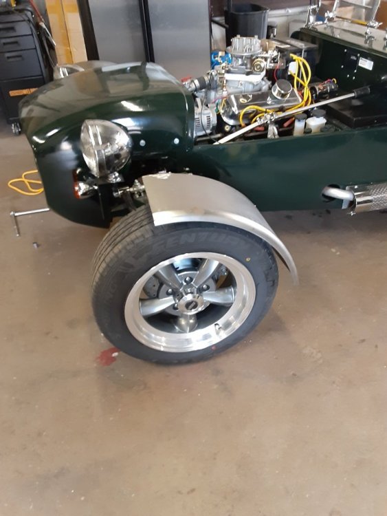

Alex-Ks1 Posted August 23, 2022 Author Share Posted August 23, 2022 So , it drives great noisy as hell ,flames shoot out of the exhaust pipes that's because of the cam size overlap, no big thing ,looks cool at night , and I'm doing the fenders now , I'll have them shaped and painted this week end , this photo is in the ruff , the fenders still have to be rounded on the edges ,. Link to comment Share on other sites More sharing options...
