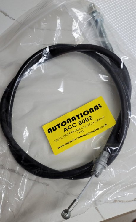

These are available at Caterham.
Should work on Escorts and T9s
https://caterhamparts.co.uk/clutch-cables/2568-clutch-cable-lhd-de-dion-vxrv-and-live-axle-95.html
They aren't known for reliability (First Line FKC1020)so get a few.  They shear at the eyelet crimp.
If anyone knows a better cable,  chime in.
