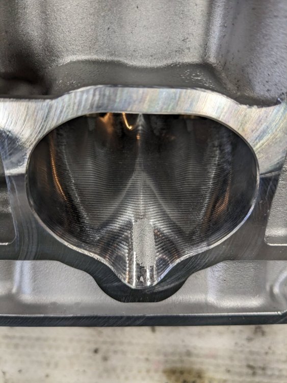

My 4Piston Racing cylinder head arrived yesterday, looks amazing they do great work. I new inlet manifold CNC matched should arrive soon. I will be busy this weekend:)

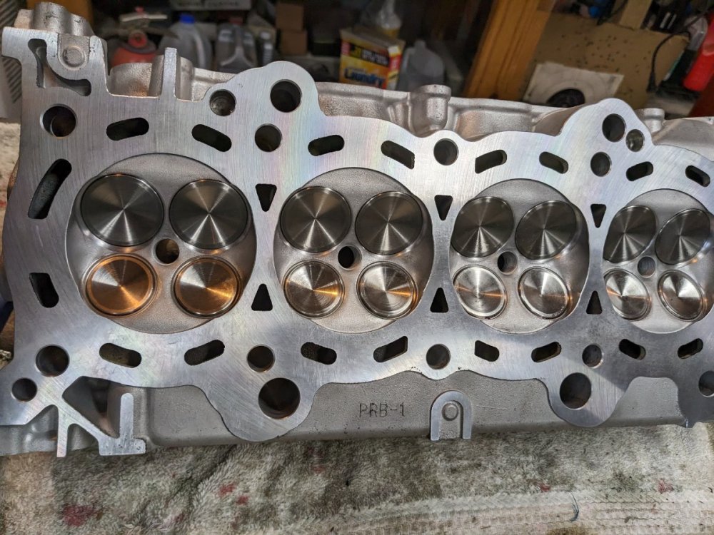

This is a K20A2 large port head that I will be putting on my K24A2 block. The K20A2 head swap is the hot ticket, the K24A2 was out of the Acura TSX, Honda gave it smaller ports for more torque to move a heavier  door car. The K20A2 is out of the Civic SI or Integra Type S.

Work is progressing well, ready to start putting it all back together.

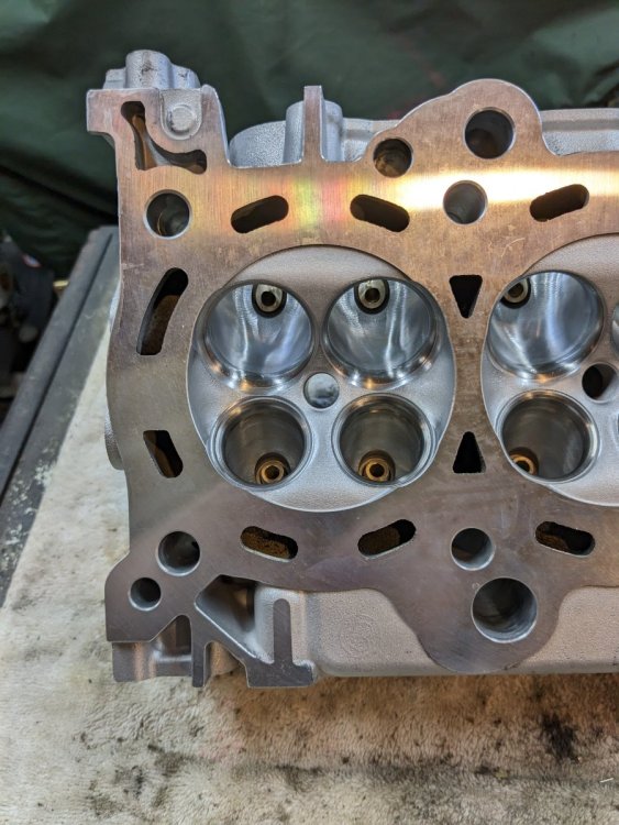

Off with the head
Awaiting there turn

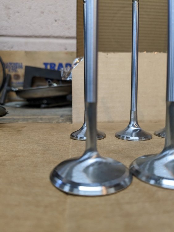

Undercut inlet valves

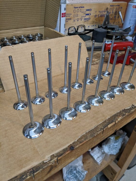

All accounted for

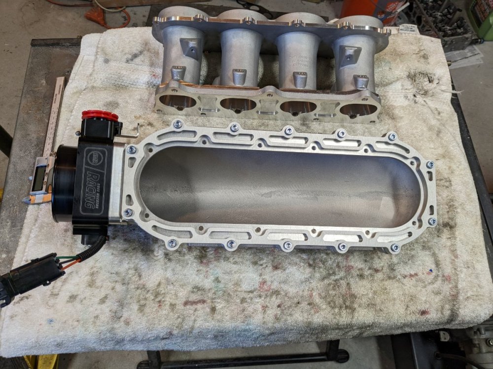

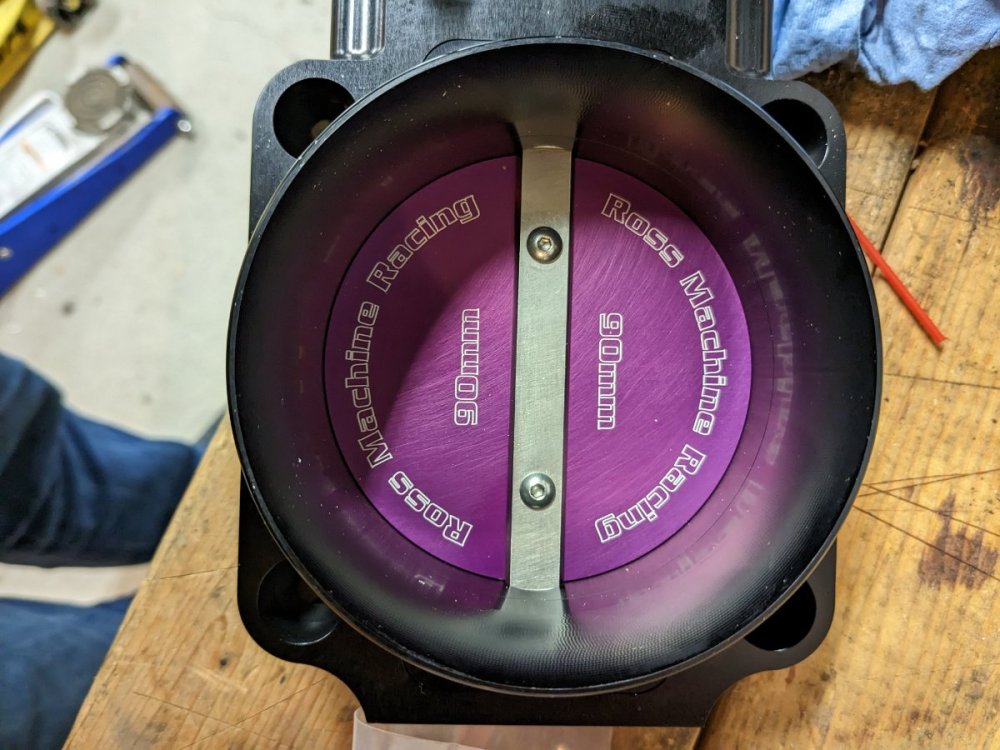

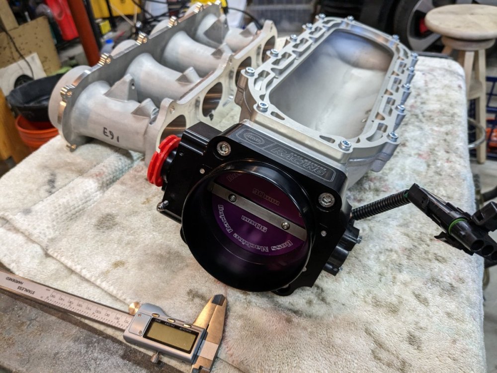

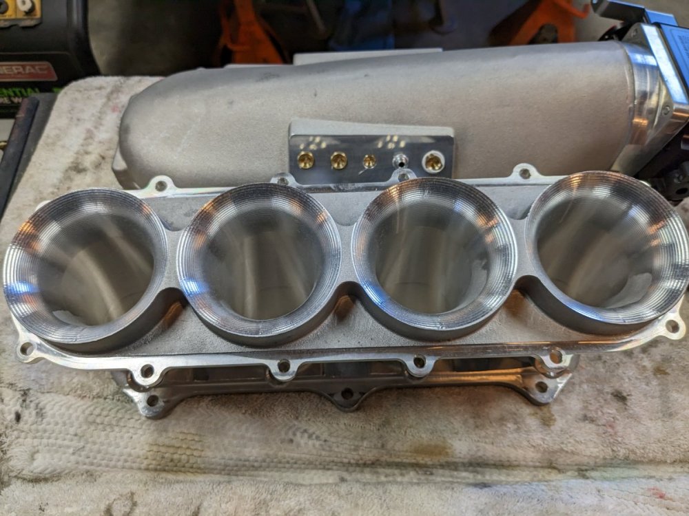

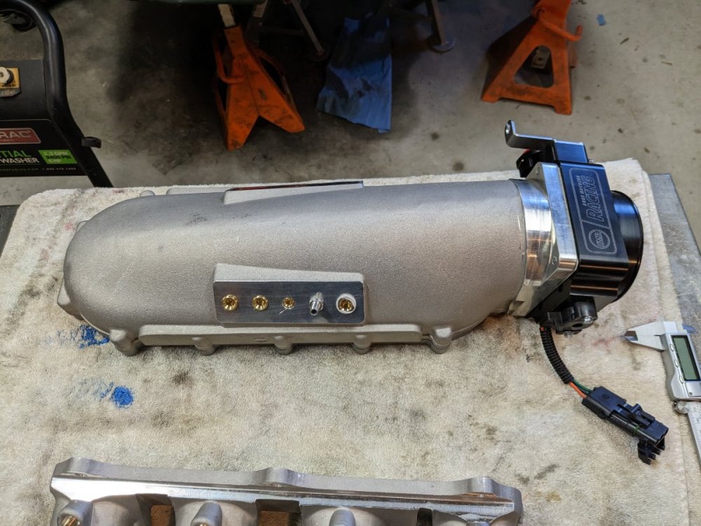

Last piece of the puzzle arrived this morning, the CNC matched inlet trumpets for the inlet manifold. The Skunk2 Ultra Race manifold is using a 90mm Ross Machine Racing throttle body. The RMR TB uses a Ford TPS sensor, so yes there will be a single Ford component on my Honda engine. I did pick up a genuine NOS Motocraft unit, and got 2 for safety:)
Graham
