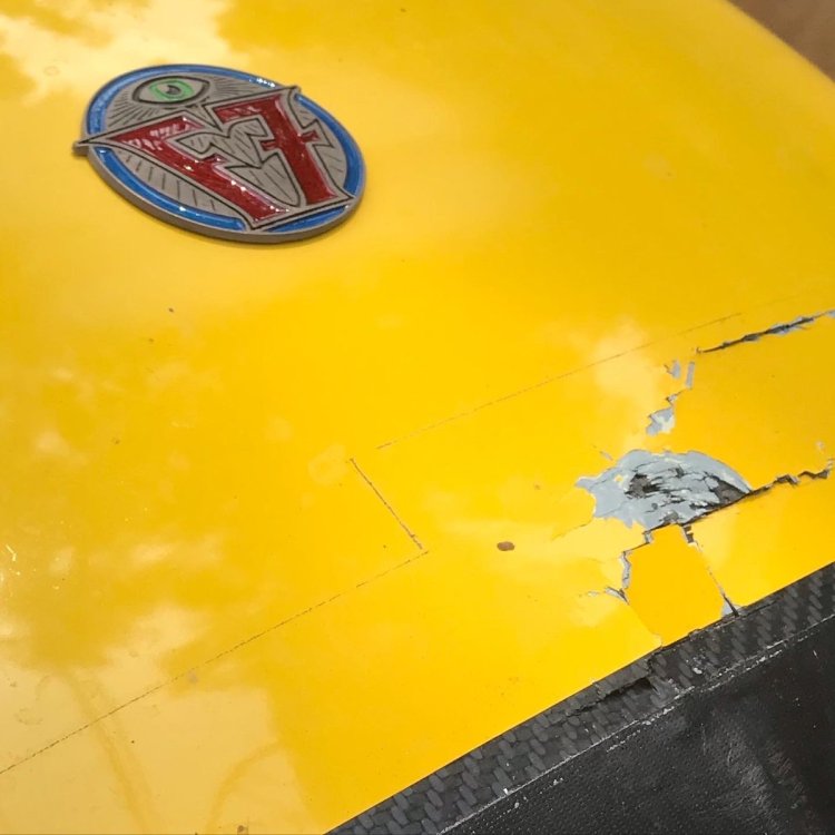

Well, here goes, I'll take a stab at the first post. I'm working on a long term Locost build dubbed the Fauxtus 7. I'm a long way from completion, but thought it would be fun to take a little diversion from fabrication and work on a hood badge. Full disclosure, I did the 2D design, a friend did the 3D modelling and some of the prints, other prints were made using an online service.

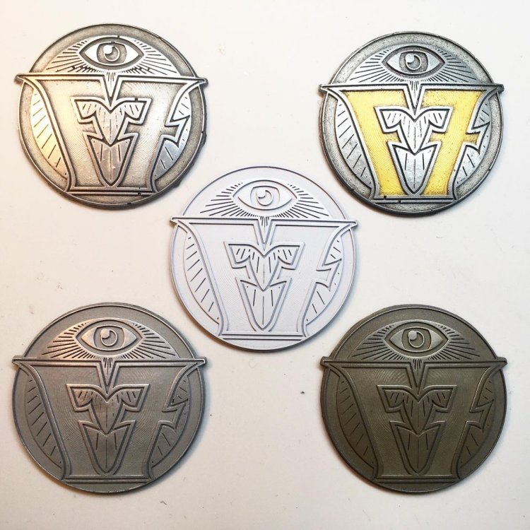

The model was printed by an FDM and an SLA printer (I don't know any detail about the printers). The line work ended up being too fine for the FDM to hold the detail, and even though the resin printer reproduced all the detail, I'd make some of the line work thicker next time.
Using the resin prints, we painted some directly and also made a silicone mold and cast a few using metal filled epoxy, with varying results. Again, as with the initial prints, the silicone had trouble with the fine line detail and began to deteriorate after several castings.

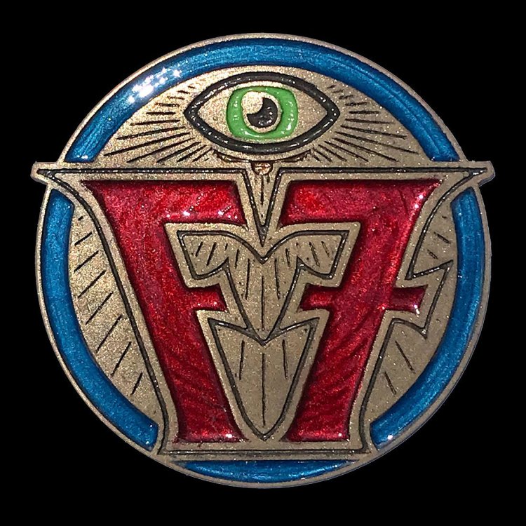

I also sent the model to craftcloud3d.com and tried a few different materials including a bronze filled PLA. With this material and the metal filled epoxy, you can get something approaching a polished metallic surface.
The red and blue version is the bronze filled PLA print painted with Testors model paints in candy colors which are a little transparent and let some of the "metal" show through. Top surface was wet sanded and finished with fine scotch bright.
