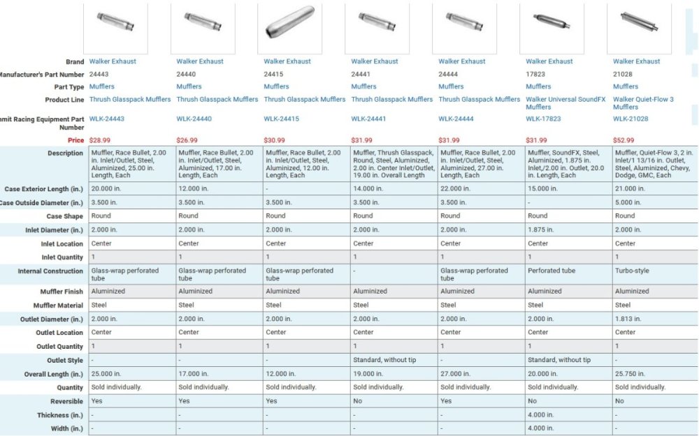

MV8 Posted June 20, 2023 Share Posted June 20, 2023 Nice car. Great detail pics too. I like your choice of muffler. Curious about the pipe size. Do you remember the part number or application? Looks stainless. Seems fairly quiet with no pipe behind it. I compiled these last year for general spec comparison but none are stainless. Link to comment Share on other sites More sharing options...
jbcollier Posted June 20, 2023 Author Share Posted June 20, 2023 It's a MagnaFlow 1 3/4" in and out. Yes, it is SS. The header is mild-steel and ceramic coated. I'm just about to bend up a mild-steel tailpipe. That will quieten it right down -- which I like, my boy racer days are long over.. Link to comment Share on other sites More sharing options...
