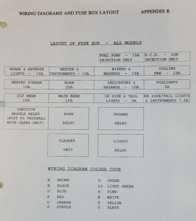

IamScotticus Posted September 12, 2023 Posted September 12, 2023 (edited) this is from a 1996 manual but the fuse block looks similar we need to know the specific build of your car. Edited September 12, 2023 by IamScotticus
