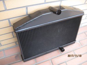

Here's the one I need. I've found one on UK eBay for L344 plus bunches of shipping. I think I'll try for a repair, if I can find a shop that still does that. If it's brass (I have not checked), I could solder it or braise it.

There was a Dan D Radiator Repair in Carabelle but it's long gone. Try Casper in Panama City or Dothan in Dothan. If actually needs a new core (i.e. full of pin holes after cleaning) you may be done as I doubt a new copper core is available.

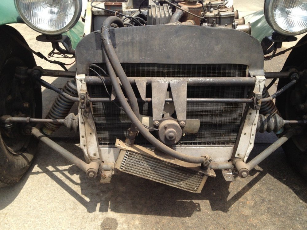

Looks like all the fasteners are down unda the lower tank. Never seen that before...
Good news if it is just the tank edge. Hand torch, acid solder, and flux should work well. May be able to reflow with just the torch and flux.
Link to comment
Share on other sites
Out. Pin hole under the manufacturer's label. It's brass! I can solder it.
It was tricky getting it out. Released the four bolts on the steering cross bar, moved the rubber boots out to the wheels, and twisted it past the fan motor. Thanks for the coaching.
Edited by Timothy Keith-Lucas
added
Link to comment
I did get a bunch of debris out of it that didn't come loose the last time I flushed it. Yeah, we had a very hot summer here in north Florida. Until I added an oil cooler and a set of fan blades on the front of the water pump, she overheated with alarming frequency.

Do you have the top baffle that JB mentioned? Very important to keep the air through the nose flowing through the core instead of over the top tank. A modern, direct mount, high amp electric fan to replace the unshrouded original would help. What is the distance between the tanks (core height to fit a fan)? Most aftermarket fans are actually narrower than advertised in one dimension.

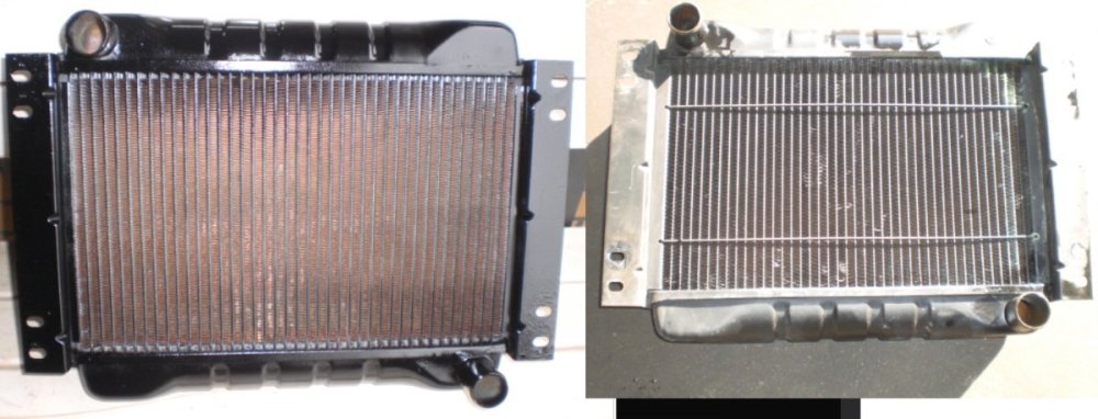

Found a pic of the baffle. I'd make a card board pattern that lays flat against the front of the upper tank and picks up a screw into the chassis on each leg, then fab with .050" 3003 h14 from aircraft spruce. I'd add foam tape to the baffle so it doesn't actually touch the upper tank but is supported by it. Rubber strips rivetted, clip-on weatherstripping, or aircraft baffle material can be added to the edge to seal but just getting it close to the inside of the nose will help. 211414.thumb.jpg.8910a521cbb2155bffd4120f7e8ff166.jpg

That's really professional work, MV8. As a temporary addition until I can get the materials together, I've added a block of closed cell foam on top of the radiator to reduce the leakage over the top. So far, my adventures in Florida 2023 cooling of a cold wet English cooled sports car has included:
1. Bunches of flushing
2. Oil cooler
3. Repair radiator leak
4. Temporary baffle
5. Repair electric fan
6. Add fan blades to water pump
Autumn has come to North Florida. 68 this morning, not 82.
