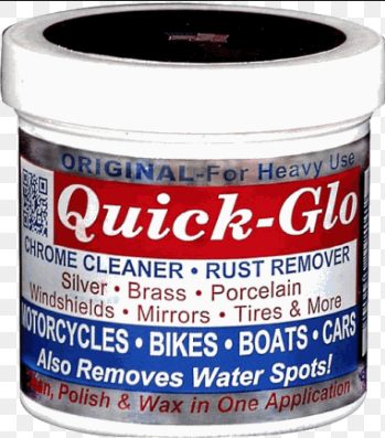

IamScotticus Posted September 30, 2023 Posted September 30, 2023 (edited) The removing of axles and pumpkin don't require special tools and come out without too much effort. Its the disassembling of those sub assemblies, like bearings from the shafts and changing pinion, crown gears and differentials, that require the special tools. You shouldn't have to do any breakdown for a refresh and bearing greasing. If the brake cylinders have been sitting for ten years, check those bores for rust. Have a tube of brake grease ready for the reassembly if you get lucky. Get a tube of black silicone sealant for the hub mount and back plate sealing. Theres a neat product , Quick- Glo, for rust removal and polishing. good for spot cleaning and parts like the Park brake rod. It comes in different grits and leaves a protective wax coat. Edited September 30, 2023 by IamScotticus
TEM Posted September 30, 2023 Author Posted September 30, 2023 Looks like an interesting product but the company appears to be out of business and the product seems to be only be available on ebay. 1
