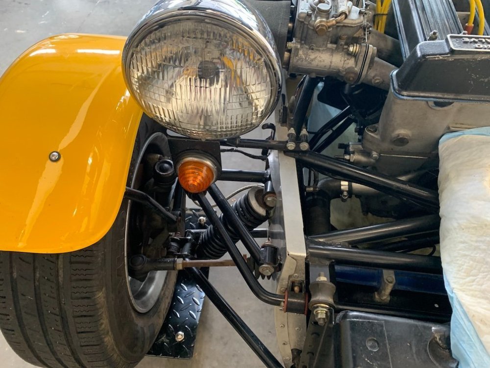

@MV8 It looks perfectly fine to me. The new style brackets mount to the front of the upper A-arm mount
image.png.f657de1f43378fc592479634eb8b62e8.png image.png.ffa7bc5099a3534ca4c01ec5727a82e9.png
You're right. I didn't realize they moved the lights forward on the newer cars.
They did! And they look much better - in my opinion! I guess after a few iterations they finally got it right!  haha

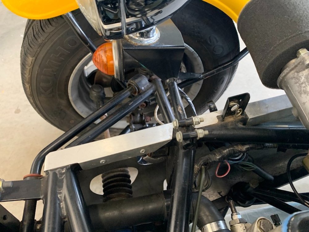

@windsurfer
See attached picture. Caterham made it easy. The distance from the true middle of the mounting at the suspension arm "A"  to the true middle of the "donut" where the lights actually mount "B" is 3" inches in all 3 directions. I measured as best I could since my lights are already installed but even if they are out by 1/8 to 1/4 it will be close enough.
Don't forget that the top of the "donut" (B) needs to be level but the suspension bolt isn't level
I hope this helps. Post a pic once it's done. Good luck.

Oh! Thanks a lot das76! Very appreciated!!!
