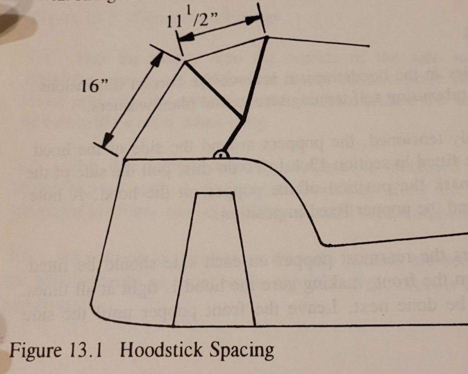

We got back at 4:30 just as the power came back on. From then until 8:00 ish we fought with the hood (roof). Turns out after looking at a half dozen videos and pages of photos I learned that older S3’s like mine have the hood stick mounting tabs welded flush with the outside skin. New Caterhams have that same tab welded on the inside of the frame tubes. Hence, my brand new hood sticks are for a newer Caterham S3 and not the older style like mine. Too late now as I have already drilled and test mounted them.

We tried a test fit and that’s what killed it for us. We fought for over an hour, tried everything we could think of but there was just no way we could get the main tube to line up with the Velcro section in the roof. We can get it to within about a ½ inch but that’s it. The roof at this point is under so much tension and the main tube where it bends is pushing out the plastic side windows yet the area around the door is slack. It’s as if that main tube is too tall for my hood. Or, my hood isn’t tall enough for these sticks. I’m quickly learning I have no tolerance for things like this anymore. After fifty years the wife is very patient with me. But, only to a point. Once I start to stutter its downhill from there.

If the outter hood stick is on top of the boot frame tube, it is correct.  Have it there to fill the boor cover.  The difference is some sticks have a bend in them to accommodate the FIA bar hoods, etc.
From 1995
Another situation are differences between DeDion and Live Axle chassis. It's possible you could have mixed parts.

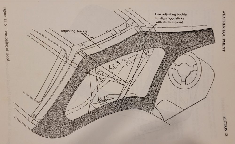

Back and forth I went looking through the Assembly Guides and checking on-line photos, diagrams and videos. Meanwhile the wife kept playing around. The longer the hood sat in the sun the easier things got. In one build thread the guy mentioned that unzipping the rear window made it all work. Before I got outside with this info the wife came into the computer room and told me she had it on and all buttoned up. She said the trick was UNZIPPING the rear window.
