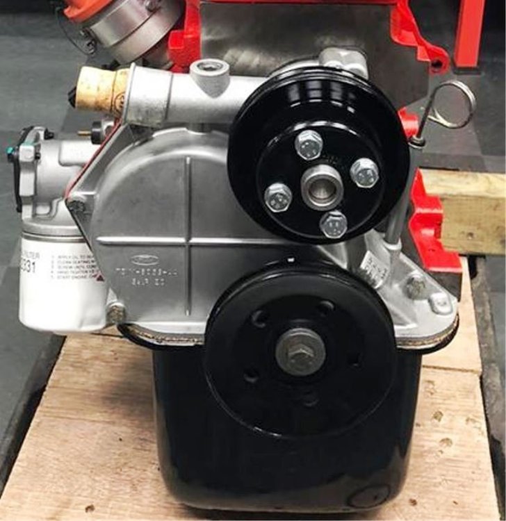

MV8 Posted June 1, 2024 Posted June 1, 2024 (edited) I still think you have abnormal restriction through the head gasket. Also, the crank pulley should be bigger than the water pump pulley which is most critical for lower rpm. Here is a pic I found (happens to be a xflow). Note the crank pulley is bigger. Looks like it should be 4.75-5 inch od if the water pump is 4.25. Senc may have an aftermarket smaller crank pulley too. It sounds like the crank pulley is undersized, slowing the water pump: https://www.burtonpower.com/v-pulley-crankshaft-4-steel-fp224.html "Pulley is also smaller, reducing speed of water pump..." This place offers many pulley options. May want to ask how big the standard pulley they offer is: https://anemboengineering.co.uk/x-flow/ Edited June 1, 2024 by MV8

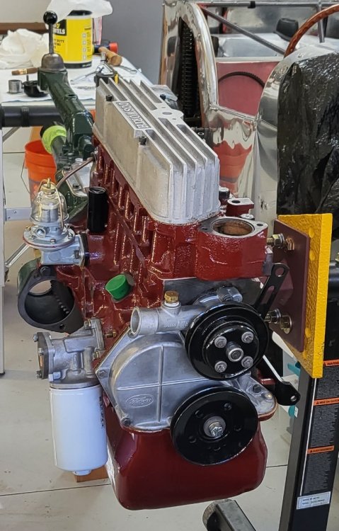

SENC Posted June 1, 2024 Posted June 1, 2024 (edited) Agree with MV8 on the relative sizes - I didn't notice your measurements before. Mine is similar to the picture MV8 posted - I can grab some actual measurements if you'd like. I believe the crankshaft pulley is 4" diameter and the water pump pulley slightly smaller. EDIT: my memory was right and wrong! My Elan has a 4" diameter crankshaft pulley, but my Seven is 4.75", as MV8 estimated. My water pump pulley on both is 4.25" If you have the 4" crankshaft pulley you're definitely losing some efficiency at the pump. Edited June 1, 2024 by SENC
TEM Posted June 1, 2024 Author Posted June 1, 2024 Now that makes more sense. I doubled checked the measurements now that the water pump and V-belt are off the car. I can't get a caliper into the space to measure the crank pulley so that one is eye balled with a tape measure. Both numbers are confirmed with water pump pulley at 4.25" and crank at 4.0". And that crank measurement is generous. It might be a 100mm metric (3.94"). SENC, from the pictures of your engine it looks like your crank pulley overlaps your timing marks. Do you have any trouble timing the engine? My pulley has the timing notch on the outside of the pulley which, given the angle I have to hold the timing light, would make it difficult to see both marks.

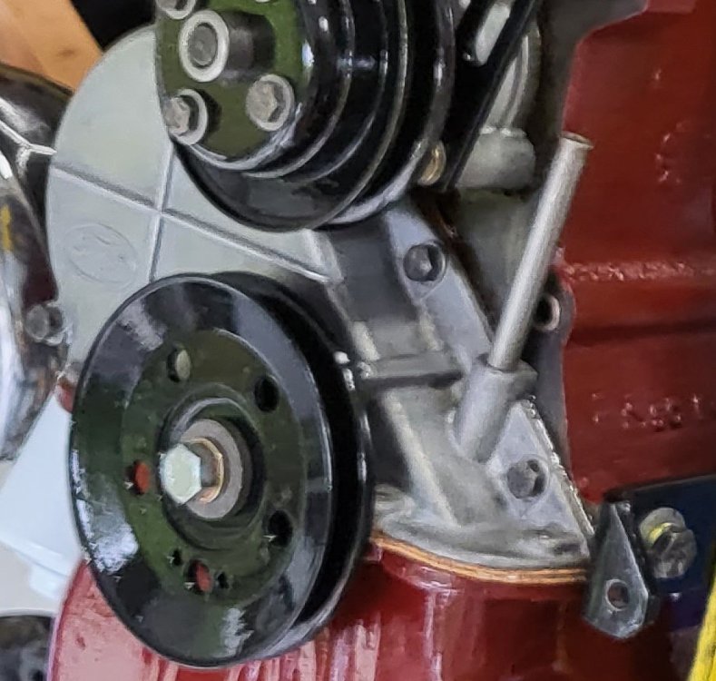

SENC Posted June 1, 2024 Posted June 1, 2024 Smaller crankshaft pulleys were used frequently by racers to reduce wear in the water pump - and as they were almost always above 3k rpm it would pump just fine. Here is a closer shot of my crankshaft pulley and timing marks. I'm not with it right now, but it appears they are roughly on the same plane.
