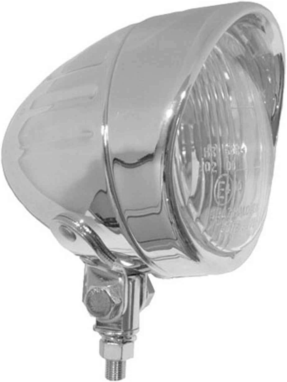

Stalker LS3 Posted September 3, 2024 Share Posted September 3, 2024 Been looking for a LONG time for different/smaller head lights due to mods tot he car I really need them. Well look no further: https://www.amazon.com/dp/B0055DQZOC?ref=ppx_yo2ov_dt_b_fed_asin_title Mine should be arriving Monday. Cant figure out posting a picture :BH: Hope this helps somebody. Thanks Scott In Chattanooga Link to comment Share on other sites More sharing options...

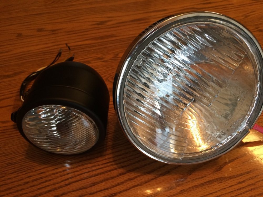

oilteq Posted September 3, 2024 Share Posted September 3, 2024 The large headlights that came on my Birkin made it hard to remove the nose if I need to access the radiator or the front of the engine. I rotated them somewhat outward, but after doing so a couple time, one side became loose. So, I opted for smaller lights which gave me plenty of clearance and fixed the problem. They measure 4" in diameter including the housing and 3.5" across the lens. They have low beams and lower beams. I sometimes use the lower beams as driving lights, but they are worthless for lighting up the road. I keep them on high beams on the rare occasions I drive at night and they do a fair job. Stalker, let us know if yours throw out enough lumens. Link to comment Share on other sites More sharing options...
jbcollier Posted September 8, 2024 Share Posted September 8, 2024 If you are going that small, it is a good idea to switch from a reflector type headlight to a projector type. Small reflector type headlights are borderline useless in the dark. Link to comment Share on other sites More sharing options...
