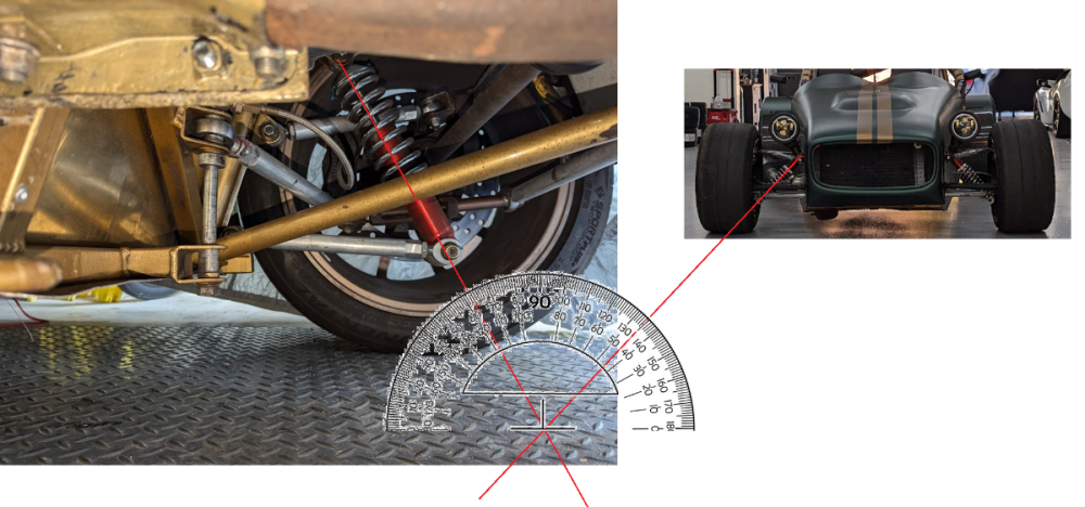

nc7s4 Posted October 18, 2024 Author Share Posted October 18, 2024 Motion ratios incoming! I will measure the actual distance traveled Not sure if this will be the same for all wcms but maybe a useful reference Link to comment Share on other sites More sharing options...
nc7s4 Posted October 18, 2024 Author Share Posted October 18, 2024 MR for front is approximately 0.57 MR for rear is approximately 0.89 Info used: Front: 0.81 * cosine (45) = 0.57 Rear: cos(27) = 0.89 D1 - 10 7/8 D2 - 13 1/2 D1/D2 = 0.81 1 Link to comment Share on other sites More sharing options...

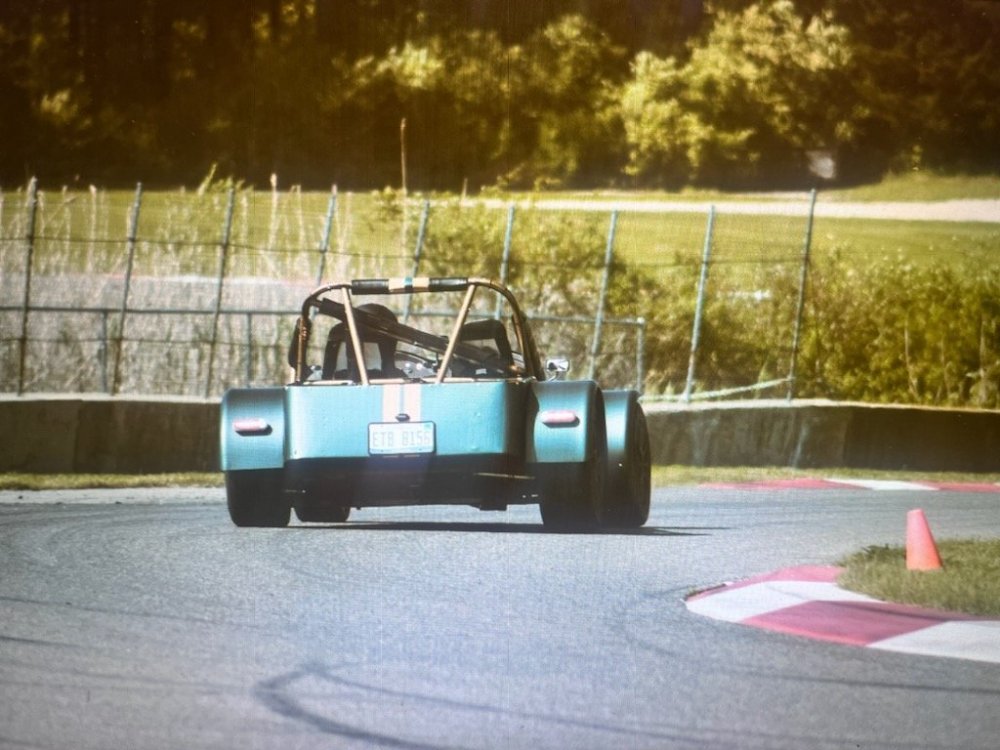

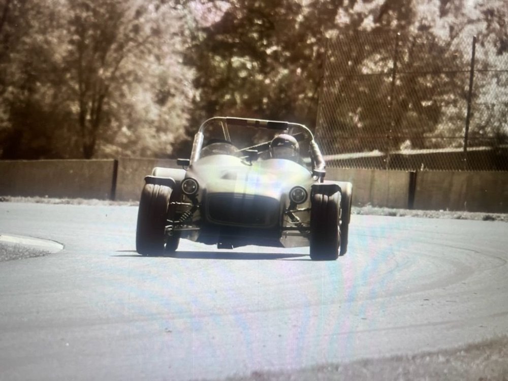

nc7s4 Posted October 20, 2024 Author Share Posted October 20, 2024 Yes these spring rates for the wcm are way stiffer than caterham. 2x stiffer I am using the advice from westtexass2k who ran 550/250, apparently, based on his prior posts here. I can only assume the force/motion ratios are way different for the wcm vs caterham. Goal is to set the car up for road racing. Arb, springs and dampers will all work together to address this excessive body roll but right now I'm just considering the spring rates Here are some pics of what looks like too much body roll and how I took the angles. Not totally convinced this body roll is bad but it looks a lot different from super 7 race cars that are not as rolly Link to comment Share on other sites More sharing options...

Croc Posted October 20, 2024 Share Posted October 20, 2024 A couple of observations: 1) I am not comparing your spring specs to a Caterham. They are not comparable. 2) Roll is not a monster that needs to be slayed. When well controlled it is very useful in assisting weight transfer around the wheels while minimizing grip breakaway - particularly on a light car like a WCM. Running without an anti roll bar is not always bad - I do the same on my track car - but you are right the springs have to be calibrated to avoid excessive roll. 3) Looking at your photos, I could possibly argue the front on view has some dive to it but photos can be deceptive and that is a downhill corner entry which accentuates the angles. The math you are doing is good to check seat of pants feel. The rear view looks normal to me - no evidence of excessive roll. 4) The revised rear spring to 225 feels more what I would expect given the front at 500/550. Is there a caster limit on the front? What amount of caster are you using? Link to comment Share on other sites More sharing options...

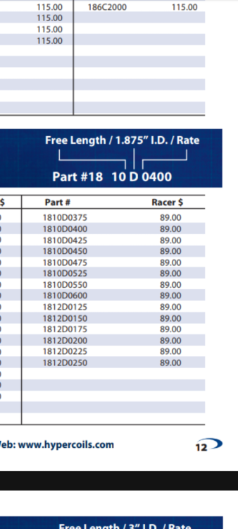

nc7s4 Posted October 20, 2024 Author Share Posted October 20, 2024 (edited) Running 4.5° of caster. Good to know that the pictures don't look unusual to you. Only reason I have right now to change anything is to get a positive identification on what I am running. I took some measurements of the wire diameter number of coils, inside diameter and ran it through a sketchy calculator that told me the spring rate. That is why I am guessing they are 500 lb Could disassemble everything and get them checked, but by then I might as well replace them considering the relatively low-cost of doing so. My situation is definitely limited by driver skill. Won't really need any upgrades until the car handling becomes the bottleneck. Nice to have all of this lined up though as I do intend to keep making improvements. Appreciate your experience with the arb situation. Maybe not needed after all. Edited October 20, 2024 by nc7s4 Link to comment Share on other sites More sharing options...

nc7s4 Posted November 1, 2024 Author Share Posted November 1, 2024 Quick update regarding my new springs and shocks. They do not work!! 10-In heavy springs are too tall. Even at the top of the shock perch the ride height is too high. Need to figure out how to fit shorter springs. I think that only the rear of the car has clearance issues, front will fit industry standard 2.25 ID springs. The rear of the car will probably still get 1.875 ID springs, but the problem with that is that they are limited in what you can get. It looks like the heaviest 8-in option is 250 lb. That may be what I end up with in the back. If the front can fit 2.25 in springs then there is any rate imaginable in that size 8 in long. 1 Link to comment Share on other sites More sharing options...
