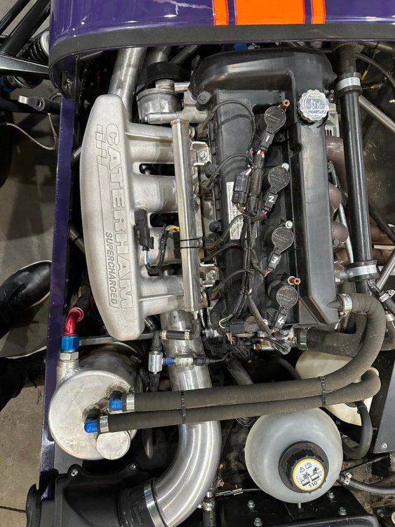

So your somewhat stock 620 under bonnet configuration will look like this:
The cold air intake is the silver looking pipe that heads down and curves to the left to a black box then the rubber grommet that sits between the intake and the inside of the bonnet.
To rule out the bleeding obvious by those unfamiliar with the 620 engine - it has a supercharger.  The traditional upgrade path for regular Caterham Duratec engine owners of Caterham roller barrel throttle bodies is not a viable option.
Not a lot of room to work with either - and the photo is an SV.
Knowing that, lets see what you can suggest for Pickles.
