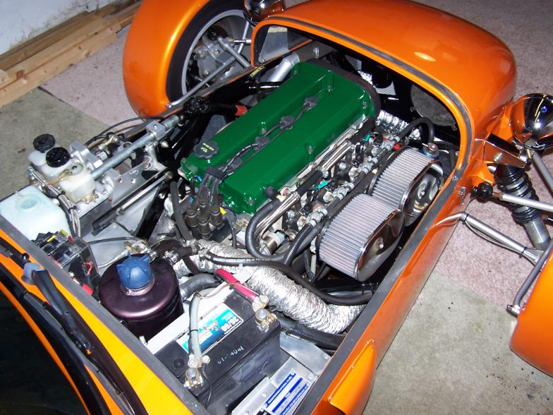

11Budlite Posted August 8, 2010 Posted August 8, 2010 twobone - I have 4.5" x 7" x 4" tall K&N's that I run on my Birkin with 45 TB's. They should work for your 40's w/trumpets. I got them from APT and they were p/n 56-1365. Here: [/url]http://www.aptfast.com/apt_parts/Kn_parts/a_KN_filters.htm
S1Steve Posted August 8, 2010 Posted August 8, 2010 (edited) Same size as Bruce's, but mine are center post. Edited August 8, 2010 by S1Steve
