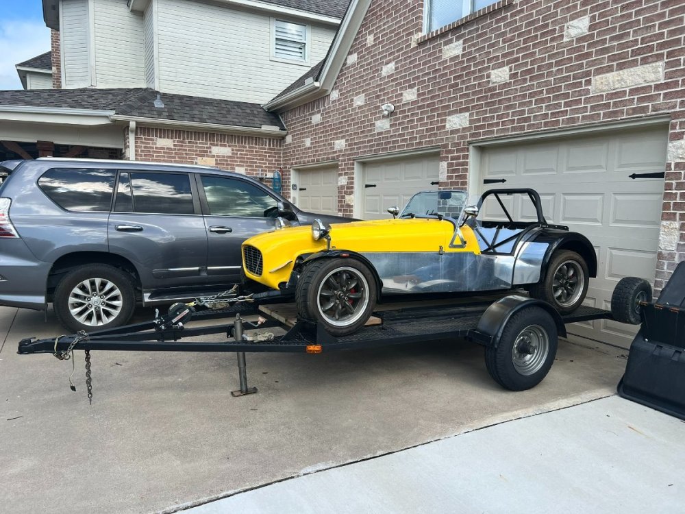

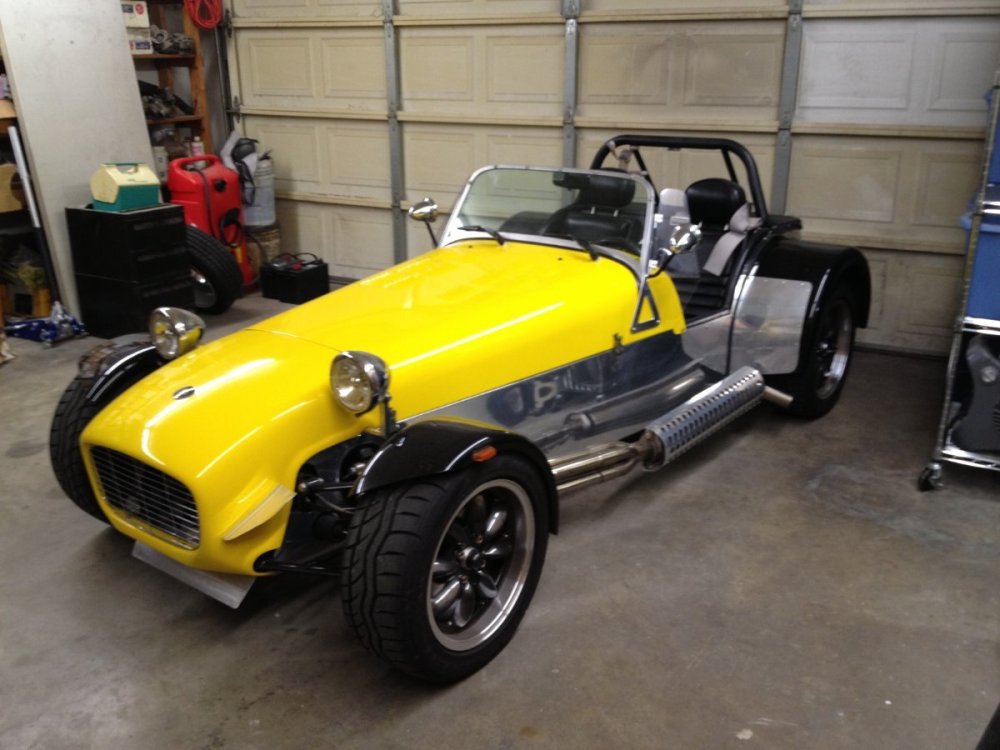

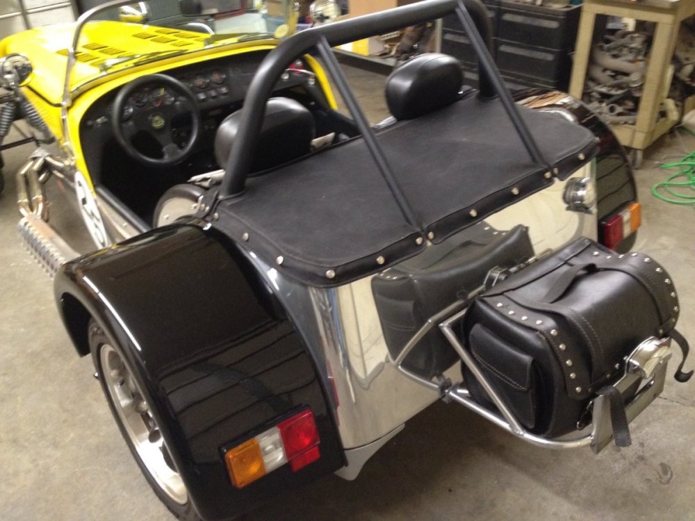

  5. It is time to sell a project that I am now too old, and busy, to have on the schedule. This is a 1999 Birkin 7 S3 kit that was built 10 or 11 years before I bought it in 2012. I received it as a very well sorted 7 that had never been titled. The previous owner pretty much just auto crossed it and cruised in it. Shortly after I bought it, I found a perfect all steel, tuned, and refreshed hot street Cosworth built 1700 BDA. I jumped in the deep end and paid big bucks for the BDA. I sold the Kent 1600 crossflow to help fund this project and never got around to completing it. Crazy me, as it was a phenomenal car with the original engine. This car has lived in my enclosed trailer since 2012. I have finally come to the conclusion it is time and have sold the Cosy BDA. The easiest build would be with a Ford Kent or Zetec engine, as that would put the exhaust and the carbs on the correct sides. A Duratec would require changing intake and exhaust sides and thus covering the original cutouts. The first three photos were taken today, with the rest from 2012. I have a perfect LBC trailer that can be included. It was purpose built for MGT series cars but is perfect for the 7. Other than engine, carbs, starter, and alternator everything is complete including crank fired ignition. While I need to run to East Texas to get the T9 tranny out of my storage trailer there, I am internally debating how to price this. Or maybe should just put it on Don't Bring a Trailer.
