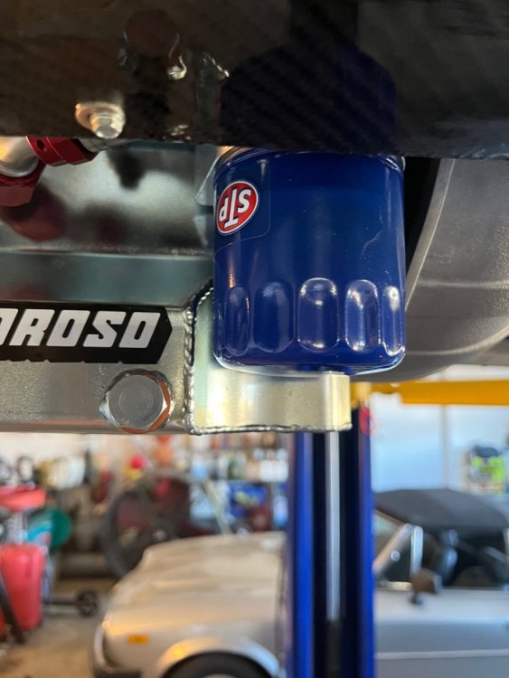

  13. Oiling system - Oil Pan: I went with a went sump system for two reasons, 1 Cost of a dry sump system and 2 not knowing how i would make the dry sump pump and tank fit. Having had oiling issues on my C6Z06 I wanted to have as much protection as possible short of the dry sump. For that I wanted to have a 'racing baffled' oil pan and an Accusump / Oil Accumulator system that would feed oil it need it in a turn. Important Learnings: Oil Pan Height/Depth is VERY important. You want the shallowest pan you can get. Scott Minehart recommends the stock LS3 pan with is 4 5/8inches deep. I did not want that pan as it does not have racing baffles and only holds 5 quarts. Plus looking at the design of the pan I am still confused on how oil doesn't get stuck in 'valleys' away from the pickup tube. See pic below. I found other online pics and could see any holes to allow oil out of those areas to the pickup tube area. I originally bought and installed a beautiful Moroso Oil Pan that was 6 inches deep/tall. I figured the extra inch and 3/8s would hurt but trust me it does. After lightly scraping the pan a few times I removed that pan and went with the Kevko Pan listed in the parts section above. The Kevko pan is 5 inches deep and race baffled to keep the oil next to the pickup tube. This fit great and lined up with the bottom of the bellhousing. I HIGHLY recommend installing the oil pan before the transmission. The Two oil pan bolts in between the bellhousing and pan took me 90minutes to screw in. Still not sure I could do it again. To get those two I had to use a flexible screw driver with a socket bit on top. Even fitting the bit and screwdriver in was extremely difficult.

  16. So long time without posting an update but as I mentioned above I spent all the spare time I had finishing the car so I could make my first track day with it last weekend 4/15. The car did great but my weekend was short lived so I didn't get to compare lip times etc. I was at Putnam raceway in Indiana with 10/10ths motorsports. I instruct with them and run the Advanced group and then my friend runs right after me using my car in the intermediate group. Saturday was a beautiful day and I was up first. I had a 30 minute session and spent the first 20 minutes or so of it doing 5/10 and watching the gauges even in the turns. I was pleasantly surprised to see nothing looking off. Oil pressure looked great (maybe even a little high?) but was between 45 in the turns to 95 at WOT down the straights. After owning a c6z06 that would dip to under 10 in some turns I liked this MUCH better. AFR looked good, water temp was great and the car just seemed to drive like you would hope for. The last 10 minutes I started to push it more and all continued well. After my session, I jumped out and my buddy jumped in for his 30 minute session. He got to go much more all out than me as the tires were now sticking really well. He loved the new power and the new transmission/clutch combo. After the car ran for that first hour we did a nut, bolt, coolant, oil, fuel, catch can, belt, leak, tensioner, melted wire, and anything else we could think of check and then did a 'happy dance' that nothing looked off. In reality we were really expecting some problem but to our amazement every connection and system was good and we had a full and beautiful day ahead of us! A few minutes after finishing the check I was back out with the advance group and was ready to have some fun pushing it! I spent the first lap rewarming the tires and then started to push about 8/10th. I made it to the 7th turn, which you come into at 90ish and have to hard brake down to 45 for a 90 degree right hander. When I began my turn in my 20year old driver side upper ball joint (which is in reality a tie rod end on a stalker) broke causing the front drive tire to cave inward. The car was easy to catch and even mid turn easy to see the problem so I straightened it out as best I could and slid/drove into the grass. After being towed off it took us until the end of the day to get a new upper ball joint/tie rod end. My friend got to do half of his last session and then one more 30 minute session with the novice group (while I was instructing) so we could make further our shakedown. After the repair all seemed good again but next day it went from 80 and sunny to 50 and drizzly so our weekend was done. So fingers crossed for good weather and no issues for our next session at NCM Memorial day weekend.

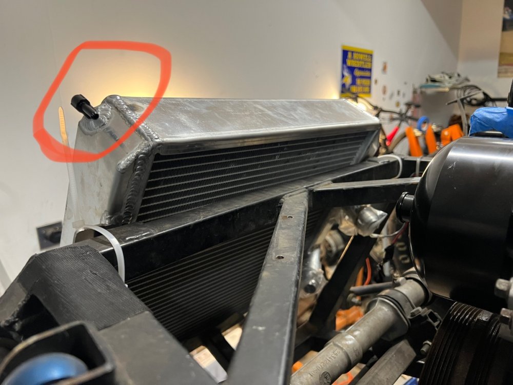

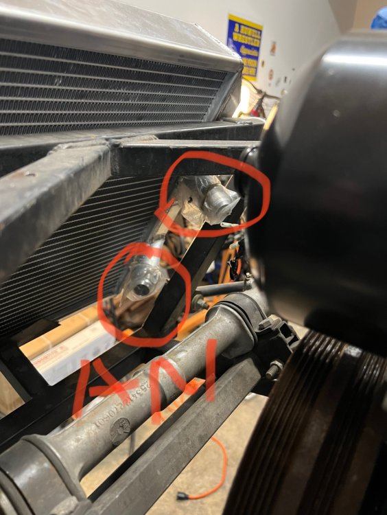

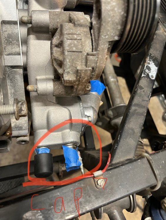

  18. The Radiator I purchased from Scott Minehart. I believe is made by Mark Scott but not sure. You definitely want one that is similar in size AND make sure you have it exactly in the middle of the car as a half inch one way or the other WILL make your hood hit one side. I made that mistake and had to fix it just last week before my first track day. If you are going to buy/make your own let me know and I will go measure the dimensions tomorrow but not that the corners are all angled and you Absolutely need that for it to fit. As to Fan I bought this one off Amazon. I saw one of the Amazon reviews was from a Minehart that was looking to cool his LS1 engine so I figured I had the right one Maradyne M142k Champion Series Radiator Fan. You will need to flip the fan blades over to make is a 'pusher fan' before install but that is easy and part of the install instructions that come with it. https://www.amazon.com/dp/B002Q3895M?psc=1&ref=ppx_yo2ov_dt_b_product_details
