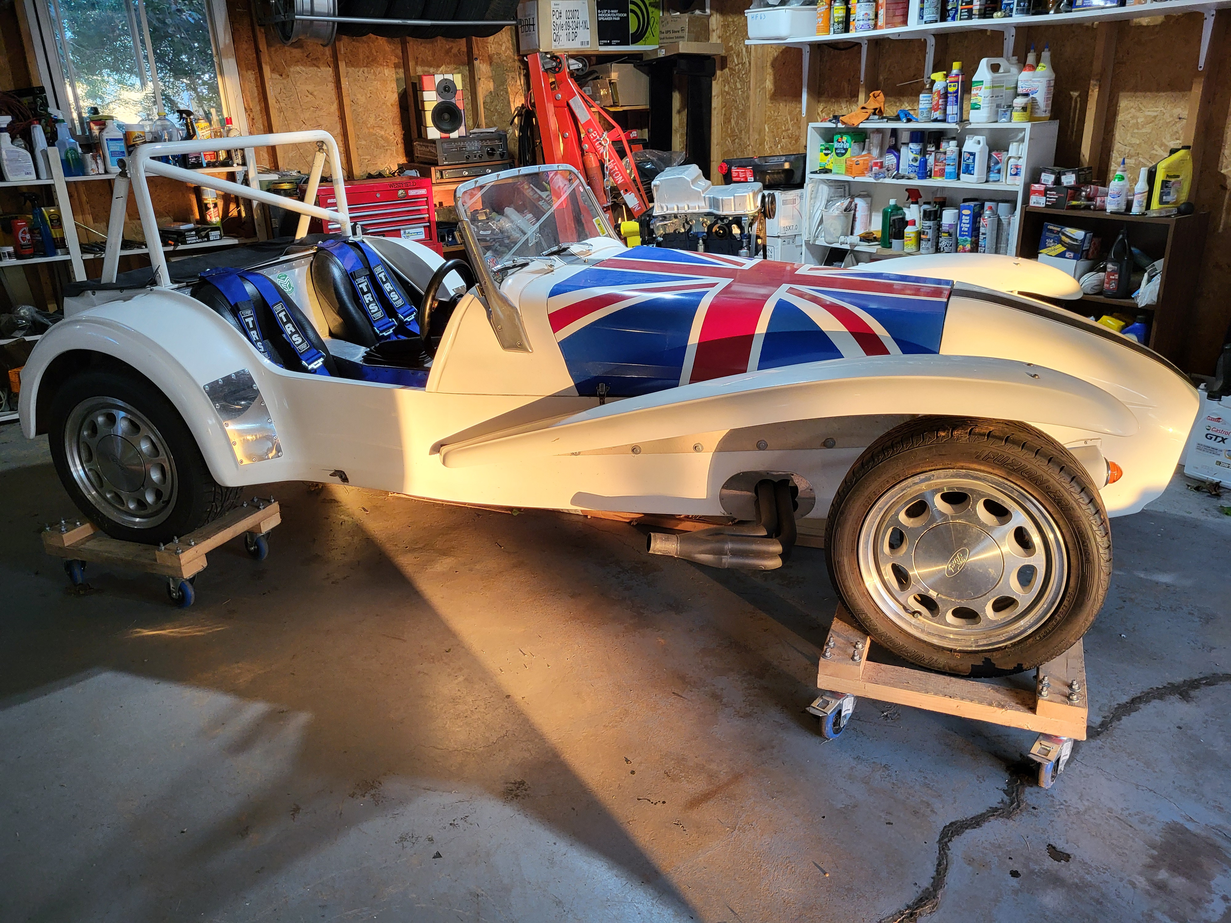

  2. Well, I finally got around to pulling the engine yesterday. It went really well. 3-1/2 hours from start to finish for the two of us with a third helper on the hoist. I could probably do it faster now that I've done it once. It helps greatly with angling the engine out to have the rear of the car higher than the front. The clutch problem was obvious once I had separated the tranny. The friction material on the flywheel side of the clutch had sheared almost completely off the clutch disc. I'll be looking into some other clutch options from Burton. The bad news is that it looks like #1 cyl is using oil. This didn't really show up when reading the plugs, but I can see in the #1 exhaust port that there are lots of oil deposits there. I suspect a broken ring or two. I'll have to pull the head and have a look inside. Cheers Phil

  7. It's finally time to change the clutch in my Westie. I launched it a little too hard at an autocross last summer and the clutch no longer releases fully. I'm wondering if it's easiest to just drop the tranny, or to pull the engine and tranny as an assembly like my MGB? I'm doing this on the floor of my tiny garage without a lift, but I do have an engine hoist. The powertrain is a SOHC Ford (Pinto) and T9. I'm hoping to take advantage of a warm spell this weekend when it's not minus a jillion degrees in the garage. Any and all input is appreciated. Cheers Phil

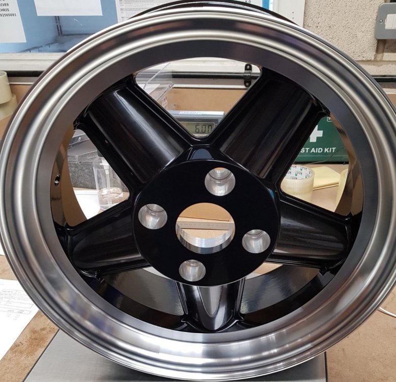

  9. My Westfield uses Ford hubs so it's 4 on 108mm. It's currently sitting on Fox Body Mustang 10 hole aluminum wheels with 18 yr old street tires. I put the race tires on the 5 spoke Penta wheels it came with. Revolution can custom drill blank wheels for most bolt patterns. My set of 15x7s came to about $1300 Cdn. including lug nuts. caps, and shipping. Cheers Phil

  12. I'm all excited. I just ordered a set of these Revolutions in 15x7. They should be here in 3 or 4 weeks. Cheers Phil
