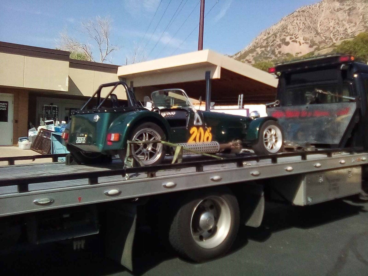

  1. I was driving the car quite a bit during the summer, even daily driving it for a couple weeks when our old Jeep Cherokee had a catastrophic water pump failure. It was fun parking it up next to the typical monster trucks people around here usually drive. But, the summer did not end without any problems. I was out at a local university for work when I went to start the car and drive back to the office, but the car did something like "chugga, chugga, clunk," and then I had no starter. I tried bump starting it and jump starting it, but neither worked. Hot, flustered, and a bit embarrassed as most of my coworkers were there, I decided to utilize roadside assistance and get the car home where I could diagnose the problem without pressure. I let the car sit for about a month as life with a young family keeps me busy, but finally had the chance to try and diagnose the problem. The symptoms were no starter and no fuel pump, which prompted me to look at all the fuses. Checked every one of them and all was good, but when I happened to turn the headlight switch on with the ignition on, I heard a buzzing coming from the fuse box. The culprit? The ignition relay. The parts store didn't have a comparable replacement, but I could hijack the relay for the heated windscreen, swapped it over, and boom, everything working and engine started right up. I'm so glad it was an easy fix, and happy that it was also fairly painless to diagnose. Could have done it in the parking lot at the university, but alas, you live and you learn. I'm looking forward to a bunch of drives before they salt the roads here and enjoying the nice fall weather.

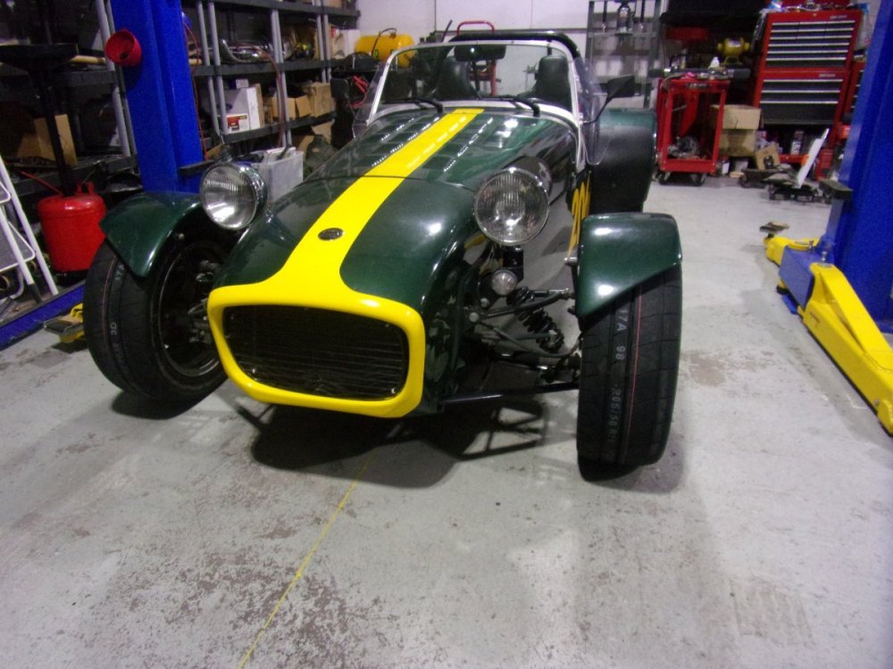

  6. Overdue for an update. Spent a bunch of time working on the cooling system, which you can read about in this thread. Long story short, the car runs a little hotter than I would like, but the cooling system seems to be operating correctly. Once that was sorted, it was time to get the suspension dialed in and some new tires (finally!). A friend of mine offered to help me do a string alignment at his shop and mount my new tires, so I loaded up to drive a couple of counties over to where he lives. I saw at least one person taking a video of me driving down the interstate like this We were able to fairly easily get the specs I wanted. End result! Decided to go with -2.0 degrees of camber in the front, -1.6 degrees in the rear, and zero toe all around. As mentioned in an earlier post, the intention with these specs is to try and dial out the understeer. Initial drives show little change on turn-in characteristics, but the front end has more grip once the suspension is loaded in a corner. I'll need to take it to an autocross to really tell, and I'm excited about the new tires as well. I went with Kumho V730s, 205/50r15 front and rear. I love the nearly semi-slick look, and I think they will be much better than the Bridgestones from 2018.

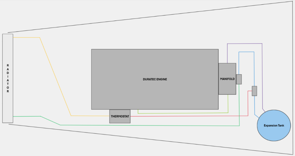

  8. Due for an update. I finally got around to working on this problem. Here's what happened: Removed and tested the new thermostat along with the old thermostat in a pot of boiling water. Both thermostats were functional. Re-routed the system to eliminate the heater core, capping the bypass on the thermostat housing. Removed the heater and covered the holes. Removed the thermostat out of the old housing and reinstalled to allow full flow. Flushed the system with water two times. Reinstalled the new thermostat/housing and burped the system. The result? Mixed and dissatisfied. Everything seems to be working, but this thermostat keeps the system between 210-215 °F, which is hotter than I like. Stayed in that range on both the drive to work (47 °F ambient) and the drive home (68 °F ambient). I'm not confident it'll stay that way when it's 90+ in the summer, or during track/autocross. Positives: the car warms up faster and warms up regardless of the car being stationary or in motion, and removing the heater has reduced footwell temperatures, which will be very nice in the summer. I'm considering trying another standard replacement thermostat from the local parts store, or even trying a lower temp thermostat like this one.

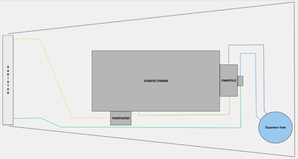

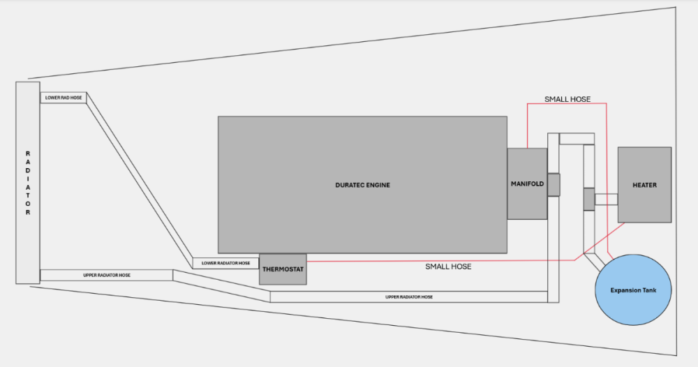

  10. Pinching the thermostat → heater hose is easy enough. I'll give it a try. I believe the indicating temp sensor is coming off the connector between hoses 2 & 4 per your diagram. There is another sensor directly in the manifold. I plan on testing the thermostat. I appreciate everyone's feedback. I'm going to try MV8's suggestion to pinch the one hose to the heater first just for another data point, but after that the plan is to: Tear into the system again and remove the thermostat and heater Test the thermostat and depending on results install it again, install a new one, or install a modified housing that allows constant flow Properly flush the system instead of just drain and fill I remade my diagram to hopefully make it easier to read. First picture is the current system, second picture is how I plan to bypass the heater.
  11. Looks like I'm going to be re-plumbing the system because I'm left scratching my head about this cooling system. I did not get the thermostat to open at all while the engine was running today. I started off running the engine with the expansion tank off, rear of the car raised. I saw a bunch of bubbles in the expansion tank, but the thermostat did not open at 180 F. The radiator fan kicked on at 190 again, and I confirmed it is spinning correctly drawing air through the radiator. The lower coolant hose was cold when I shut the engine off at 210 F, at which point coolant started bubbling up out of the expansion tank. I put the cap back on, and found that some hot coolant flowed through the lower radiator hose. What? Started the engine after a few minutes, 190 F, rear still raised and expansion tank cap on. Lower radiator hose cooled off with airflow from the radiator fan, and stayed cool when I shut the engine off at 210 F. I started to relieve pressure from the expansion tank cap, with my hand on the lower radiator hose, and as I was relieving pressure I could feel hot coolant flowing through the lower hose. I don't understand what is going on... is the thermostat opening only when I relieve pressure in the system? Left the car for a few hours and tried one more time. Expansion tank cap on, car flat on the ground, the thermostat still did not open. I opened up the expansion tank while the engine was running at 200 F, no flow through the lower radiator hose, but I did notice some more bubbles, so I raised the rear of the car and let it burp for a few minutes. Put the expansion tank cap back on, shut off the engine, and no flow through the lower radiator hose. Relieved the pressure in the tank and felt the coolant flow again. So my thoughts are that I've got a faulty thermostat, or this system is very difficult to burp/bleed and is really causing flow issues, or some other problem yet to be diagnosed. I did, however, find that there is another bypass that I had missed that runs from the engine block just behind the thermostat housing to the manifold on the back of the engine. Everything on the right side of the diagram I posted gets properly hot, the upper radiator hose gets fairly warm, and the radiator and lower hose remain cold.

  13. It also looks like the Zetecs have a different location for the thermostat, at the back of the engine instead of next to the water pump.
  14. The thermostat housing is on the front left side of the engine, and the small hose from that runs to the heater. The small line from the expansion tank runs to the manifold on the back of the engine. I made a new drawing with a different program that should make it more clear. Looking at the other drawings, it appears that expansion tanks typically have a third hose for a breather. I only saw two lines coming from the tank, so I'll need to take a closer look tonight.
  15. That's the thermostat. My system looks fairly similar to the Duratec diagram, but the bypass from the thermostat goes directly to the heater core, and the expansion tank is in a different location.
