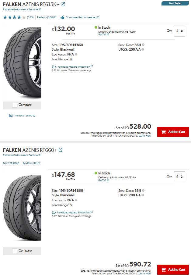

I suggest going with the R888Rs if you want to maintain a grippy tire in the same size. Another option is moving up to 195 width tires which opens up a couple of Falken tires that would both be adequate replacements for your Star Specs.
