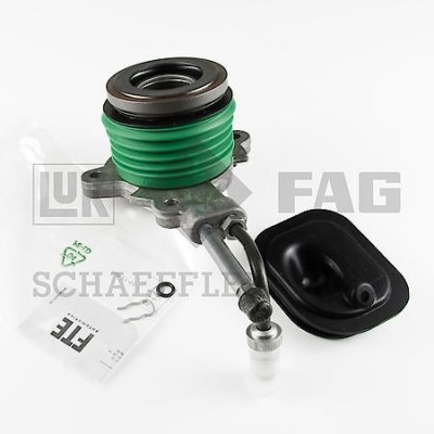

That said, I'm now planning to make my own 30mm thick Caterham style adapter plate, along the lines of Milton's piece, but with an integral mount for the Ford Focus, Contour, Mystique annular throwout bearing assy.
The adapter will sandwich between the bellhousing and the transmission to accommodate the longer input shaft as well as provide mounting pattern for the Focus throwout bearing / slave cylinder assy.
