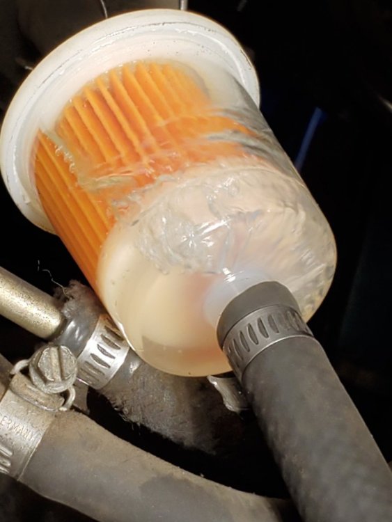

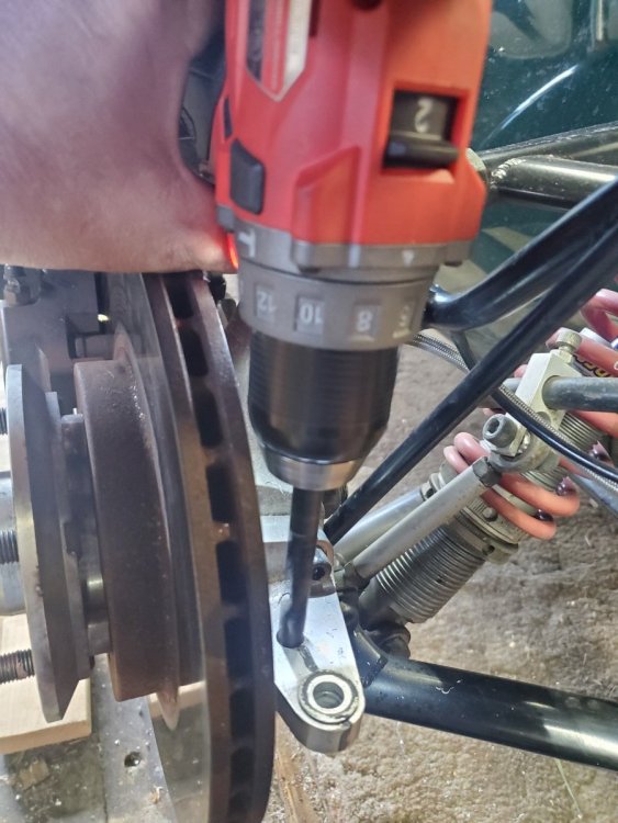

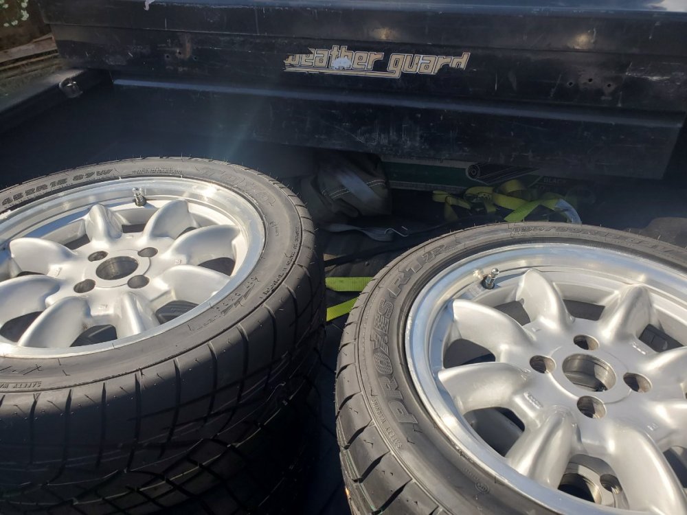

DemoDan Posted May 29, 2021 Author Posted May 29, 2021 Less than a week to go for the State Patrol VIN inspection and I've been getting more familiar with Eggsy. The Autocross was a great way to learn to drive and shake-down the rust from all those years of storage. I've entered into another event in Bremerton on Monday and have been making Eggsy more reliable and race-ready. It was nice to see Al from Chelan in another Birkin and I'm copying a couple things I saw on his car. First was to remove the spare tire for several lbs savings then I drilled new holes in the steering arm to quicken it up, new fuel filter to hopefully help a left-turn starvation feel and replaced the 15 year-old Avon tires with a new set from Toyo.

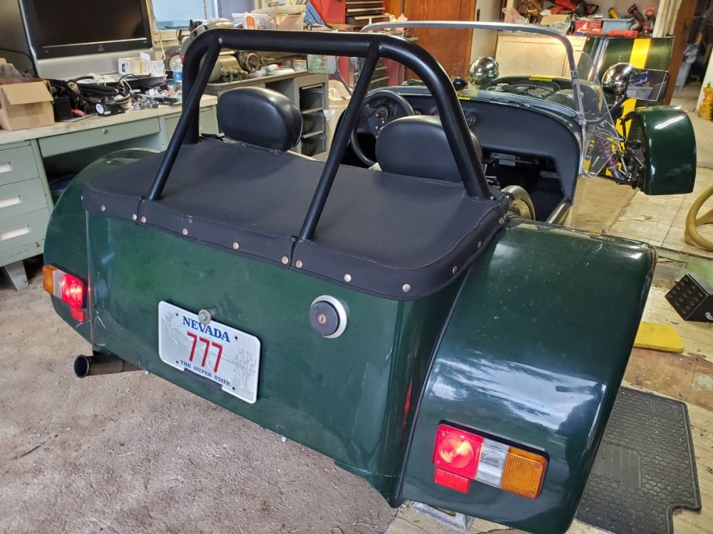

DemoDan Posted June 7, 2021 Author Posted June 7, 2021 Getting a State Patrol appointment for VIN inspection is a real nuisance with the Covid delays these days but finally got it done. They have deemed Eggsy to be Yr Make: 2003 KitV, Model: 1964 Lotus. Weird that they took off the Birkin make and I think it looks more like a 67 but I'm not complaining...not a word about bumpers or high-mounted brake lights. Thankful that the hoops weren't as bad as many that I read about here. Happy to have it all legally transferred and registered.
