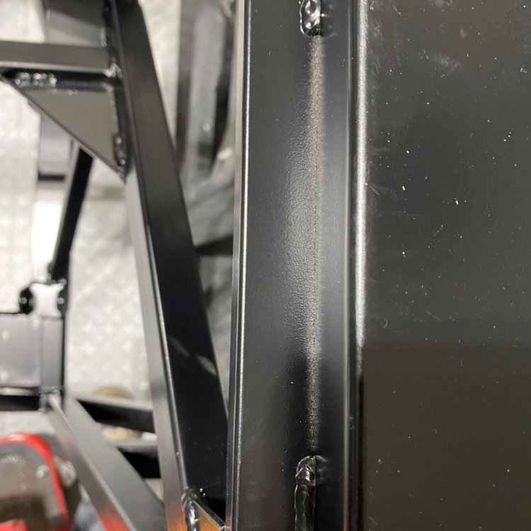

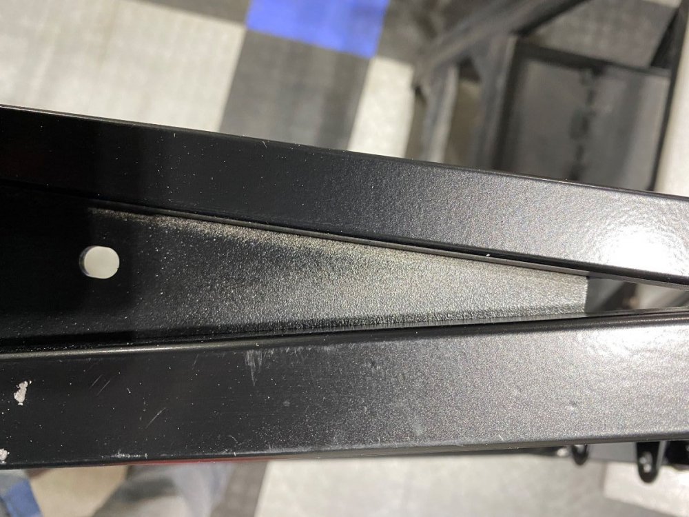

DanM Posted February 10, 2022 Posted February 10, 2022 Hey everyone, I plan to use POR-15 to touch up the areas on my chassis where the powder coating has only partially covered. As part of the prep process, are people removing the powder coat completely from the touch up area before doing the 3 stage POR process or are you leaving the powder coat in situ i.e. prepping and painting over it? Thanks in advance.

DanM Posted February 14, 2022 Author Posted February 14, 2022 Hi @IamScotticus. I reached out to POR-15 directly with my question and here is their response. Hope you find it useful! My Question: "I have a powder coated chassis and there are areas where the powder coat layer is not very thick. Can I paint POR-15 Rust Preventative Coating over the powder coat? If so, what prep do I need to do?" Their Response: "Yes, you will have to lightly sand or scuff the area then use our Cleaner Degreaser before applying the POR-15."
IamScotticus Posted February 14, 2022 Posted February 14, 2022 Thanks. I wanted to add that the edges of the PC would need to be sanded down to a fine edge. If the whole PC area is spotty, then just remove it. PC, if applied well, should have an airtight bond with the surface but a rough edge can compromise that. So many reasons why I think PC is overrated for chassis coating. The only benefit is the production side. PC produces an acceptable coating with less prep, labor and time. In volume, cost. But the end consumer doesn't always get the better deal. Having said all that, yes PC can be done well if prep and application are done to a high standard with a zinc base layer, etc. But the cost benefit is gone.
