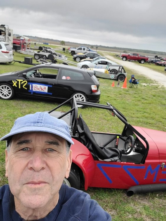

Panamericano and USA 7's brethren, I am VERY happy to report that after Glen Minehart and I fixed the leaking rear end passenger half shaft leak, I successfully ran 6 runs at an autocross at Florida International Rally and Motorsports Park (F.I.R.M.) yesterday and the Stalker AXR performed spectacularly. No leaks and after the first run, my times kept decreasing my 2-3 seconds each run, such that I ended up placing 47th (raw time) out of 120 participants. Until the AXR that Glen and Scott Minehart helped me build, the 2014 Caterham 300r with 400r specs was the most wired into my brain car that I had ever owned/driven. Well, with Avon A11 compound slicks (10" and 13" wide respectively) on the Stalker AXR that weighs a 1625 pounds wet, the car behaved like a Hoover vacuum cleaner on the track and steering through slaloms and especially even the tight ones was a breeze. With the electric power assist steering, superb Coleman racing ratio steering rack and the Stalker AXR suspension, the car was the most wired into my brain that I have ever driven. I hope the weather back at the F.I.R.M. is as good as it was yesterday for an upcoming event next weekend. Hopefully, I will better understand the throttle, brakes, steering and suspension as I go out an try to perform even better at this next event. It was a long journey to yesterday, but I feel sort of exonerated that I took on what for me was a pretty complex task of completing a Stalker kit and came out at the end having a ball with the final product.

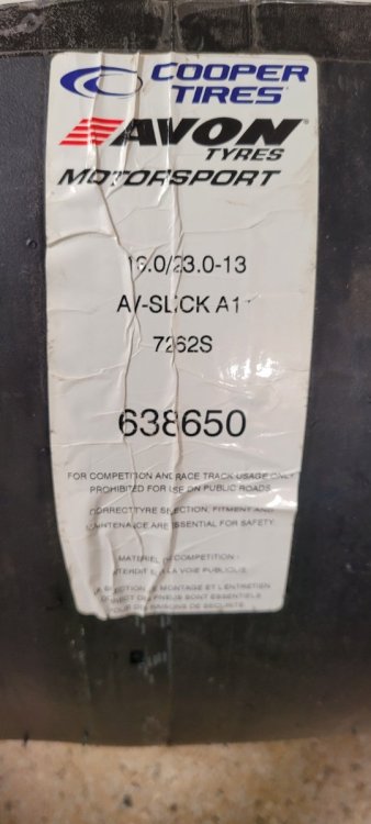

I am cranking up the wattage on my ebike to a 1 gigawatt motor and decided I needed better tires for traction. Just need to figure out how to mount them on the spoked wheels? The rumor that Goodyear was buying Cooper Tires and reportedly shuttering Avon is told in the sticker that came on my Avons. There are also rumors that someone else may buy the Avon brand from Goodyear and continue to produce race tires. Supposedly, Goodyear has notified Avon Tyres in the UK that they will be discontinuing production at the end of this year. I hope this is not the case because I really like they way they work on my Stalker AXR.

Yes production is ceasing for Avon UK tires.  However, much of the Avon range is also produced in Serbia plus another Eastern European country (I think it was Romania or Bulgaria?).  There are vague rumors that the UK production equipment will be relocated to the USA to kick off production here.  I am not expecting the tires we use will be discontinued or cease to become available.  There may be a short term supply issue while they sort themselves out.
