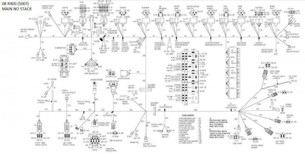

Scott Mc Posted July 2, 2022 Share Posted July 2, 2022 Hello- I am new to the forum. Would someone be able to please point me to where I might locate a wiring diagram for a 2008 Superlight R500D? Any help would be appreciated. Thanks. Scott Link to comment Share on other sites More sharing options...
JohnCh Posted July 2, 2022 Share Posted July 2, 2022 Not exactly what you are looking for but the back of this assembly guide from 2015 has wiring diagrams for the 420 with either the standard or Stack dash. Depending on what you are trying to ascertain, it might help. -John Link to comment Share on other sites More sharing options...

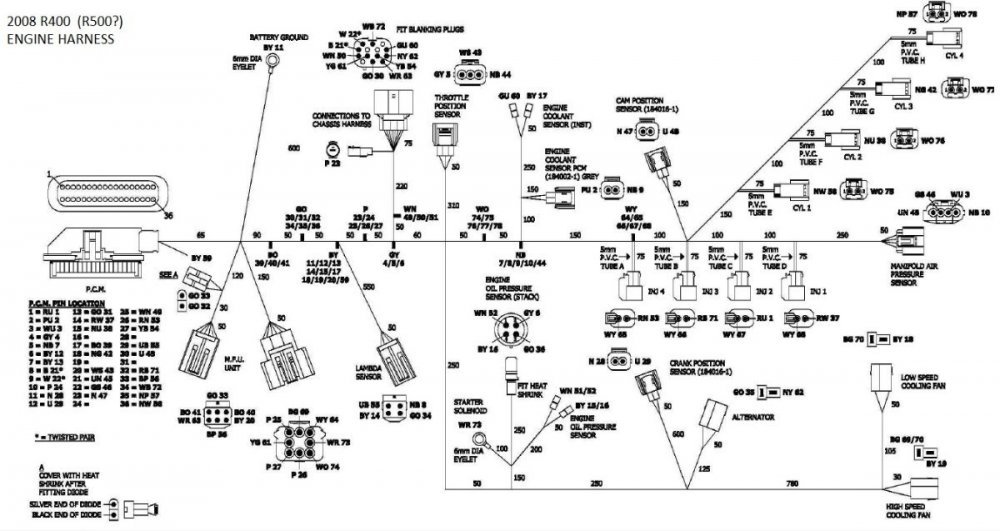

MV8 Posted July 3, 2022 Share Posted July 3, 2022 I think the schematics are the same for the '08 R400 and R500; both duratec powered. Here ar e the '08 R400 schems. Link to comment Share on other sites More sharing options...
