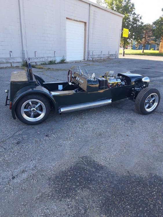

Alex-Ks1 Posted August 16, 2022 Posted August 16, 2022 I finally got my car done , had to do a lot of tweeking on some things , the throttle is a bit sticky . Maybe a stronger spring . But when I backed it out of my shop ,it had balls , lots of big shiny balls , so down the road I went. Very slow at first , just off idle Then pushed it a little harder , this car is scary fast , the rear end tried to meet the front end . Letting of the gas ,, then a bit more even push on the gas peddle and it was off like a scalded cat , again it's scary fast . Who wants to live forever So I turned into rout 50 and hit it , the GPS speedO said I was doing 125 and I'm still in third gear ,going into 4th . Damn fast Much faster than I expected . Again scary fast , I'll drive it a while and put it up for sale .The whole project was to see if I could do it and I did .I'm not here to impress any one , some will say this isn't true to form , or that's not right .I can care less what people say or think 1
Alex-Ks1 Posted August 17, 2022 Author Posted August 17, 2022 Took it out again and did city driving ,I could only use 1st gear , it's just to damn fast in any other up gearing , so around town I went . Stopped to fill the gas tank and had everyone asking this and that , and a few asked. HOW MUCH TO SELL IT lolol one day out and it's about to get sold , probley not , I'll keep it a while , After I gassed up and started it , with no mufflers at all , flames shot out of the pipes Two feet from the gas pump , have to think about refilling it ,, 1

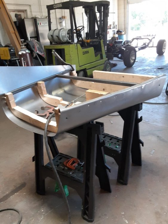

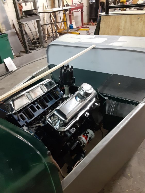

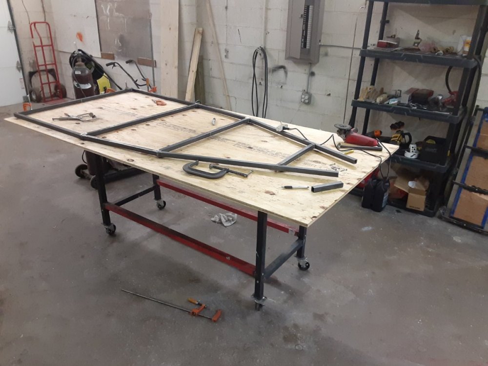

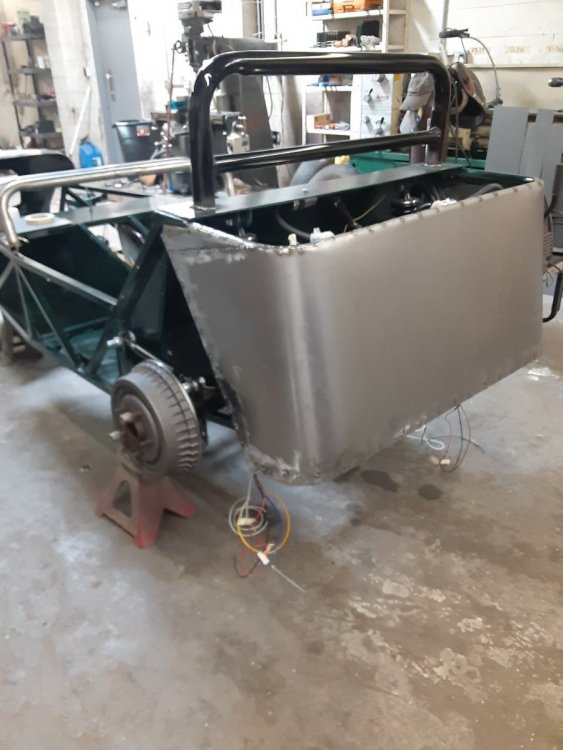

Alex-Ks1 Posted August 17, 2022 Author Posted August 17, 2022 More photos the one showing the hood upside down has a frame work in place and the wood is the matching upper contour of the sheet metal when it's rolled and welded in place . Must have had that on and off 20 times to get it right , then 1/2 inch square tubing is welded to the sheet metal then the long Steele lower hood braces , this makes it very rigid , think I gonna hold it down with leather belts and buckles . 1
Alex-Ks1 Posted August 17, 2022 Author Posted August 17, 2022 There is a formula for this engine with big cam performance valve job, a sort of header . I did all the engine rebuild , it was blue printed to very tight specks It's estimated at 265 HP rebuilt the T 5 trans and rear end it has a 3.08 gear . I through more Chinese crap in the trash that actually went on it , so much was just no good ,

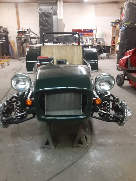

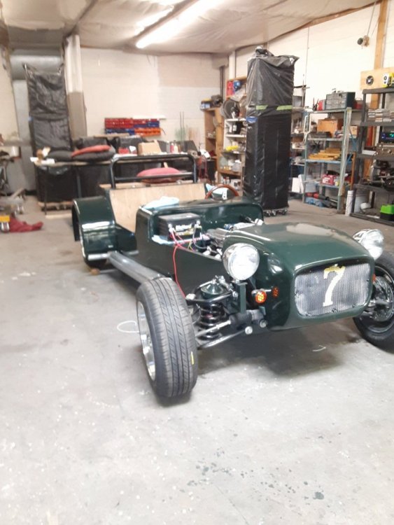

Alex-Ks1 Posted August 17, 2022 Author Posted August 17, 2022 This is how it looks now driving on the street , still working on the hood . carb is off for more closer re fitting 1
