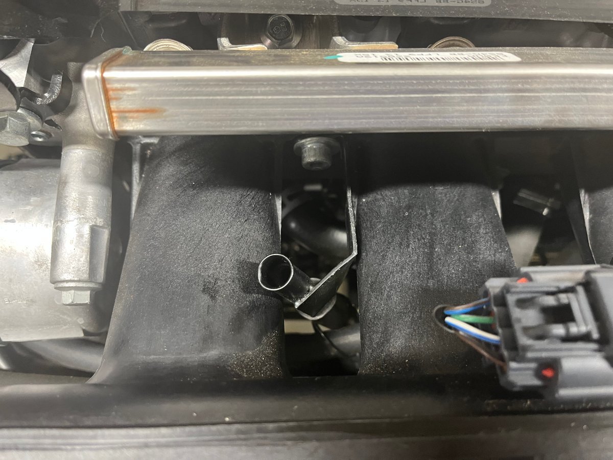

One detail that kept nagging me ever since the build was the clearance between the steering shaft and the dipstick hose.  It had been from the start about 1/4" which I thought was too small.  As part of my 1,000 mile "self service" I decided to look for ways to increase it.  I ended up bending and twisting the end of the bracket holding the top of the dipstick hose (it is held by one of the plenum bolts), so that it bends the hose away from the shaft.  I used padded vise-grips.  The gap is now about 1" and I can finally sleep again.
