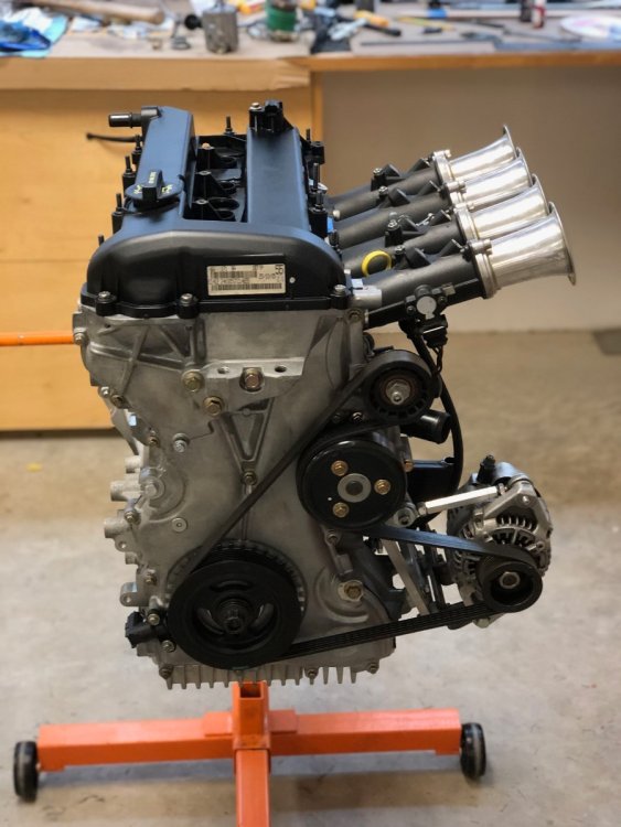

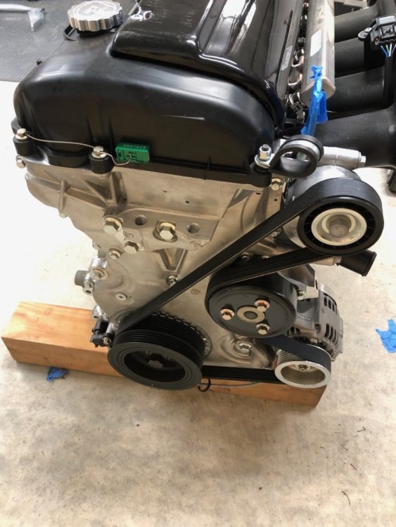

Edited by ashyers
added photo of belt arrangement
If anyone is curious, the pic is of a fwd cover with a dry sump showing aftermarket drive components.

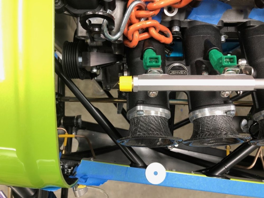

I've run the Raceline tensioner on my 2.0L Duratecs since '04.  Picture below shows that setup on the most recent engine.  Although the belt gets very close to itself, it has never been an issue.

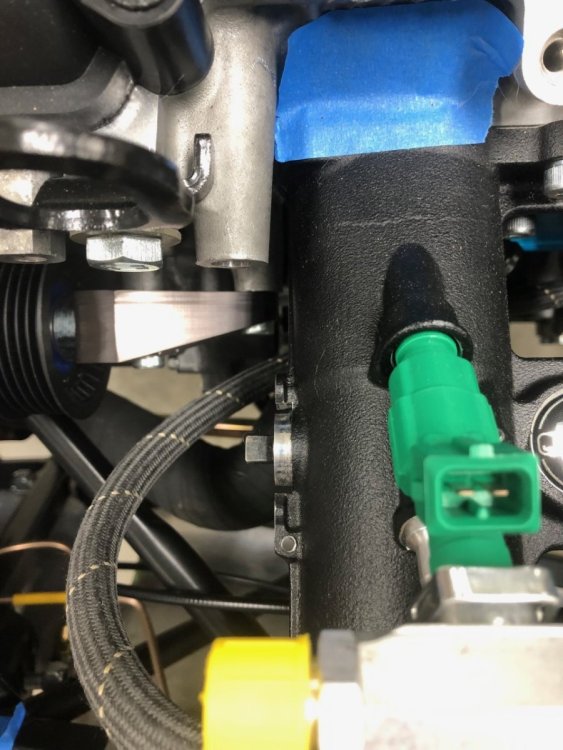

For the Caterham with the 2.4L I had planned to do the same but discovered that clearance between the pulley and one of the chassis tubes is really, really tight.  They didn't touch but until the engine was in its final position with the trans on and mounted to the chassis, it didnt inspire a lot of confidence.  I don't have a great picture to show the gap, but these two will give you an idea.  The fix, if needed, is very simple: just a flat metal plate that bolts to the stock block locations and is drilled to mount the tensioner ~3/4" higher.

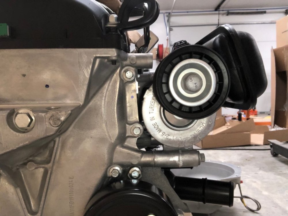

I considered using the Ford self-tensioner as fitted to stock Caterhams but discovered it won't fit with Jenveys.  It's a large, bulky part and attempts to occupy the same space as the left-side throttle shaft.  The first photo shows it in place on the 420 engine.  If you look closely, you can see it uses the two top mounting bosses, whereas the Raceline only uses the lower bosses.
Couple of other points.  First, the 2.3L block is 13mm taller than the 2.0L.  I suspect that when the tensioner wheel is lowered by that amount relative to the chassis, the clearance reduces further so although it isn't a consideration for you, I/m mentioning it for anyone else reading this who has a 2.0L.  Second, Raceline uses a different bellhousing than Caterham which shifts the engine back in the chassis about 20mm.  This renders the potential interference with their tensioner moot as it would now sit well back of that chassis tube.

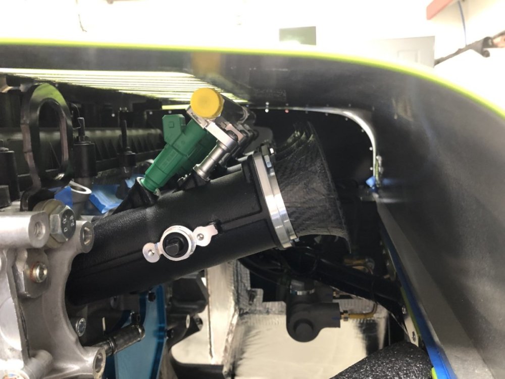

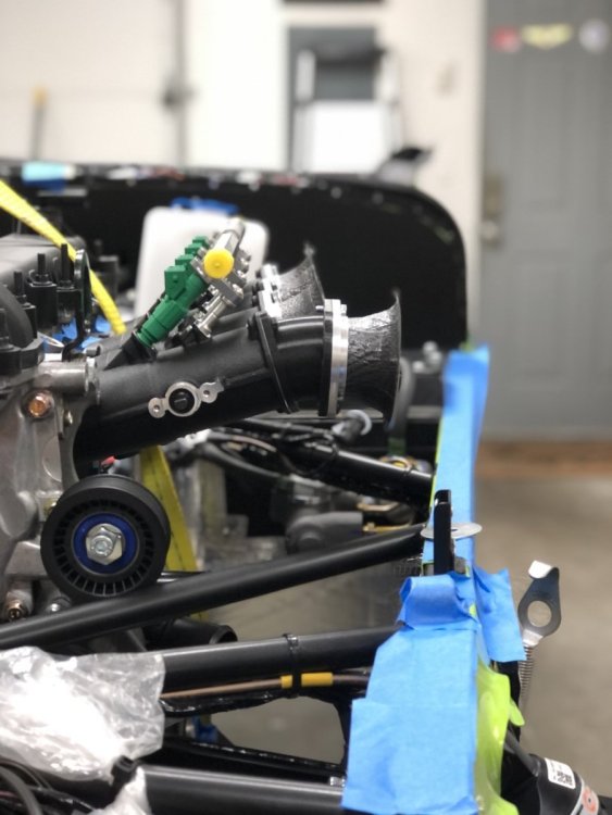

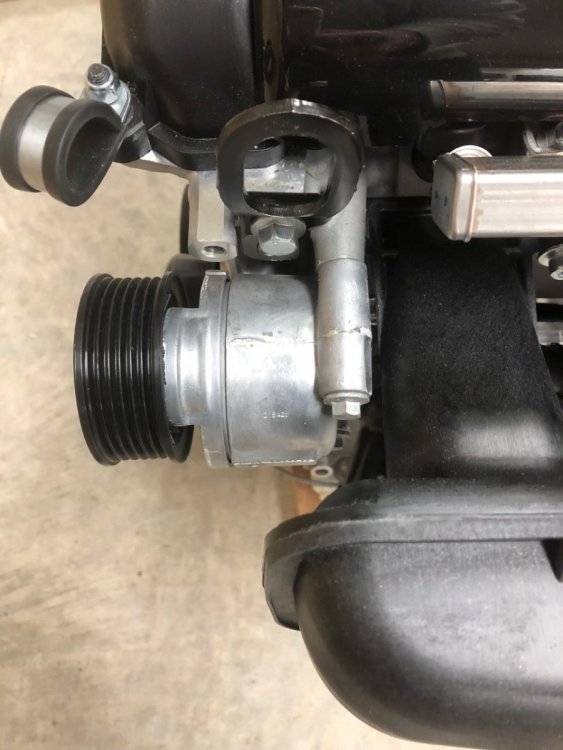

The part number used on the 420 engine is 3M5Q-6A228-AE.  Here are a few more photos to help you visualize the interference with the current Jenveys which might help answer your question about your SBD TBs.
Front view of tensioner.  Similar to yours but there is no forward-facing bolt.
Top view of the tensioner.  Note where the top mounting bolt is in relation to the 420 intake runners
This picture shows that same bolt boss in relation to the edge of the Jenveys and the throttle shaft.

Thank you for all the photos. It looks like the throttle shaft is in approximately the same position on my car, so the Ford tensioner won't fit without some hacking and whacking. Raceline or fabricating a new one looks like the best option at the moment.
For future reference the Gates P/N is 38318.

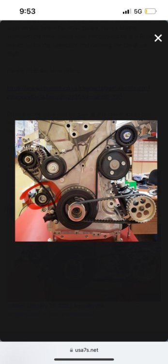

Quick question, where did u get this kit from? I’ve been looking for one but can’t seem to find it.
