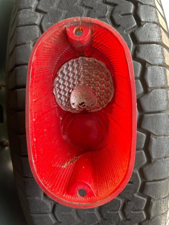

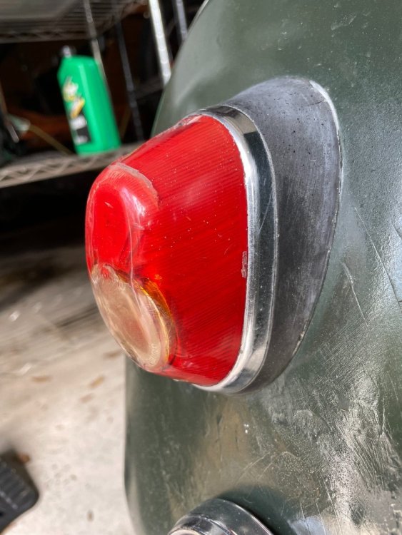

Taillight for S2?
Looks like the wingard 1055 to me. It looks like a sprite L549 lamp assembly could be fitted to a seven with a custom fender mount (the black part). I don't think the sprite lens will fit on the wingard base though.

It just occurred to me that Lotus may have used the sprite base but mounted it to the fender more vertically, requiring a new (wingard) lens and maybe a tweak to the reflector angle inside, so the sprite lens may fit the base but be pointing down toward the rear.

I've seen Spitfire lenses and bases used on some 7s, road and race cars where the owner doesn't want to risk damage to orgs. While not org they don't look bad if you can't find Wingards.

Regarding Wingard 1055's - they were aftermarket lights for what the English call 'caravans' -- like if you went into your local auto parts and bought a set of lights for your trailer. Yes they are a little Similar to the Lucas units that are readily available, but (to me anyway) the mark of a proper restoration is to use the proper lights. I've seen so many pricey, meticulous restorations that end up with those Lucas lamps... it's how you tell if an owner or seller really cares - they'll say 'oh, those are impossible to find' but you and I know different don't we :-)
