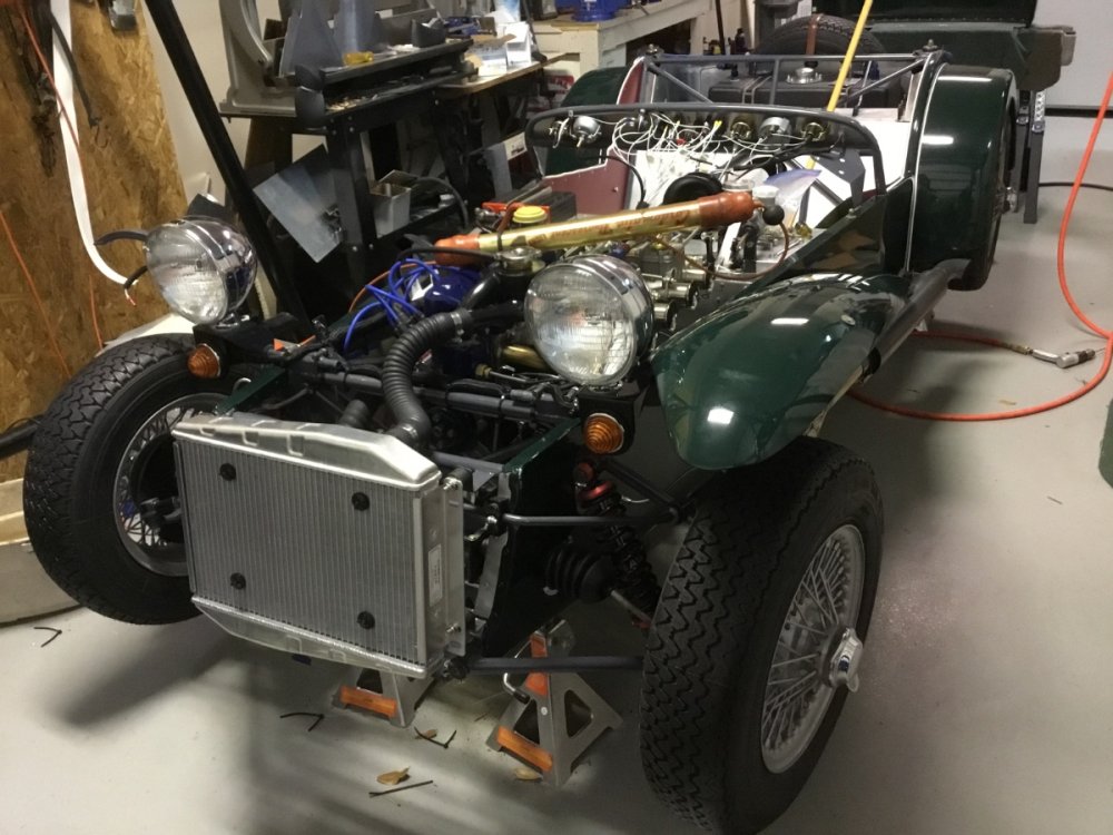

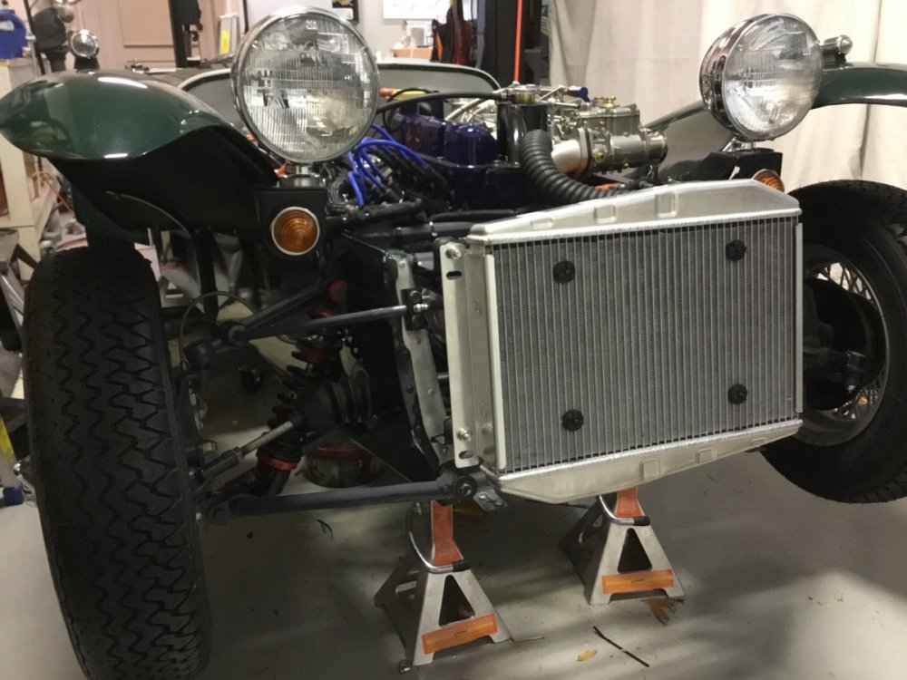

Stevensonjr Posted October 5, 2023 Posted October 5, 2023 I called Caterham, told them I needed a series 2 radiator, they sent one (aluminum) I slightly modified the lower tube to clear the forward frame tube, moved it forward leaned it back against new frame mounts and it clears the nose by at least 1/2” all around. Then put a 10” pancake electric fan on it, pulling from the inside. Runs at 80C, 85C on a 100F day 1

jbcollier Posted October 5, 2023 Posted October 5, 2023 What was the Caterham part number/application? Obviously you welded on new brackets for mounting it. Did you have to cut off the original fan brackets? Thanks
MV8 Posted October 5, 2023 Posted October 5, 2023 That looks like the "Sigma and Duratec" listing for $408 inc. vat. The "Rover K" and "crossflow" versions should be interchangeable on the same mounts but have sensor ports and fan brackets.
Stevensonjr Posted October 12, 2023 Posted October 12, 2023 Just saw the radiator questions, will look in my files to find the numbers. I made the mounts and had them welded on prior to powder coating. You can see them pretty well in the photos, all 4 are simple L shaped brackets to accommodate the rubber mounts furnished with the radiator. The dimensions of the 4 mounts is determined by the interior shape of your nose skin. I made mounts and duct taped them to the frame with the radiator attached. Then you try fit the nose and change mount lengths as necessary, then weld them up. I have about 1/2” clearance on all four corners of the radiator. I cut the original fan mounts off. I’ll look up the radiator numbers tonight.

MV8 Posted October 13, 2023 Posted October 13, 2023 Based on the label, it looks like PN 73316 which is the "Ford Crossflow" listing and identical with the exception of no fan mount welded on: https://caterhamparts.co.uk/radiators/2653-radiator-aluminium-for-ford-crossflow-engine.html If your going to weld on mounts and use universal hoses, a racing civic rad popular with locosts would probably fit and cost about $120 for a three row unit. I have one sitting here for something else (not a civic) but not installed yet if you'd like pics and dimensions.
