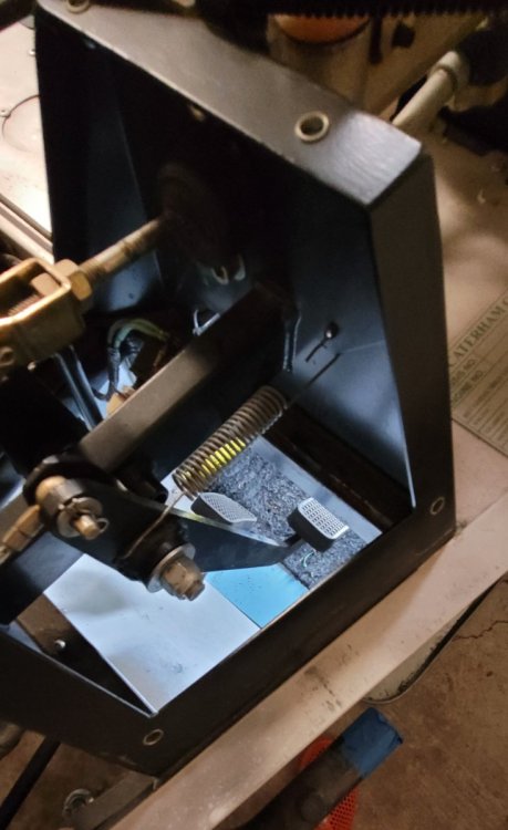

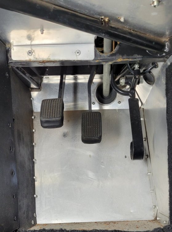

Wayne Stambaugh Posted January 8, 2024 Author Posted January 8, 2024 Working on the installation of the Tilton 6100 HRB to replace the cable operated clutch. Obviously machining is required but nothing extraordinary. I have adjusted the brake pedal to get it lower in the foot box but I’m still having problems getting my left foot on top of the clutch pedal. My left knee hits the lower edge of the dash. This is with the steering wheel removed! It appears I’m going to have to lower the floor and at this point I’m not even sure that this will give me the clearance I need. I am 6’ tall and currently 185 pounds. Is there anyone in the south east who is driving an S3 chassis with a lowered floor. I would like to sit in a car with a lowered floor just to be sure this is going to be the solution to the problem. I would be happy to drive up to 3 or 4 hours to check it out. Thanks in advance. If I can’t get comfortable in the S3 I will have to consider moving on to an SV chassis. No matter how much I like this car and the history behind this particular one, if I can’t drive it I can’t keep it. 1

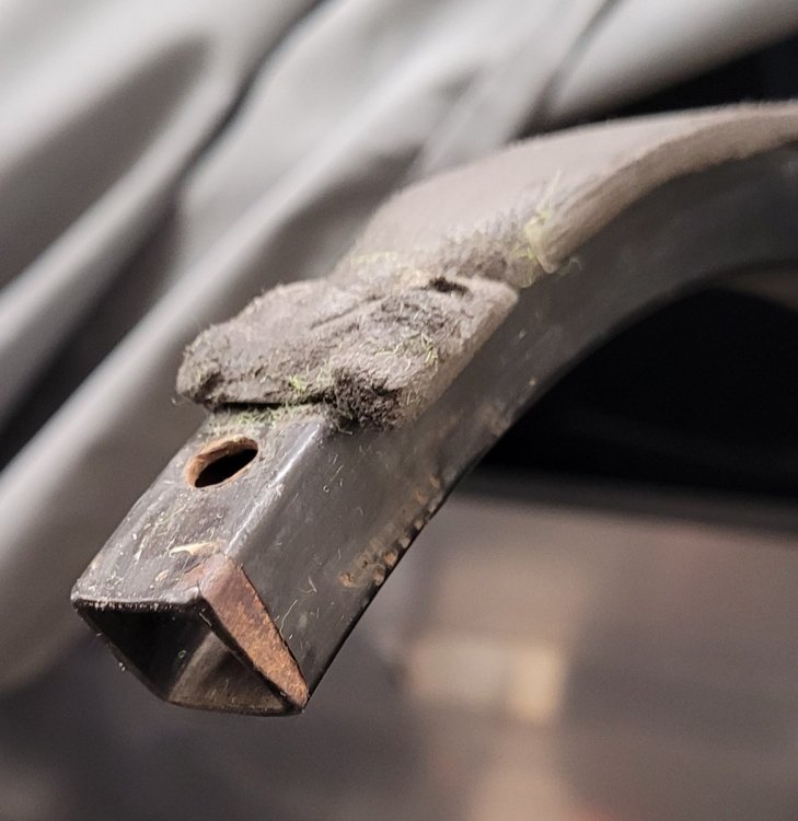

bball7754 Posted January 9, 2024 Posted January 9, 2024 You’ve probably already figured this out, but I believe the front wing stay is attached using the indicator. It is on my 1998, and you seem to have the same indicator.

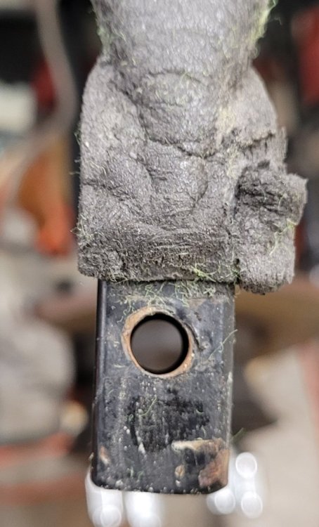

Wayne Stambaugh Posted January 17, 2024 Author Posted January 17, 2024 Sometimes I think every one of these cars are different. I know that can’t be true but considering the cars have been built since 1957 I’m sure there have been lots of changes over the years. I have included a picture of my bracket and you can see, it has no tab on it where a hole would go. I think in the end we will all be experts on our own cars but I’m afraid only small percentage of our knowledge will be transferable to other Sevens but that is okay, I’ve never been an expert on much of anything anyway. Thanks for your pictures. The more we see the more educated we get the better off we are.
IamScotticus Posted January 17, 2024 Posted January 17, 2024 (edited) This wing stay has been caped on the end and painted. Put a magnet on that end cap.. is it plastic? probably. Whoever did the paint probably filled and sealed the holes, if the holes were there. And it was black. Bball"s 98 wing stay is tubular so it has a flat tab welded on. the BDR is square, like mine. It is drilled for a bolt. Standard 7 equipment up to the 90s. Edited January 17, 2024 by IamScotticus
Wayne Stambaugh Posted January 18, 2024 Author Posted January 18, 2024 No evidence that mine were ever drilled. They certainly were not drilled at the factory and filled later. The little end plug looks like plastic at least that was my impression when it looked at it. Really I don’t care what it’s made from or even that they are there. It’s not something you ever see when the car is assembled. It appears it was up to the assembler to drill the bolt hole through the wing and bracket and bolt the two together. I think I mentioned too, that the wings are the original parts and they are in the original BRG gell coated fiberglass, there are no holes in the wings for the bolts either and no repairs of holes where they were filled. I’m so lucky that my car is so original. It is probably one of the most original cars out there. If there is a more original car, it is still in a crate somewhere, yet to be opened and assembled.

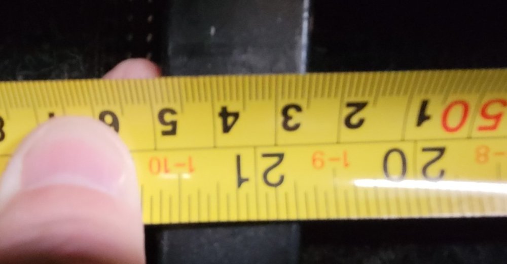

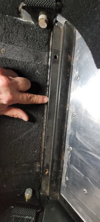

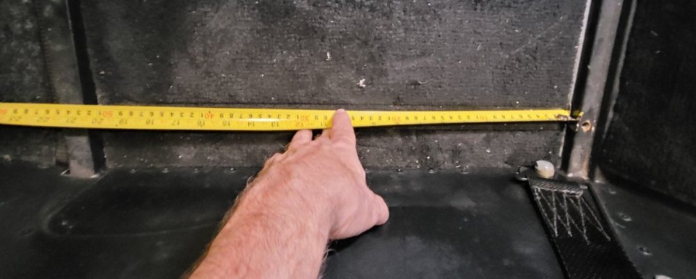

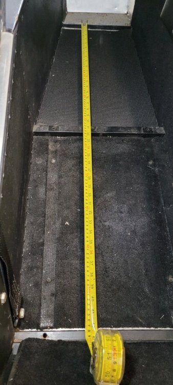

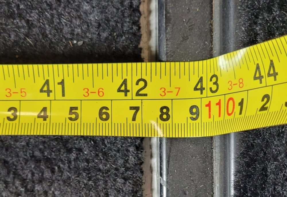

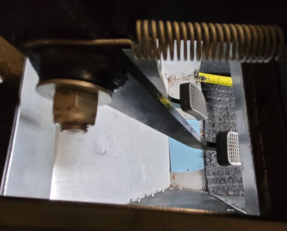

IamScotticus Posted February 29, 2024 Posted February 29, 2024 (edited) In an effort to help, and a good reason to clear some junk out, here are some measurements from my 95/6 LC live axle chassis. These pics are taken standing over the left (drivar's) side. measurement from rear tube inside edge to mid tube inside edge is 20.75" Yes, the squab seat base boards fit inside these two. Distance from front tube inside edge to rear tube inside edge 42 3/8" Notice the angle of the cable clutch pedal lever. This much distance shouldn't be necessary with a hydraulic clutch. These pedals are really high Also, a measurement from the center of my brake pedal to the center of rear bulkhead is 50.75" Edited February 29, 2024 by IamScotticus
pethier Posted March 1, 2024 Posted March 1, 2024 On 1/8/2024 at 10:03 PM, bball7754 said: You’ve probably already figured this out, but I believe the front wing stay is attached using the indicator. It is on my 1998, and you seem to have the same indicator. My indicator looks the same topside. One screw, one catch. It does not anchor to the strut. The two indicator mountings to the fender are much smaller, maybe #6-32 or the like. The two wires do not go through the strut, but run in a soft sleeve which is cable-tied to the square strut. Only the one hot wire goes through the back of the bulb-holder. The black ground wire is connected to one of the tiny mounting studs. Only the hot wire would need to be cut to remove the fender. The supply end of the wires comes out of the back of the pod for the main parking-light/indicator. Fender is attached to the square strut with a through-bolt that looks like stainless with an Allen button head. The end of the square tubing is open.
