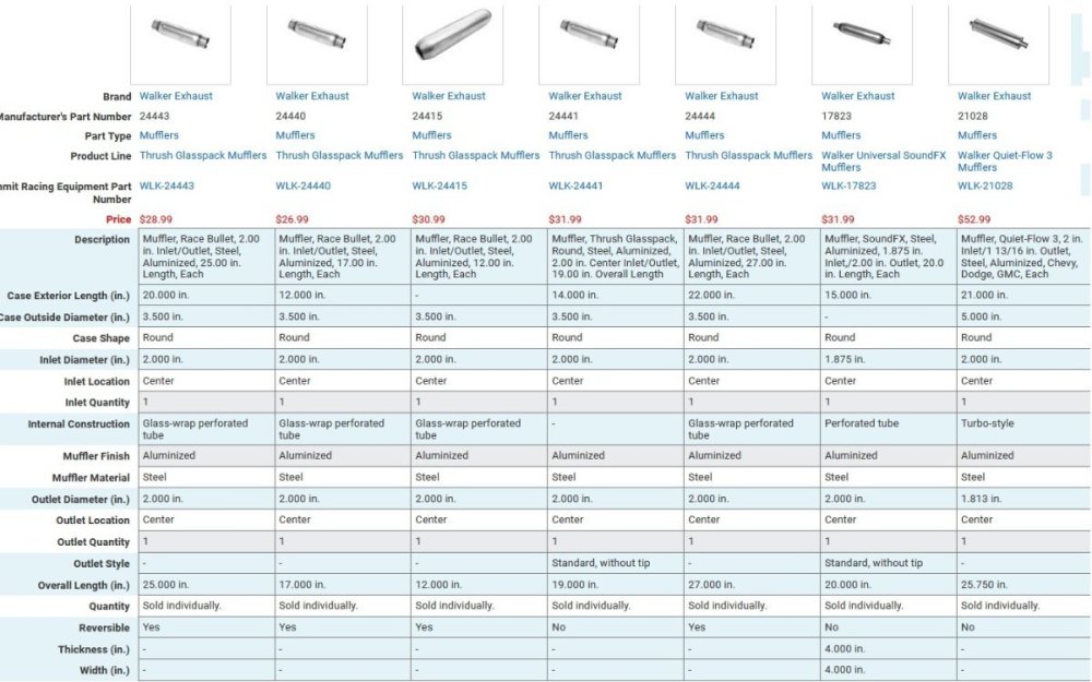

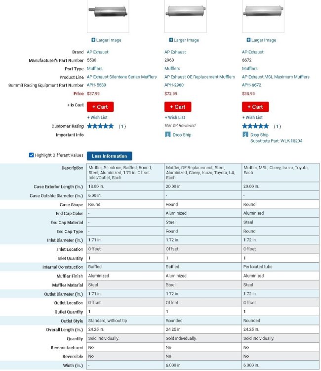

MV8 Posted May 8 Share Posted May 8 (edited) I narrowed it down based on fit and best muffling ability (appearance not so much but they could be skinned with stainless sheet is desired or ceramic paint). Twice the od and offset inlet to help compensate but likely moved back enough for the exhaust shop to provide a short piece of pipe offset/joggled to aid body clearance and allow max ground and wing clearance. Didn't look at glass packs or ovals, just round. There are some tractor mufflers that are practically identical but don't offer any improvement. For a bit larger/looser fit to the inlet: https://www.summitracing.com/parts/mpe-201-9994 and https://www.summitracing.com/parts/wlk-17816 Edited May 8 by MV8 Link to comment Share on other sites More sharing options...
