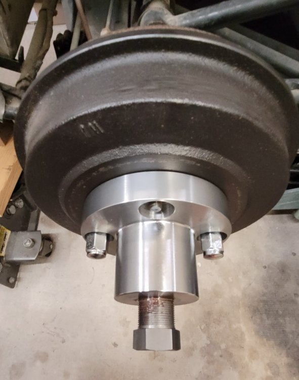

IamScotticus Posted December 30, 2024 Author Posted December 30, 2024 (edited) Here is a nifty tool for the Triumph hubs, a hum puller/extractor available from Rimmer Bros. The concept is to apply enough pull for the hub to separate after wacking the hub, something fairly elementary when dealing with tapered connections. It was this or a hydraulic press. This is portable. Staged for demonstration Caution must be taken to not warp the hub. Edited December 30, 2024 by IamScotticus 1
jbcollier Posted December 30, 2024 Posted December 30, 2024 The problem with the Triumph hubs is that they are relatively soft and easily distorted if you carelessly use a standard puller without adequately supporting the hub flange. The various factory and aftermarket pullers work much better.
