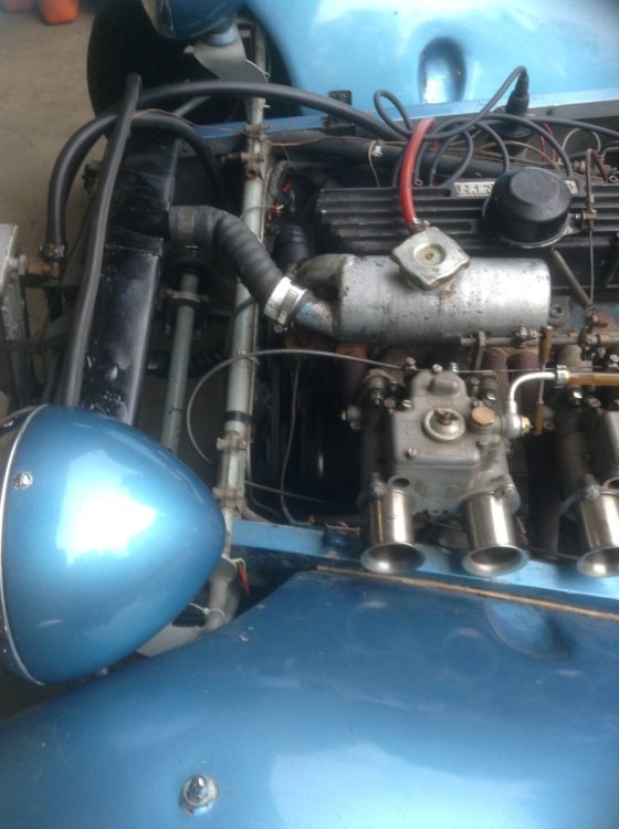

jbcollier Posted June 1, 2024 Posted June 1, 2024 Can you please post some photos of your hose routing and radiator?
SENC Posted June 1, 2024 Posted June 1, 2024 (edited) I just remembered you mentioned the swirlpot is homemade - maybe a picture of that too? Is the design similar to this? Inlet from head to high point on the pot, outlet to radiator at the low point? I'd be tempted to remove the swirlpot and turn the engine over to see if it shoots water up as expected. Edited June 1, 2024 by SENC
TEM Posted June 1, 2024 Author Posted June 1, 2024 Video of the swirl pot in action, or inaction. trim.C9CEA96F-7C19-4E29-9FA2-778830B4A255.MOV
TEM Posted June 1, 2024 Author Posted June 1, 2024 Nice looking swirl pot. Mine is similar but not near as nice.
SENC Posted June 1, 2024 Posted June 1, 2024 Interesting design, though I'd wonder if it would be as effective removing air as the more vertical design. Regardless, that wouldn't be your problem I don't think. Looking at the design, I'd expect to see a gush of water coming from top left of the video on increase of rpms. As you've described, the video shows that isn't happening - it does look to me like the outlet is attempting so suck water out upon decel. That leads me to believe the outlet to radiator to pump section is ok and trying to do it's job, but from pump to swirl pot inlet isn't. I'd rig a hose to the pump inlet and remove the swirlpot to see if some hose pressure gets water up through the head. If not, you could open the drain on the block - if it flows there you may have increased the chances it is a head gasket resteicting flow or clog higher up - if not it would suggest a blockage in the block. In the head gasket idea, I do recall from searching for mine that not all are designed the same - any chance of pictures of that gasket from last rebuild?

SENC Posted June 1, 2024 Posted June 1, 2024 (edited) very strange, I'm at a loss - unless the swirlpot inlet itself is blocked, it seems either a 2nd bad pump (unlikely) or maybe just enough blockage in the engine to prevent high enough flow to get up to the pot, but not enough to prevent water creeping through. Edited June 2, 2024 by SENC

SENC Posted June 2, 2024 Posted June 2, 2024 (edited) A longshot, but the cap on your swirlpot isn't a high pressure or malfunctioning cap that is blocking the overflow tube, is it? Wondering if there is any possibility that air pressure is building up in the swirlpot and keeping water from flowing up to it. I'm doubting this since you've run it without the cap at least long enough to see/video activity in the swirlpot but just a thought to consider. Edited June 2, 2024 by SENC
SENC Posted June 2, 2024 Posted June 2, 2024 3 hours ago, TEM said: Tomorrow I'll pull the swirl pot and start the car to see if water gushes out of the open flange. While you have it off, run a hose into the inlet - would at least give you an idea of what a strong inflow of water should look like from the top. Perhaps it is internally baffled in some way and you wouldn't see obvious flow as in mine.

TEM Posted June 2, 2024 Author Posted June 2, 2024 Hoses are all new, no rags or other blockages. Everything flows with a garden hose or simply pouring water in from a bucket. filling from the top of the rad flows out the bottom hose, filling from the thermostat housing flows out the pump and lower hose, I can fill the entire system from the rad to over flowing from the thermostat opening. Last test (with the video) was filling the system from the top of the radiator with the front end raised to remove any air from the block. One part of the system that I don't like is the swirl pot exit to radiator is lower than the radiator inlet which means there will always be an air pocket at the top of the radiator.
jbcollier Posted June 2, 2024 Posted June 2, 2024 All swirl pots have the incoming coolant higher than the outlet. Their purpose is to separate air out. If you did it the other way, you would add air in.

TEM Posted June 2, 2024 Author Posted June 2, 2024 JB, I'm not saying that the inlet and outlet of the swirl pot are reversed, I'm saying that the outlet of the swirl pot should be higher than the inlet of the radiator. Yes, swirl pots remove air but in our application they also are the means to fill the system with water. When the tube to the radiator is below the top of the radiator, an air pocket will remain.
