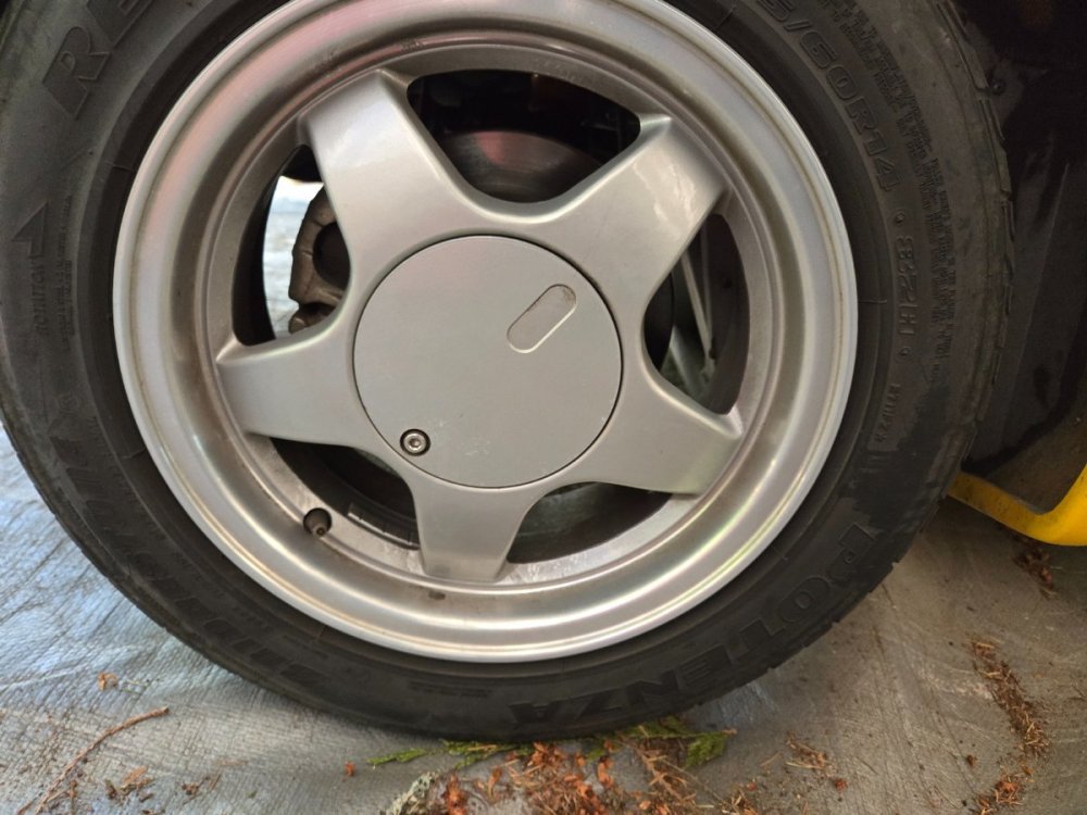

I.m looking for a spare wheel for my 1994 westfield se.
Any leads would be very grateful 🙏
I.m located on Vancouver Island Canada. However willing to travell within the US.
Thanks for looking & have a great day

What are the particulars?
PCD?
Rim diameter?
Width?
Offset?
Back space?
You would be very disappointed to buy a rim to find the calipers dont clear.
Edited by IamScotticus

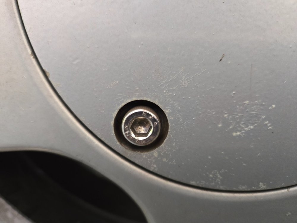

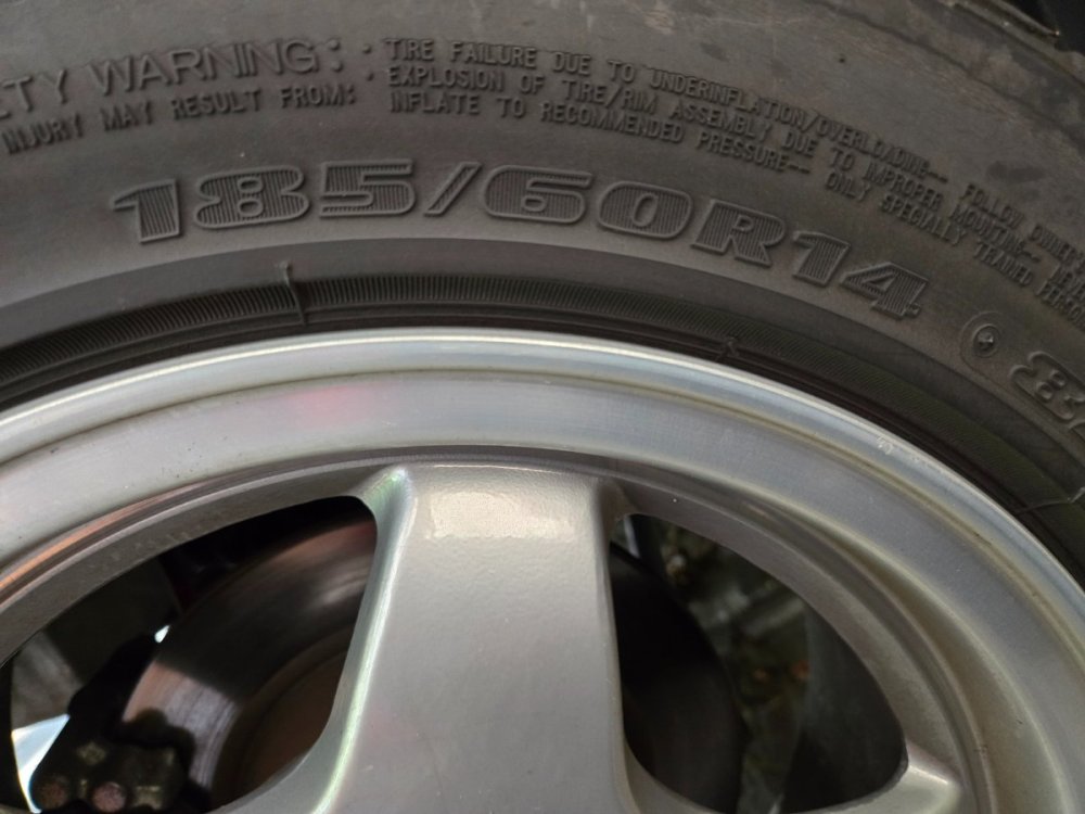

A pic of the wheel center with the center cap off should reveal the wheel specs. I'm guessing 14x6, 4x100, ET45.
The PCD should be 4x108 but not sure about offset given this is a live axle car (SE not SEi).  I seem to recall it differs, and might even differ front to rear, so definitely worth measuring.  @Paul summers are you looking for a matching spare or just a spare that fits?
Hi Paul, do you have that center cap off yet?:classic_smile:
What information is embossed in the wheel under the center cap? If not there, look on the back side of the spokes.
Edited by MV8
I do not. Those are Rimstock Rimstars. You could get a spare that doesn't match but will fit properly and put a vinyl cover on it. Very common pattern if 4x108 pcd but those specific wheels are rare now.
