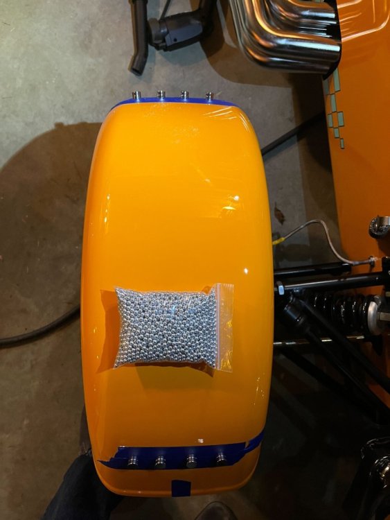

Timberline Posted November 11, 2024 Author Share Posted November 11, 2024 I wanted to share my bond process as maybe it'll help out another builder. I did go with the M3 08115, there is no substitute for a dedicated 2 part adhesive. Good bonds are ones that have constant clamping force applied during cure, so I went with a different securing method: A couple pounds of shot over the wheel center was a feel good (a lot like the tape method), but the rare earth magnets directly over the wing stays were great. They applied a bunch of clamp up right where it was needed. This method really frees up other options because you can do it on the ground or can remove the wheels (taking care about wheel center). One thing I didn't like after getting too far into the process was cure temperature. It was 40s and 50s during the cure. Technically its okay by 3M, but I did hit all the adhesive with a heat gun initially and after 12/24 hours. If they fail, I'll just blame it on the temps, definitely not my methods... I was able to drive around with the magnets in place after 24 hours. Note: the sound of one sliding over and snapping to another while driving was a horrible sound! Link to comment Share on other sites More sharing options...
Austin David Posted November 11, 2024 Share Posted November 11, 2024 the magnets are a genius idea. You may never get away from the rocks in your seat. I have mudflaps and I believe they help, but I still get a lot of rocks and debris. 1 Link to comment Share on other sites More sharing options...

JohnCh Posted November 11, 2024 Share Posted November 11, 2024 Great idea! I've become a big fan of rare earth magnets over the past year and have used them in various projects but hadn't thought about this. Are you sourcing from Amazon or do you order from somewhere with better and more consistent quality? If so, please share Link to comment Share on other sites More sharing options...

Timberline Posted November 11, 2024 Author Share Posted November 11, 2024 Just now, JohnCh said: Great idea! I've become a big fan of rare earth magnets over the past year and have used them in various projects but hadn't thought about this. Are you sourcing from Amazon or do you order from somewhere with better and more consistent quality? If so, please share Nope. Borrowed the magnets from a friend. Though I did shatter one... maybe I should find them a replacement... Lots of caution was needed as they could do damage. I did all the magnet handling on the other side of garage and stuck stacks to a shelf. That was when I broke one. Snapped my fingers a bunch of times too but I think it was worth it for the bond clamp up. Link to comment Share on other sites More sharing options...
