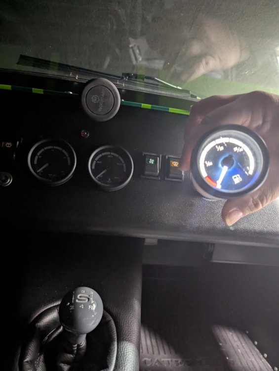

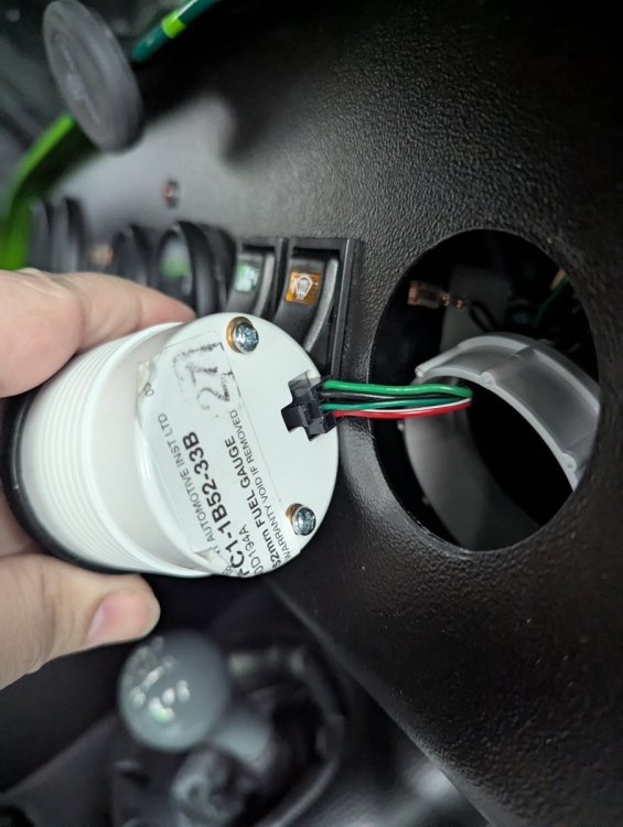

hyper7 Posted December 17, 2024 Posted December 17, 2024 Well in that case, here's the two pictures I sent to catmando in regards to the gauge correction unit.
