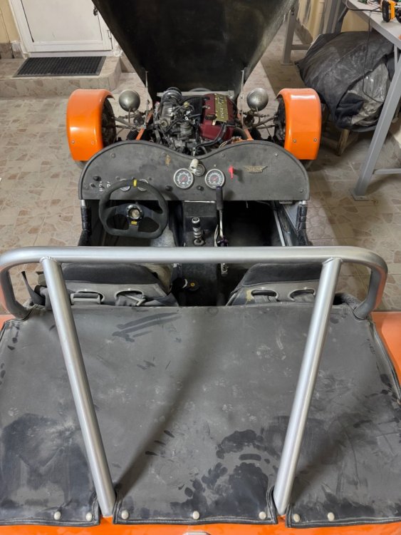

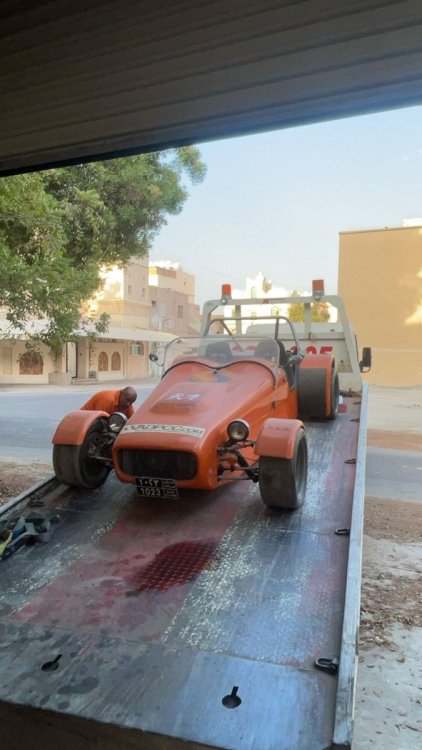

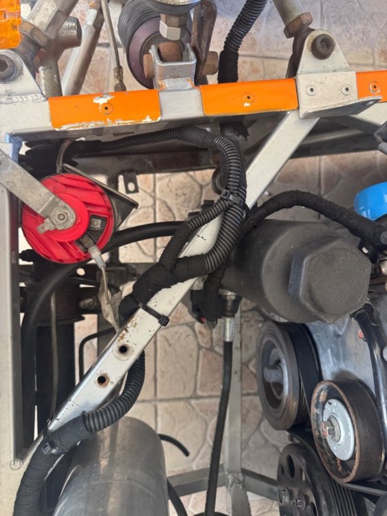

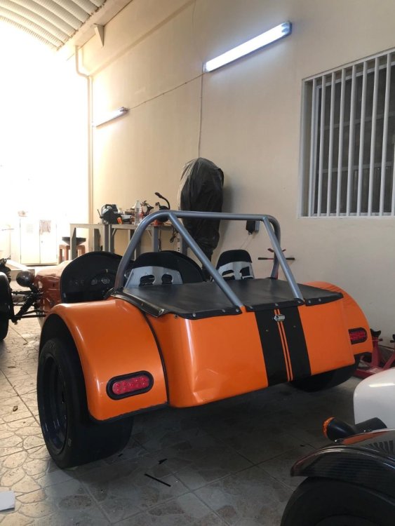

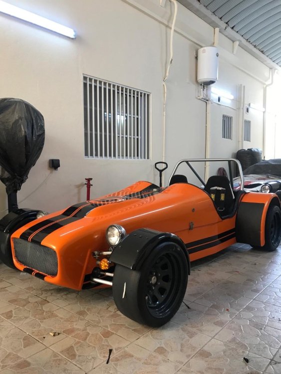

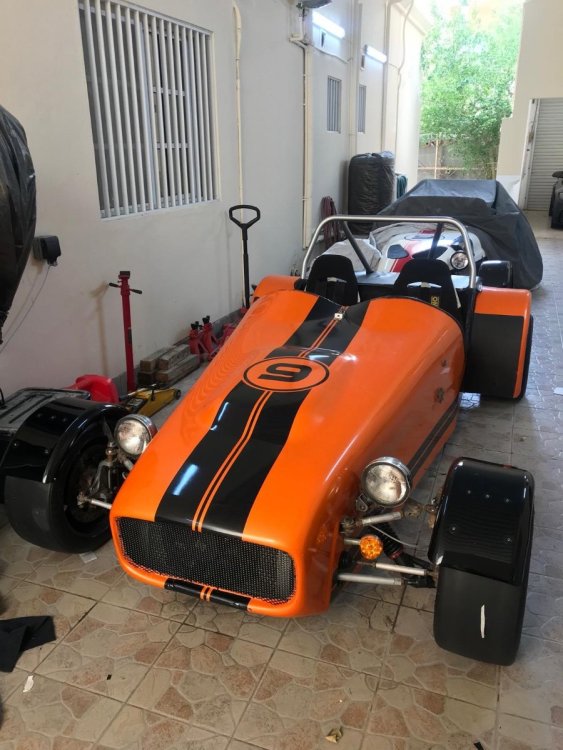

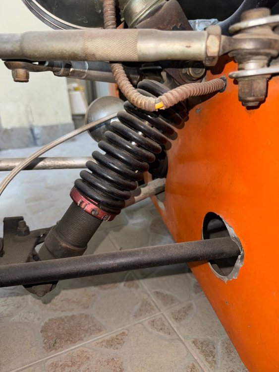

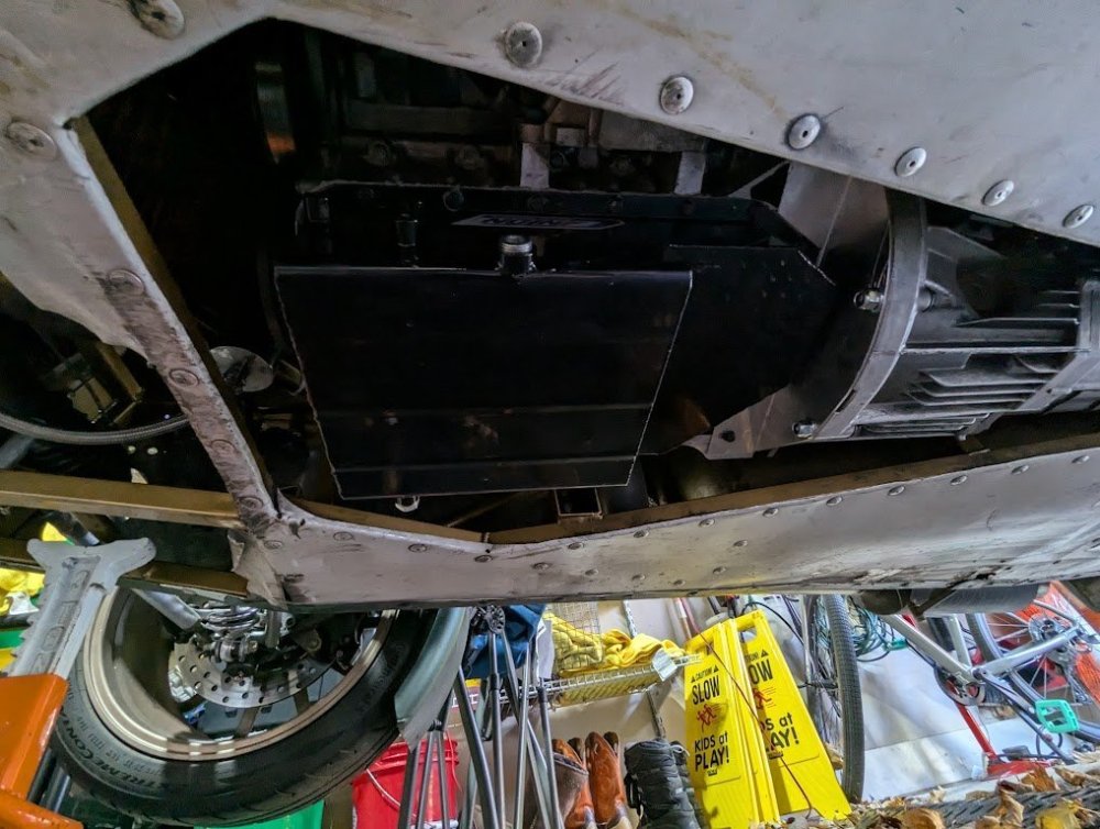

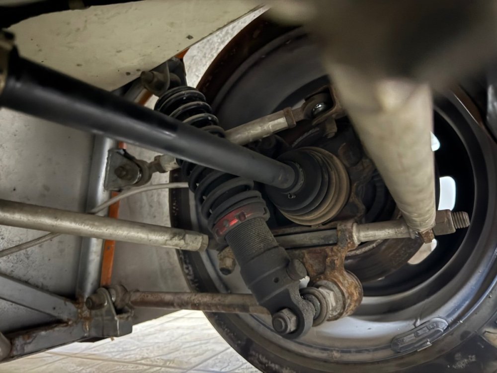

Hi, today i got delivery to the only Ultralight in Bahrain which was stored for more than 10 years. Thankfully the car runs very well didnt get to drive it just got the engine running and it sounds well thankfully. Ill be starting from the front of rhe car ill be removing the engine changing most of the gaskets and seals with the trans gaskets. All the fluids of the car, tidying things up behind the dash and the engine loom. Inspecting the fuel tank and lines. Moving on to the brake system which seems to be very bad in terms of condition with the shocks which are leaking in all four tyres. The rear right hub seems to have a damaged bearing. Or maybe the calliper is stuck.
Would like to get your thoughts on how would you see the start should be and what should be looking for first. Any ideas recommendations that would be highly appreciated. Hope you enjoy the rebuild.

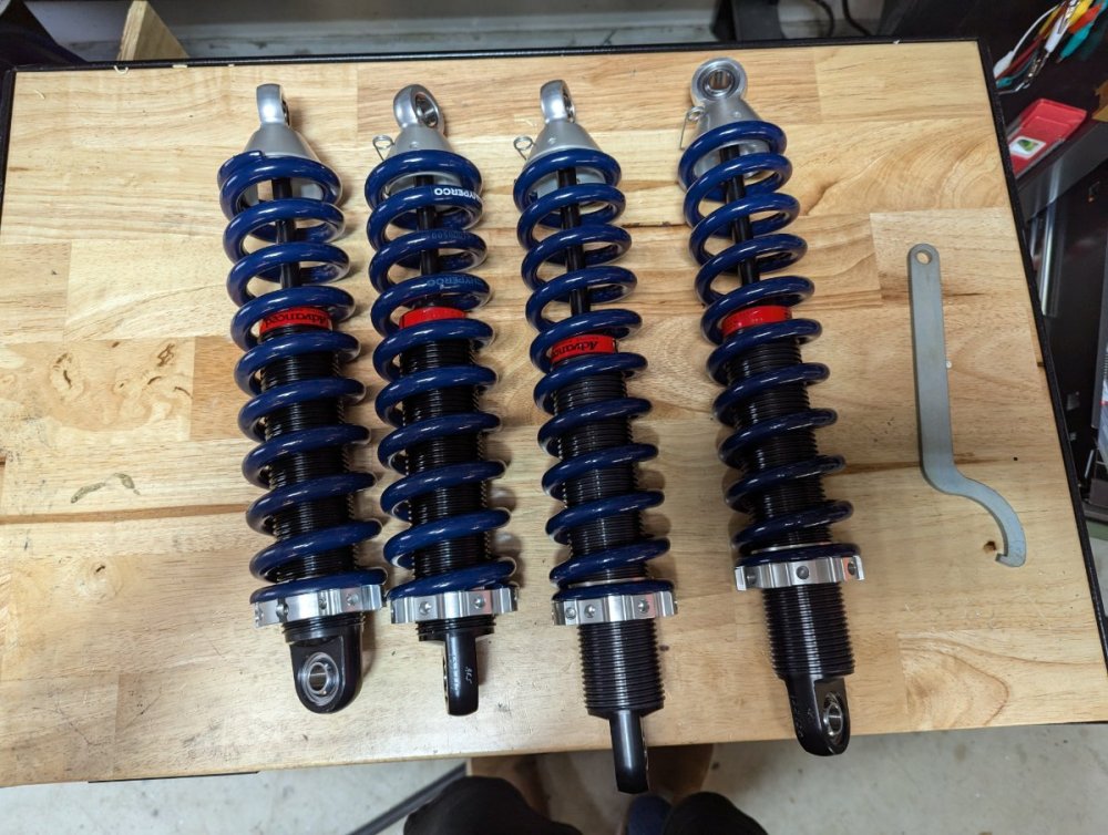

Jumping ahead on you by about 10 steps but I just got these shocks and springs delivered in the mail.  After a lot of pondering I decided on this set. Hopefully it saves you sometime shopping around
Advanced racing suspension in Indianapolis.  Person's name is Corey.  Springs I went with are 500 front 300 rears.  Shocks are not adjustable but tuned by the manufacturer to the setup.  They know the car

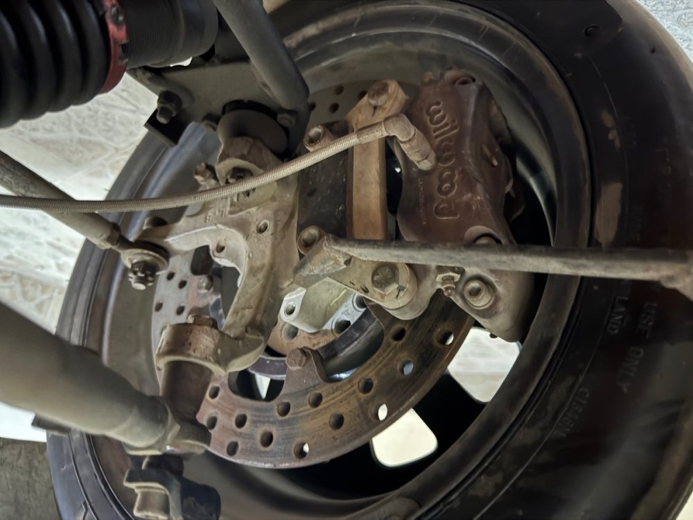

Nice project! Thanks for the pics. Probably just need seal kits for the all the hydraulics as well.
Gadzooks! I have never seen holes that big in brake rotors.
Those are the wilwood 12 inch rotors that come stock with the WCM.  All cars I have seen have those in front.

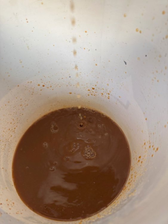

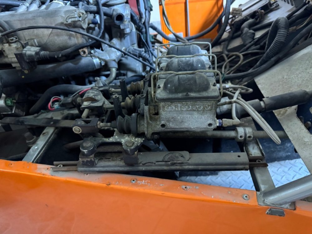

busy day today got the fluids out the radiator fluid was horrible. removed the Engine and gearbox out but ill need your help here am i missing something here the gearbox and engine are stuck together removed all the bolts. Total 9 bolts. I can get them apart by about an inch or so but not in full is there something wrong 🤔
Got the engine and gearbox on the ground safely and tried everything to get them apart but i couldnt 🥲
IMG_7534.thumb.jpeg.1c61373b155a80a70a1f8ebaefb274c6.jpegIMG_7535.thumb.jpeg.2b058797c4f8187b9ec9f2cb666cd189.jpegIMG_7549.thumb.jpeg.418557c8ce4cefad6673767d8b86e548.jpeg
No first-hand experience on this drive train, but most vehicles have a steel plate between the transmission bell and the engine block. The plate installs between the flywheel and block. You will also need to support the trans (lifting up) so all the weight is not on the input shaft, then wobble the tail housing around in a circular motion as you pull.

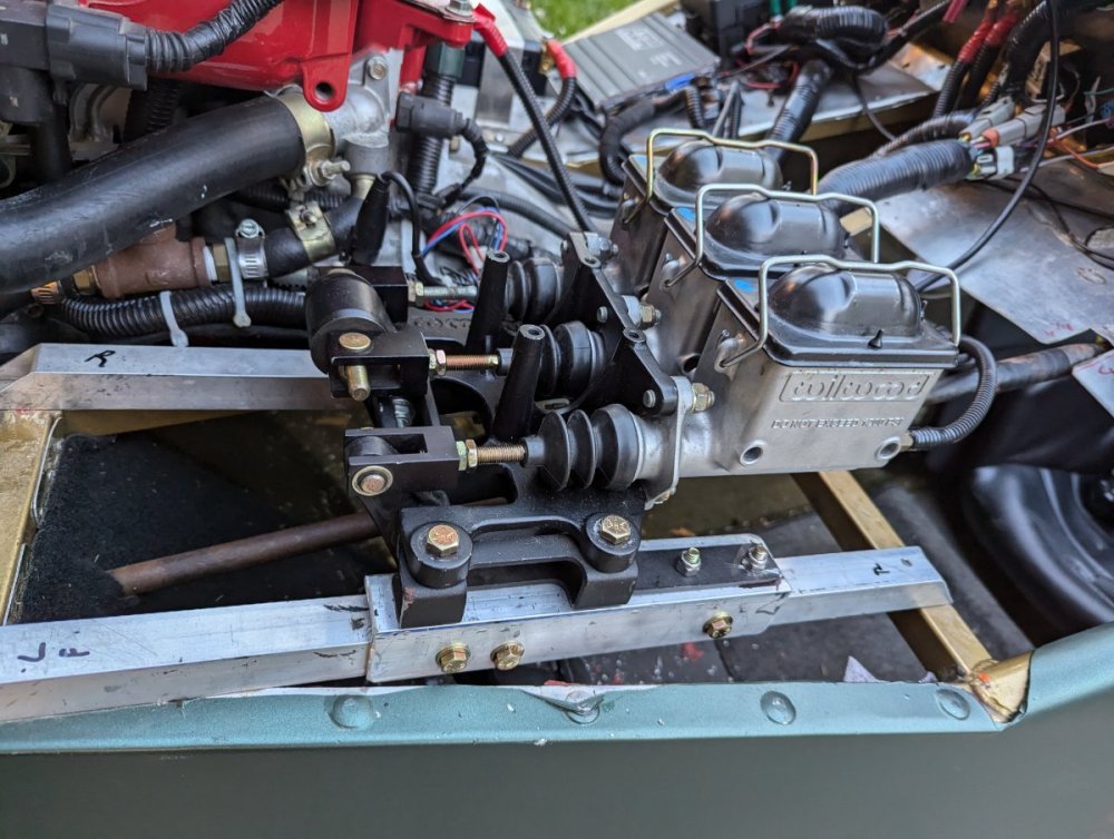

I like the drawer slide and threaded rod pedal adjustment. :classic_smile:
Edited by MV8
That adjuster was pretty sketchy on my car.  Really flexed when on the brake, to the point where it was concerning me that the pedal box might break off entirely.  Here's how I hard mounted it

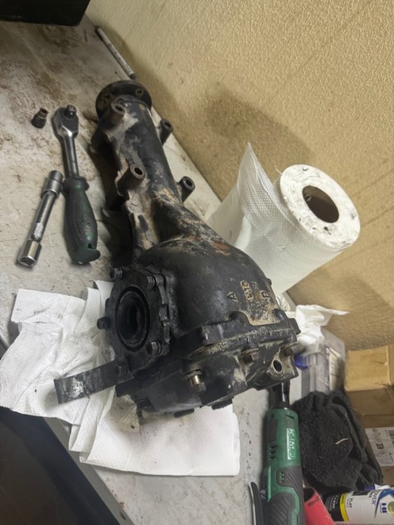

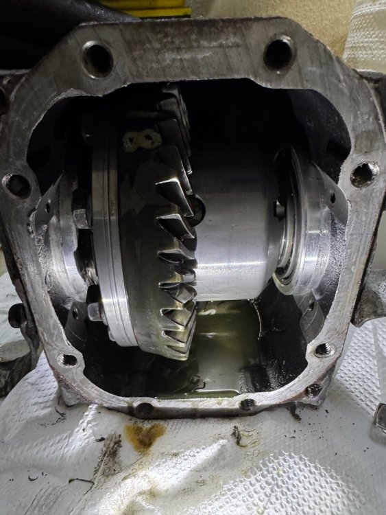

Engine and trans are finally apart it was the fork that i completely forgot about. Diff is also out unfortunately i think the lsd has an issue ill get it checked another day.
@nc7s4 any idea where can i get new rubber mounts (engine, gearbox and diff)
IMG_7568.thumb.jpeg.a0e3e35492e003b1ca4d9cb42ebb0ccd.jpegIMG_7577.thumb.jpeg.c081b225b8df6afc9b35610b3fb43503.jpeg
That is an r160 differential from a WRX, I think.  Good news is that it will be easy to replace the r160 with another r160 if you choose to do that.  Those parts are easy to find since they came with several different Subarus. Bad news is you thought you got an STI rear end.  I was also suspicious looking at your rotors in the back.  Those look like WRX rotors which is a standard setup.
Compare pictures of the rear cover for a r160 and an r180 to what you have. The STI came with an r180.

Quick update regarding my new springs and shocks. They do not work!!
10-In heavy springs are too tall.  Even at the top of the shock perch the ride height is too high.
Need to figure out how to fit shorter springs.  I think that only the rear of the car has clearance issues, front will fit industry standard 2.25 ID springs.
The rear of the car will probably still get 1.875 ID springs, but the problem with that is that they are limited in what you can get. It looks like the heaviest 8-in option is 250 lb.  That may be what I end up with in the back.
If the front can fit 2.25 in springs then there is any rate imaginable in that size 8 in long.

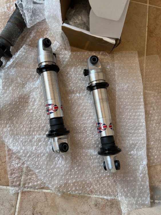

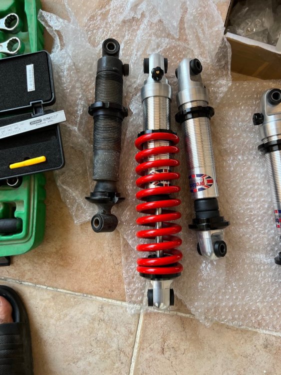

The good part is that im planning to keep it for the track only as the westfield is already built for the roads but getting it onto the trailer to the track will be a pain as it did give us a hard time during delivery. I may install the same shocks as the westfield (protech) they work fairly good for their price tag and i never had clearance issues with themIMG_2124.thumb.jpeg.b98ba7a0ec6ad30bda5ffad52586dbba.jpegIMG_2126.thumb.jpeg.eda813a4bd40120977d3c8f33ac8af91.jpeg0EF6A555-308E-438F-8870-A4A97AA8EAFC.thumb.jpeg.0af458ef062ed4c6c77af6ba267a2592.jpeg
Those look really nice.  The rear shocks are a little bit longer than the front ones on the wcm.  Front and rear call for 8-in springs.  Rear springs on my car need to be smaller diameter than the front.  Ymmv.  It looks like you have a few parts on hand to test fit which will be very helpful.  I will let you know how my spring rates work out. I am still waiting for the 525/275 springs to arrive.  Expecting it to be a harsh ride for the road but good for the track.
Edited by nc7s4
Yup ill test fit them when i get to that stage i even have a set of nitron shocks which i also test fit on the westfield but it was really low. Ended up switching back to the protech.

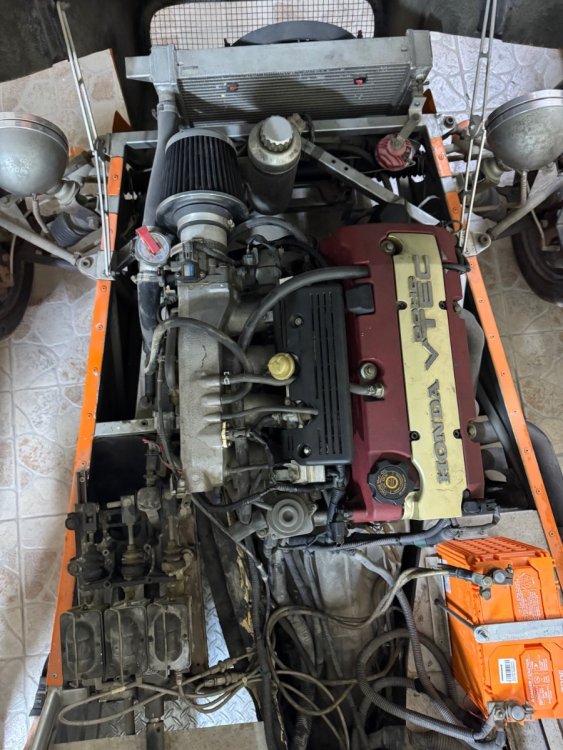

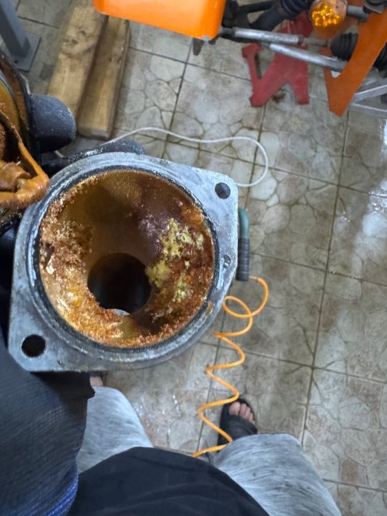

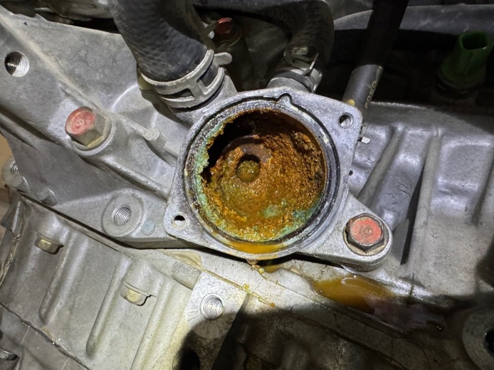

Hi, here are some pics i found related to the coolant lines of the engine which were in very bad shape ill be changing those.
i need help in finding one of the plastic hoses in the first pic below which broke when i tried removing the hose attached to it down. Honda used to supply the full thing now they only have the long pipe on the left.
