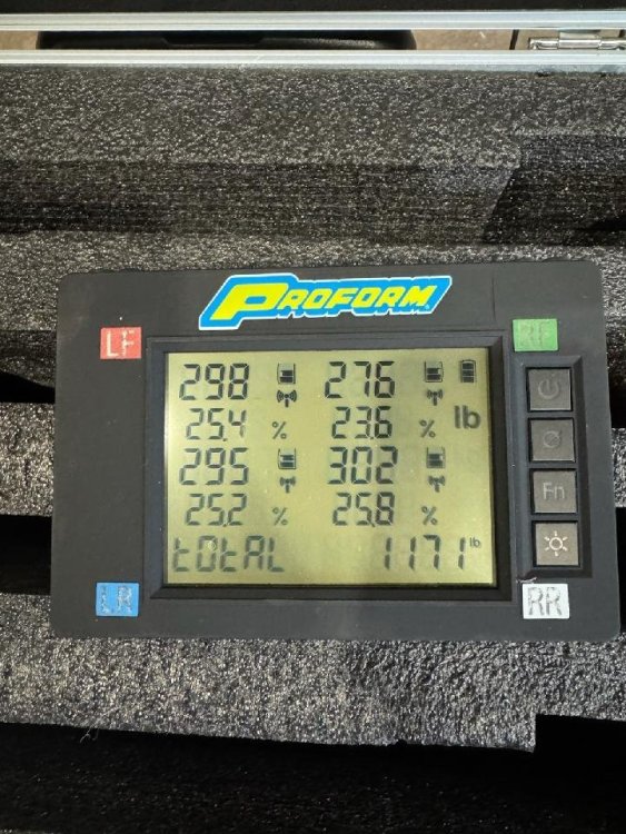

I wanted to give an update from my recent comparison between a stock 310S with all weather gear and my slightly modified 310 that I've been using for track days.
The following parts were weighed on my digital shipping scale and were removed from my car for track days:

Total - Stock with all weather equipment: 1220
            Track setup: 1171
The scales were not leveled accurately before dropping the car so the corner balance percentages are not accurate, but the total weight should be relatively accurate.
