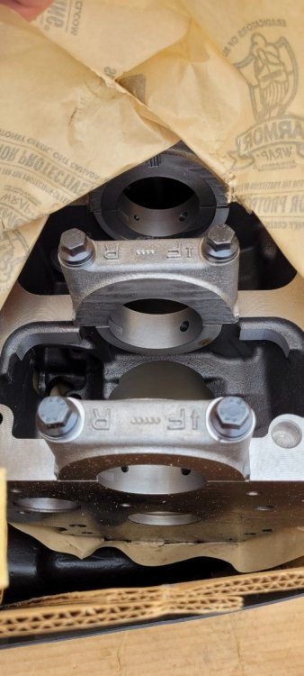

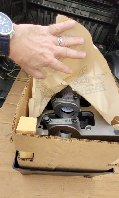

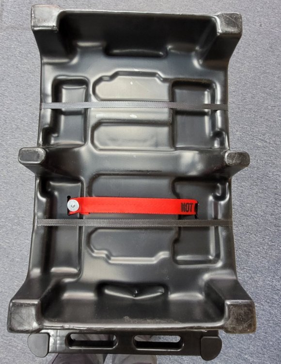

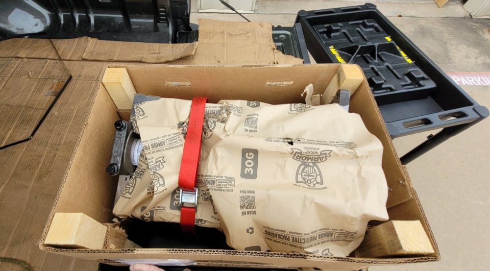

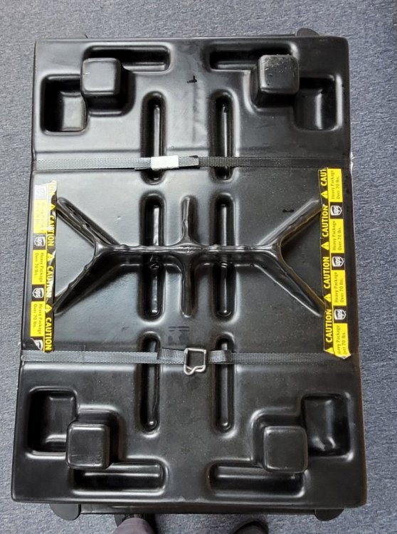

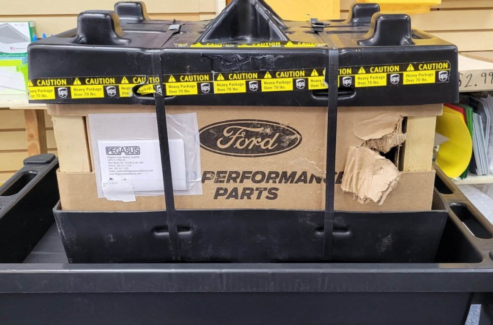

Apparently Ford Performance Parts is back in business with a new source for these lumps. Pegasus has them, I got one, and this is what you get.
Pokey pokey
Top
Bottom
Peek-a-boo
There was a bag of plugs and dowels.  Thsts it.  No, I'm not ready to get it out on the stand yet for your engine porn.  I will get around to that later. I am interested in showing the reliefs for the Pinto thrust bearings.
