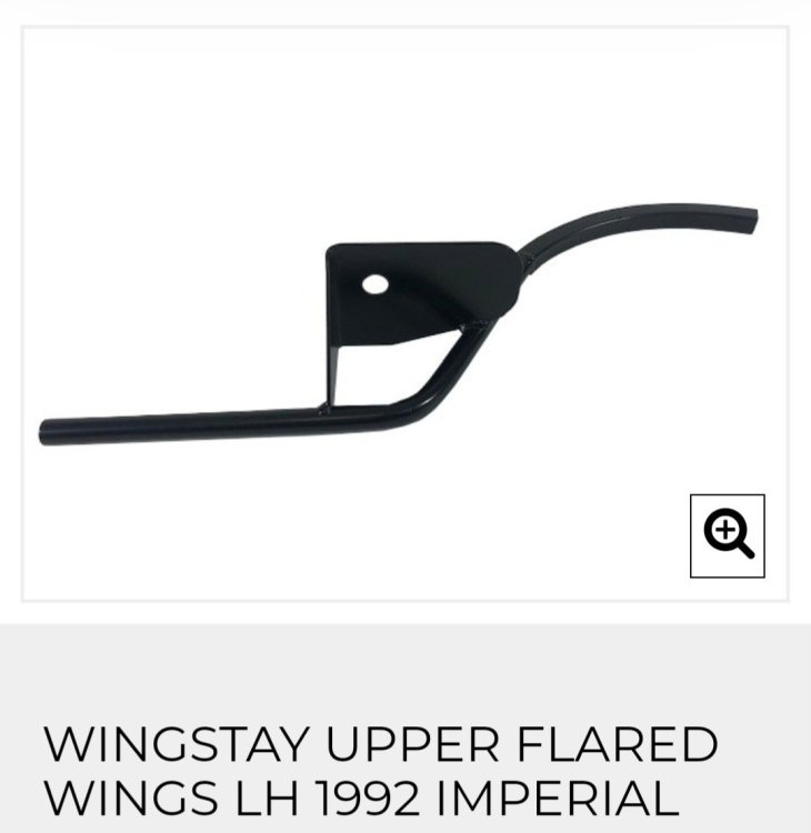

This is a new build with flared fenders. How do you mount the wing stays? Manual is for motorcycle fenders. Photos would be greatly appreciated.

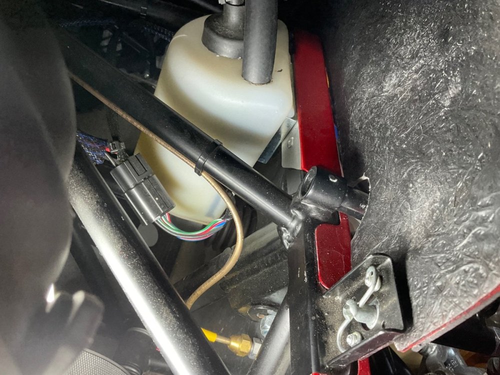

These photos are from Super Seven 1600 with the flared fenders, I hope they help. I did not assemble it was purchased completed so other than the photos I cannot offer any additional help.

I ask what YOU have because Caterham made a lot of changes and used different flared wing stays for different chassis types.
Specific things need to be discovered to get you an accurate answer.
Year of manufacturing,
Chassis type (deDion or live axle),
Distance of headlamp mount bracket from front of chassis rail.
The picture there shows a round tube wing stay which usually indicates a deDion chassis.  But I'm not certain that was always the case.

I think "flared" = clamshell.
This is the upper stay mount, about a 1/8 inch drilled hole with a corresponding screw inserted to prevent horizontal movement of the upper stay. See photo.
 The above photos are from a 2021 S3 Super Seven 1600 kit that was shipped to the USA in late 2021.

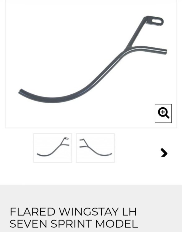

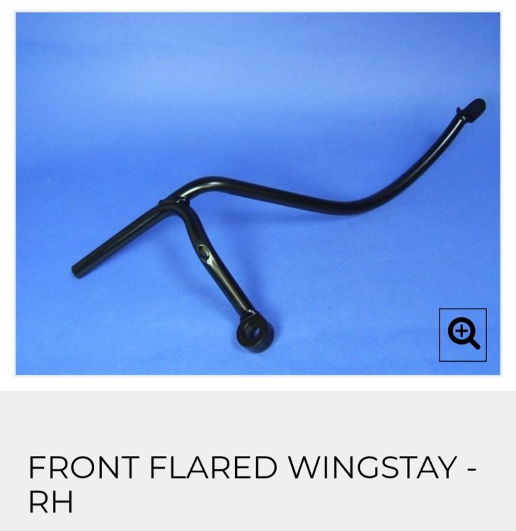

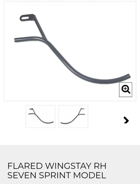

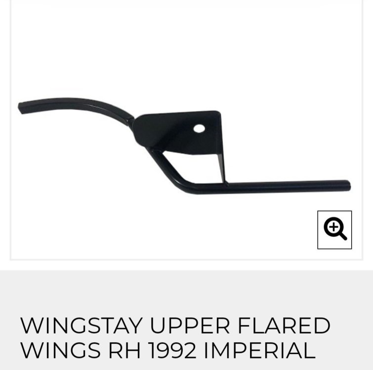

There are several different flared wing stays used in Cats.
Yes I know,  year model information would be appreciated.
