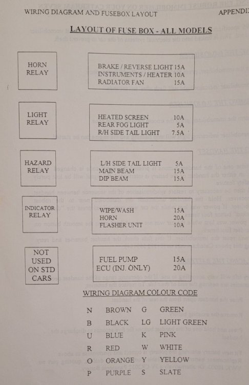

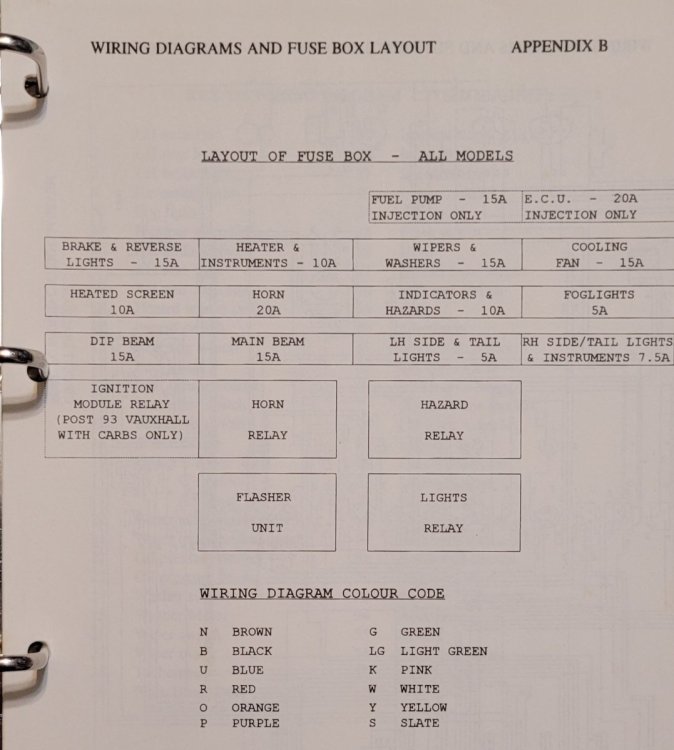

IamScotticus Posted May 27, 2025 Posted May 27, 2025 (edited) From a Jan 1996 build manual Locate the relay and tap it Edited May 27, 2025 by IamScotticus 1
wdb Posted May 27, 2025 Author Posted May 27, 2025 (edited) That last picture is the only thing resembling a wiring diagram in my owner's manual. I think that may be due the car being specced with no engine; the wiring diagrams appear to be engine-specific. I sourced a Ford engine diagram, which helped me figure out why the high beams and low beams were working backwards. Also verified the turn signal wiring for the front lights. The wiring to the front lights on this car is a bit of a mess, a lot of amateur electrical work. Reading the relevant pages in the assembly manual doesn't help much; they read more like suggestions. Edited May 27, 2025 by wdb

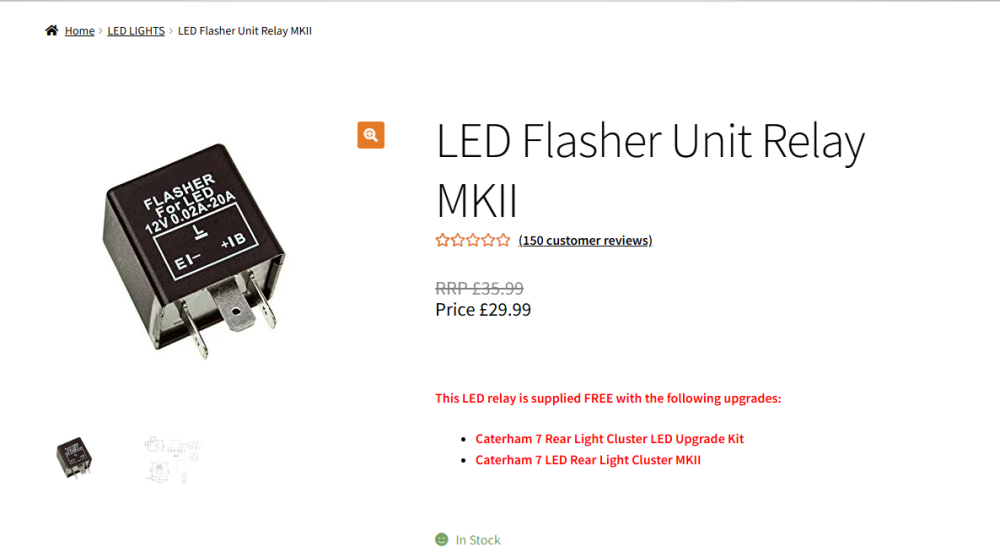

Vovchandr Posted May 27, 2025 Posted May 27, 2025 I think your original post had the right idea, replace the flasher with one made to work with low resistance like LED's. That's what I had to do for mine as all my lights on the car are LED now. Mine came from "JUST ADD LIGHTNESS" but they should be pretty standard units LED Flasher Unit Relay MKII - Just Add Lightness 1
David Hansen Posted May 27, 2025 Posted May 27, 2025 I did this and I ordered the "incorrect" one the first time. The pinout on each one might be different. For my Westfield this is the one I purchased. There is an alternate version here Notice the difference beween the + and th - on each one. Neither was expensive and the best part that after I installed my very (very!) bright LED bulbs I could adjust the rate of the flash. Also note - from previous experience get red LED bulbs for red lens, yellow for yellow etc and the colors really pop. If you put in a white LED behind the red lens it will obviously work but not have the same color depth and since the cost is exactly the same why not do it right. On sale today! 2 1
