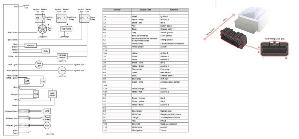

MV8 Posted July 7 Posted July 7 How does your wiring differ from the Omex harness shown? Do you have a JP1 jumper installed on the Omex ecm? You will need to take it apart to check. The software must also be configured for the magnetic ford crank sensor. Omex supports hall effect and magnetic so it must be setup properly. Fully charge the battery then perform another video with audio engaging the starter for two or so seconds, plugs installed and without.
Clarko Posted July 7 Author Posted July 7 5 hours ago, MV8 said: How does your wiring differ from the Omex harness shown? Do you have a JP1 jumper installed on the Omex ecm? You will need to take it apart to check. The software must also be configured for the magnetic ford crank sensor. Omex supports hall effect and magnetic so it must be setup properly. Fully charge the battery then perform another video with audio engaging the starter for two or so seconds, plugs installed and without. Yes, exactly as above👍 no lambda sensor or shift light. Ford 36-1… no Hall effect jumper on the board installed as of course it is VR crank sensor. I will send those two videos 👍
