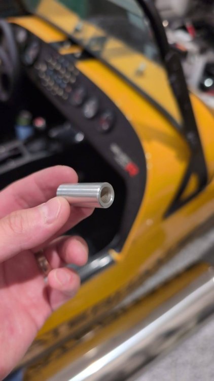

Where can I get these, and what are they called?

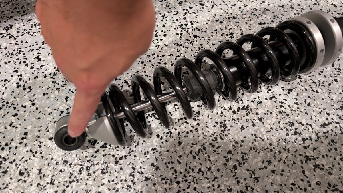

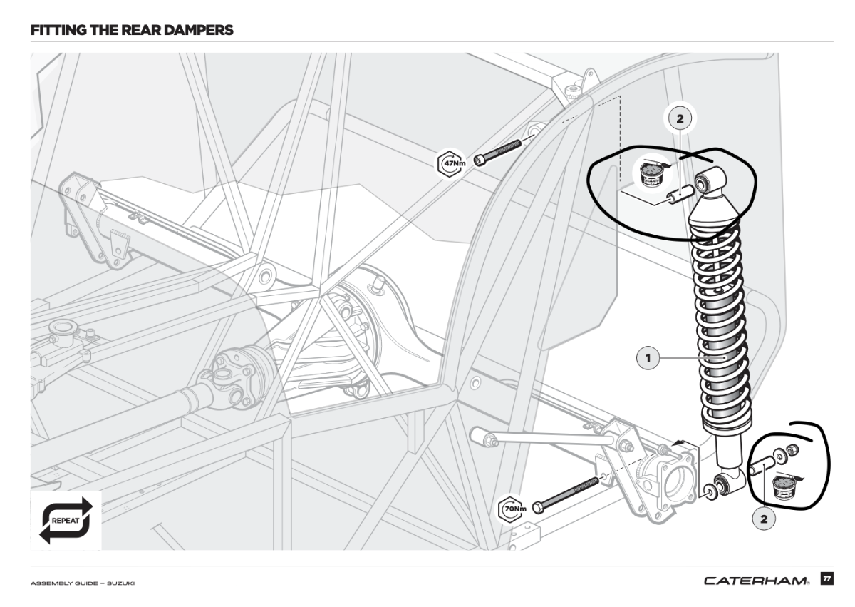

The manual refers to these as damper sleeves, but they're the metal sleeves that go into the hole of the damper so that the bolt is snug inside. See the attached pictures.
I've got 1, out of a necessary 4, and I'm trying to source more.

I just went to take the existing one out, and it looks like this manual is outdated. The bottom bolt fits snug into the bushing, so I guess I just need one.
Using my calipers, it looks like the I.D is 9.95mm and the O.D is 12.66mm... length is 34.52mm
In imperial, that's 0.39in, 0.5in, 1.36in.
I'll go look for some at my local hardware store too, I guess. I think I found some stainless steel ones, although my existing one appears to be much lighter, probably aluminum.
