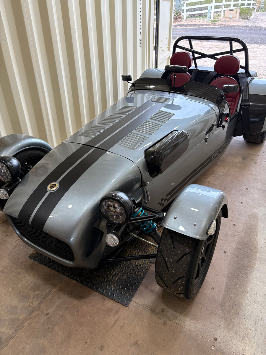

Reiver Posted 15 hours ago Author Posted 15 hours ago Thanks for the input..... you guys did the RTB conversion/dry sump on this car. I purchased it out of Washington State and the records came with it. Once I became familiar with the RTB's, sent a build instruction sheet...I've gotten them synced. 1
