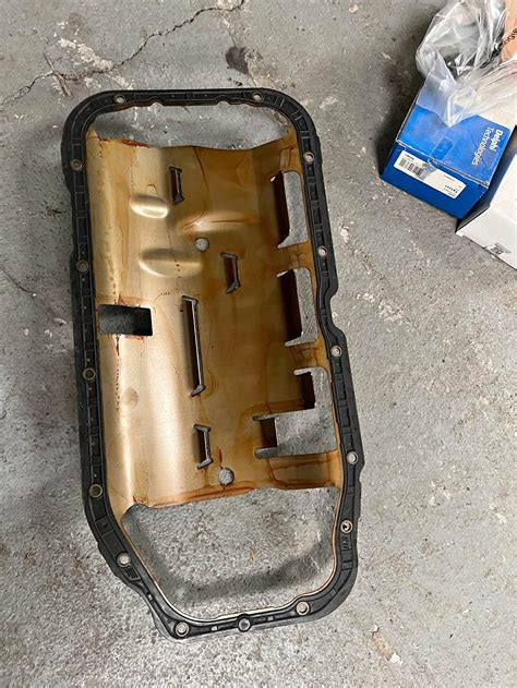

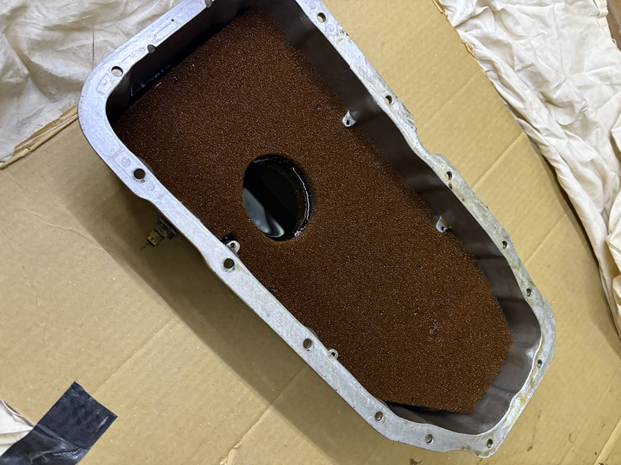

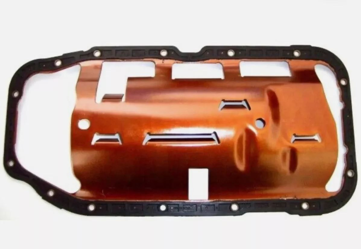

theDreamer Posted June 5 Posted June 5 (edited) You need to have a look at what your car has. There is NO cork gasket! There are two rubber (or other flexy material) gaskets held together with rivets. The C20xe has a windage tray the sits between these two gaskets. You can buy the gaskets separately and rivet them yourself, buy them riveted together or pay more and get it complete with a new windage tray as seen in the photos. You cannot use just a liquid type gasket. Sorry I can not find a photo of the foam baffle. it's just pre cut open foam with a cutout for the pick up. You can check with Chris at: https://redlinecomponents.co.uk Phone works better when it works. Yo can also find him via several of the Caterham Facebook pages. Edited June 5 by theDreamer
Reiver Posted June 6 Posted June 6 I had to get the baffle from Caterham England.... but you could check around. I also bought the gasket/wind tray combo as opposed to a separate gasket deal. I used an approved sealant on the gasket itself and especially where the block joins the front/rear engine pieces.... you will note the joined areas. The old baffle was 7 years old but was 'as new'...no degradation at all. Still, piece of mind etc.
menno Posted June 6 Author Posted June 6 Amazing. Thanks for the pics. Haven’t had a chance to see the inside yet

Reiver Posted June 6 Posted June 6 (edited) Looks right, this is what I bought...the same as that was in place...I'd replace it every time you removed the sump as the gasket part does lose its form....if you reused it you'd have leaks. Given the last time mine was changed, and how good the baffle looked (zero degradation) I'd not change it very often.... another 7 years or so. VAUXHALL OPEL 2.0 C20NE C20XE C20LET TURBO OIL PAN SUMP GASKET ELRING | eBay p.s. even tho you will drain prior to removing the sump a lot of oil will remain so be careful not to take a bath...what you see in the pic is what remained after draining the sump in the traditional manner.... Edited June 7 by Reiver 1 1
