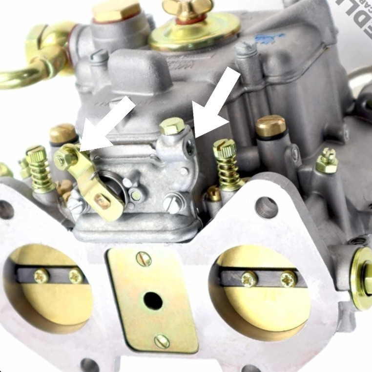

IamScotticus Posted July 14 Posted July 14 (edited) The cable housing is clamped on the clamp on the first carb and the wire passed through the lock nut on the enrichment lever to the lock nut on the next enrichment lever. Tighten the cable clamp. With the end nut tightened on the cable first, pull the cable to the fully open position. Move the lever of the first carb to fully open position and tighten. Release cable and check for lever closure. Provide enough slack in cable for engine movement. I do not have any additional springs connected to the choke enrichment system on my setup. Alternatively, a piece of rigid tubing may be placed over the connecting cable between levers to help the 2nd lever close if it binds. Also, notice the hole in the back plate. This is an improvement earlier carbs didn't have. If you don't have a hole, drill one. Edited July 15 by IamScotticus

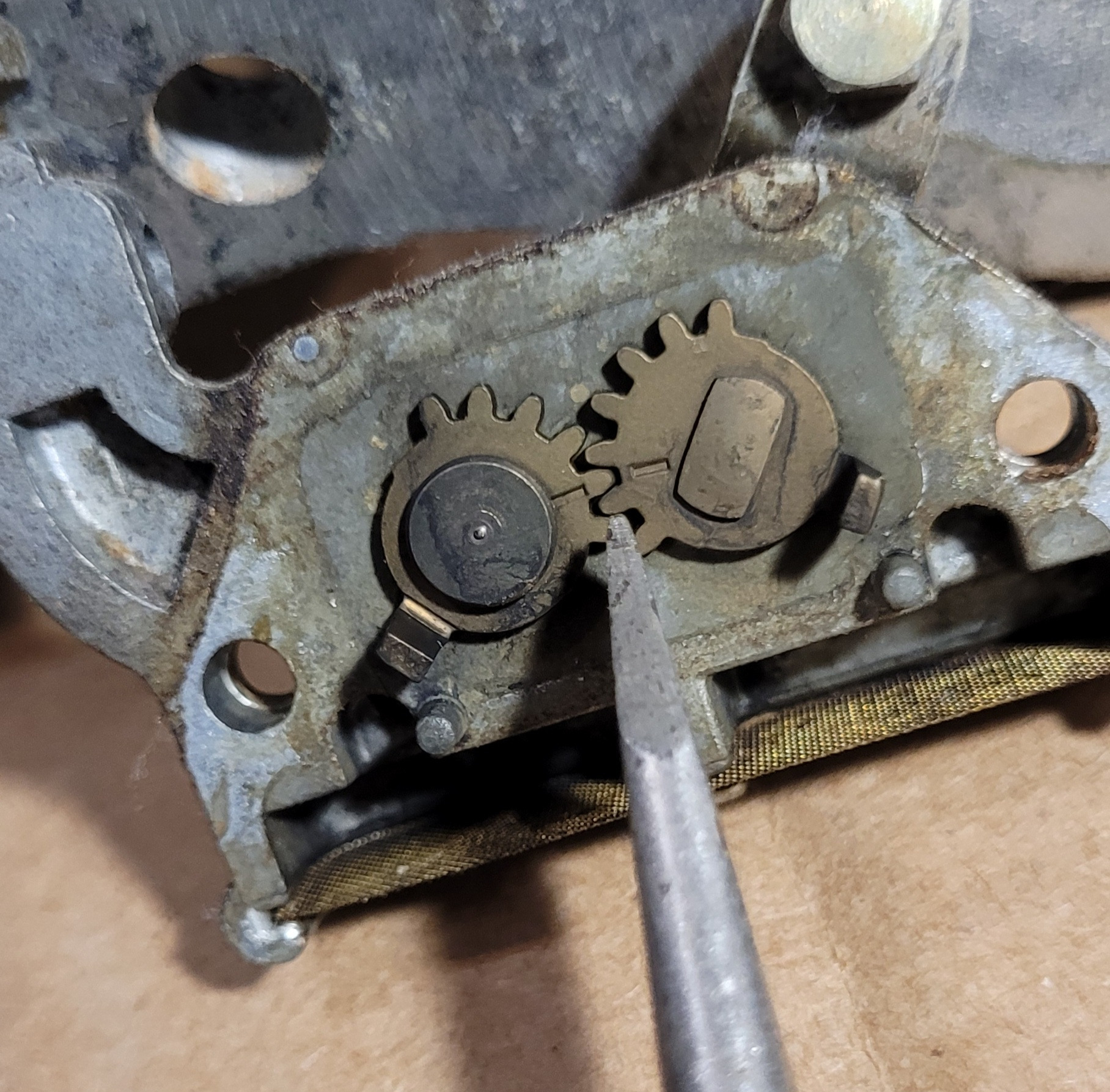

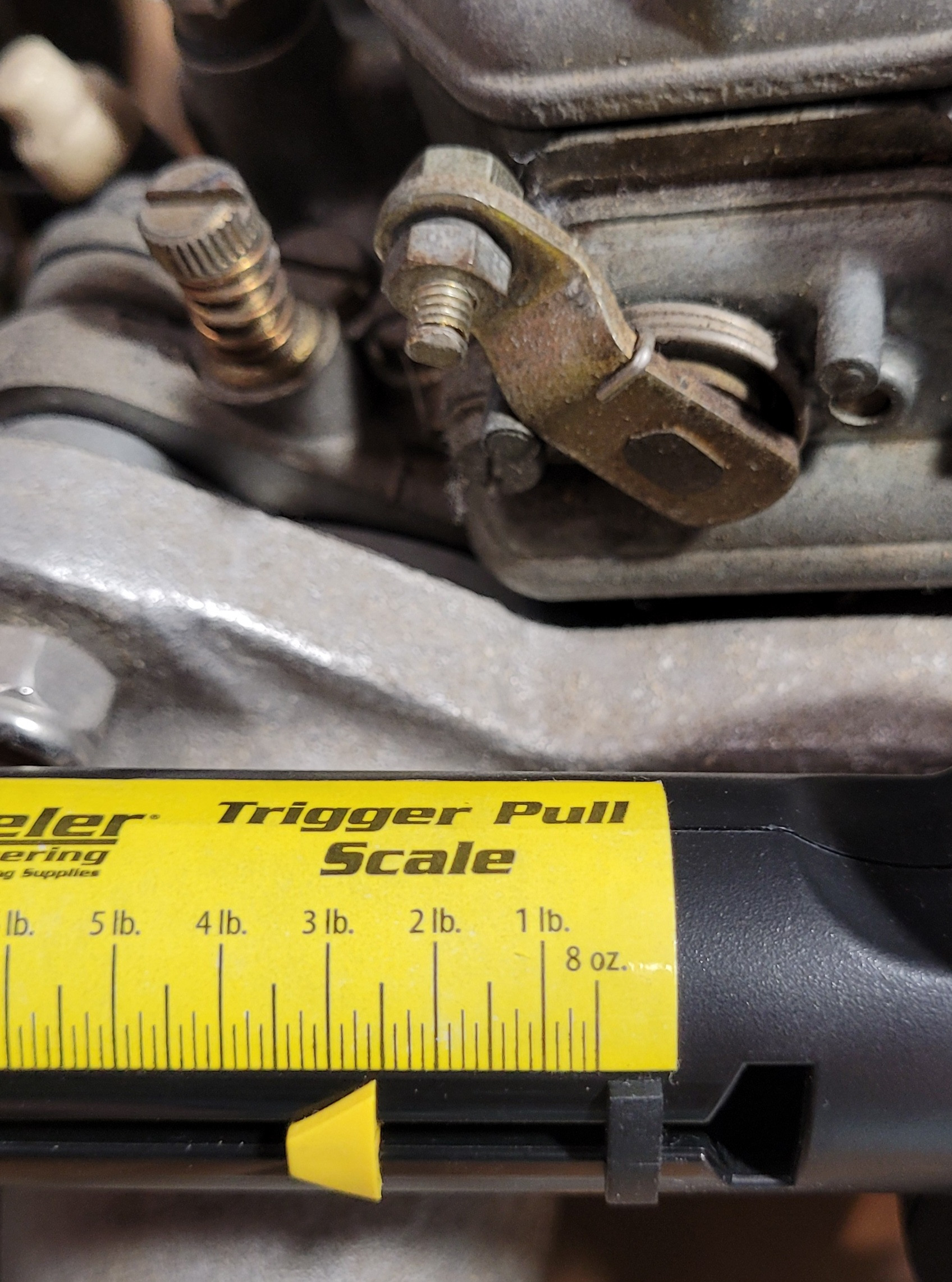

IamScotticus Posted July 15 Posted July 15 (edited) I did the trigger gage test and found my levers reqire 2.5 lbs of tension to move the lever to the stop position. So combined is 5 lbs, which is typical hand gun trigger. If your levers are harder than this, there is a problem to resolve. Remove the CSU and check the gears for functioning and the pistons for movement Edited July 15 by IamScotticus

7Westfield Posted July 20 Author Posted July 20 OK just got a scale to check the pull around 5 pounds on each lever!!!! a couple of pounds on each piston no binding evident just talked to Pierce, best guess is massively wrong springs in the pistons, so a new set is on the way not the first FUBAR I've found in this set..... 1
