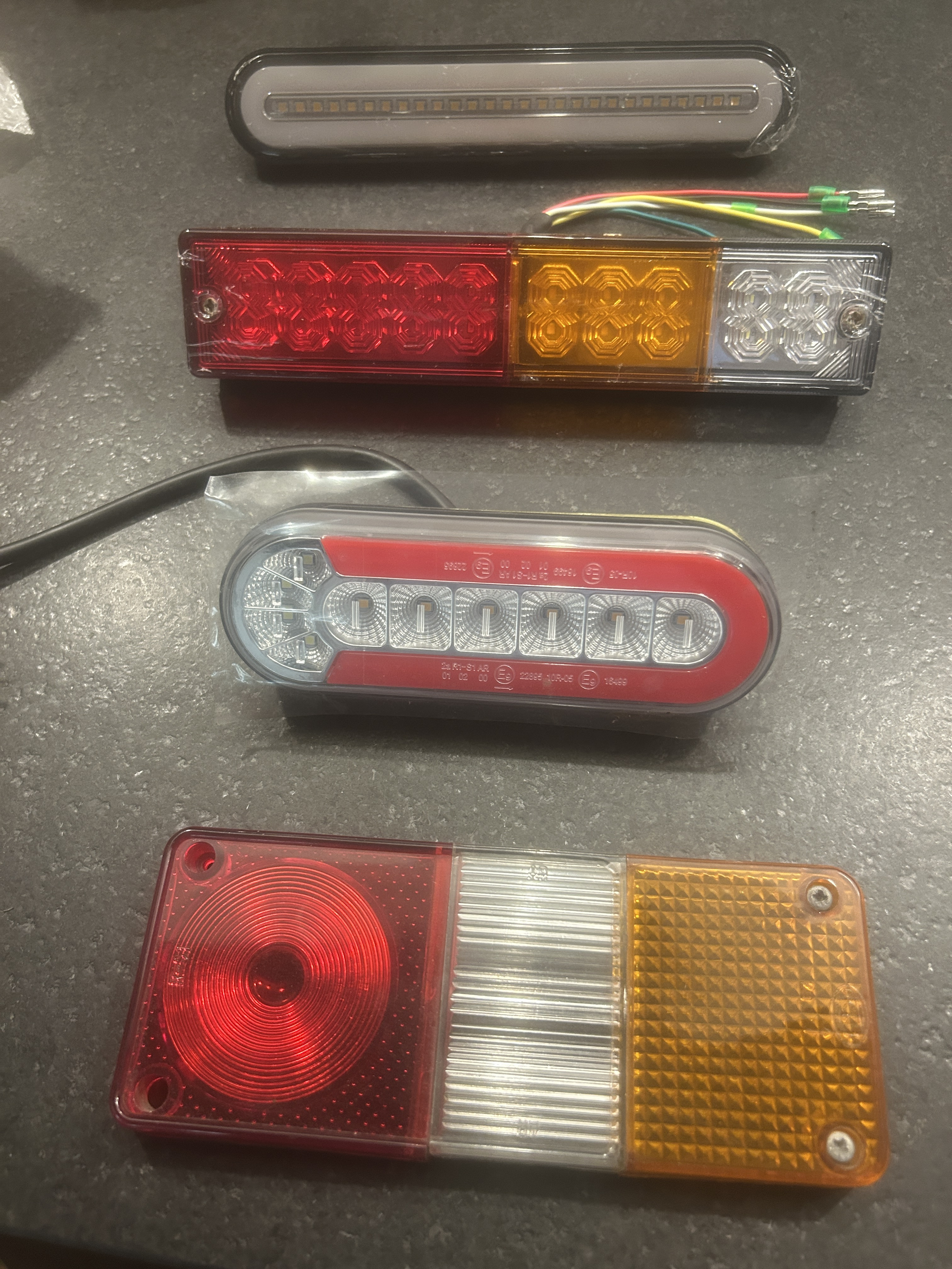

JB455 Posted July 17 Posted July 17 While out with the Litchfield Lotus Group last weekend someone pointed out that I had a brake light out. I stopped to grab a new bulb on my way home- I worry enough about being seen by other traffic in such a tiny car, I didn't want to be down a working brake light. Turns out the bulb wasn't the issue. The cheapo Birkin spec taillights are getting pretty rough. Loose sockets, cracked lenses, etc. They were never that good, even when they were new. I figured it was time for an upgrade. Something brighter. Something LED. After a quick search of my options online I ordered three different set of lights from Amazon as soon as I got home. They shipped quick. I hoped to have one of them installed this week. Well, it turns out I should have pulled the old lights before I ordered anything- the holes in the fenders were bigger than I expected. Nothing I had bought was big enough to cover, height wise. When I was doing my shopping I found that there weren't really any lights that were approximately the same size as the originals. 8"x3.5". They are a little smaller or a LOT bigger. I figured that 9"x2" would do in a pinch and the size would look right on the fenders. I do like the proportions of all of the lights I bought and they would look decent installed.... if only they covered the existing holes! I know that the newer Caterham tails are available, but their price point is significantly higher than I'd planned on spending. All three sets I'd bought off Amazon cost $75... combined. Obviously, I'm willing to spend more, just not the $600+ that the Caterham lights cost. Anyone have any other options they've found that would be appropriate for a Seven? Here's a pic of what I bought in case anyone else is looking... and doesn't already have big holes in their fenders. All are stud mount with parking, brake and yellow turn signal functions. The lense from the original Birkin lights is at the bottom.

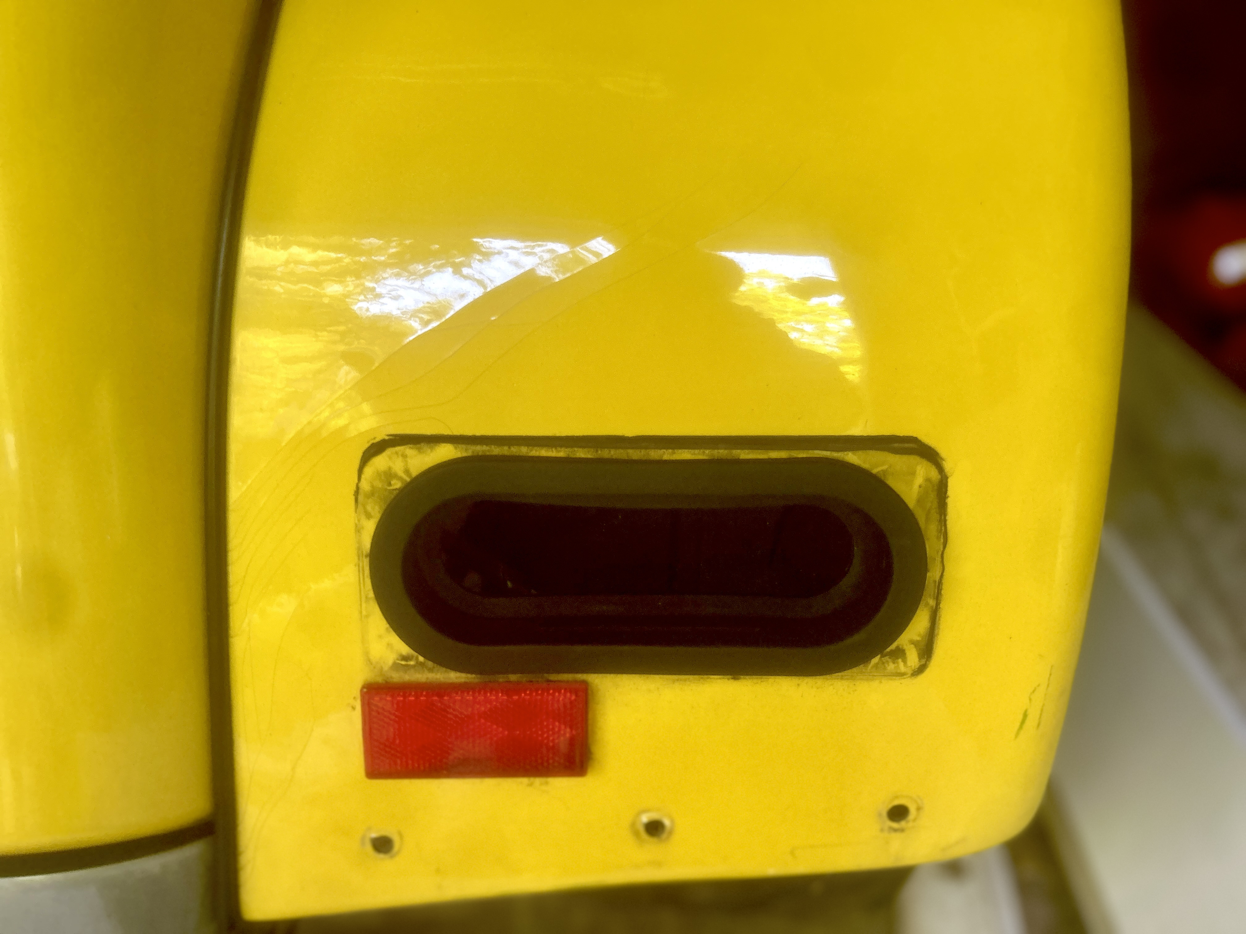

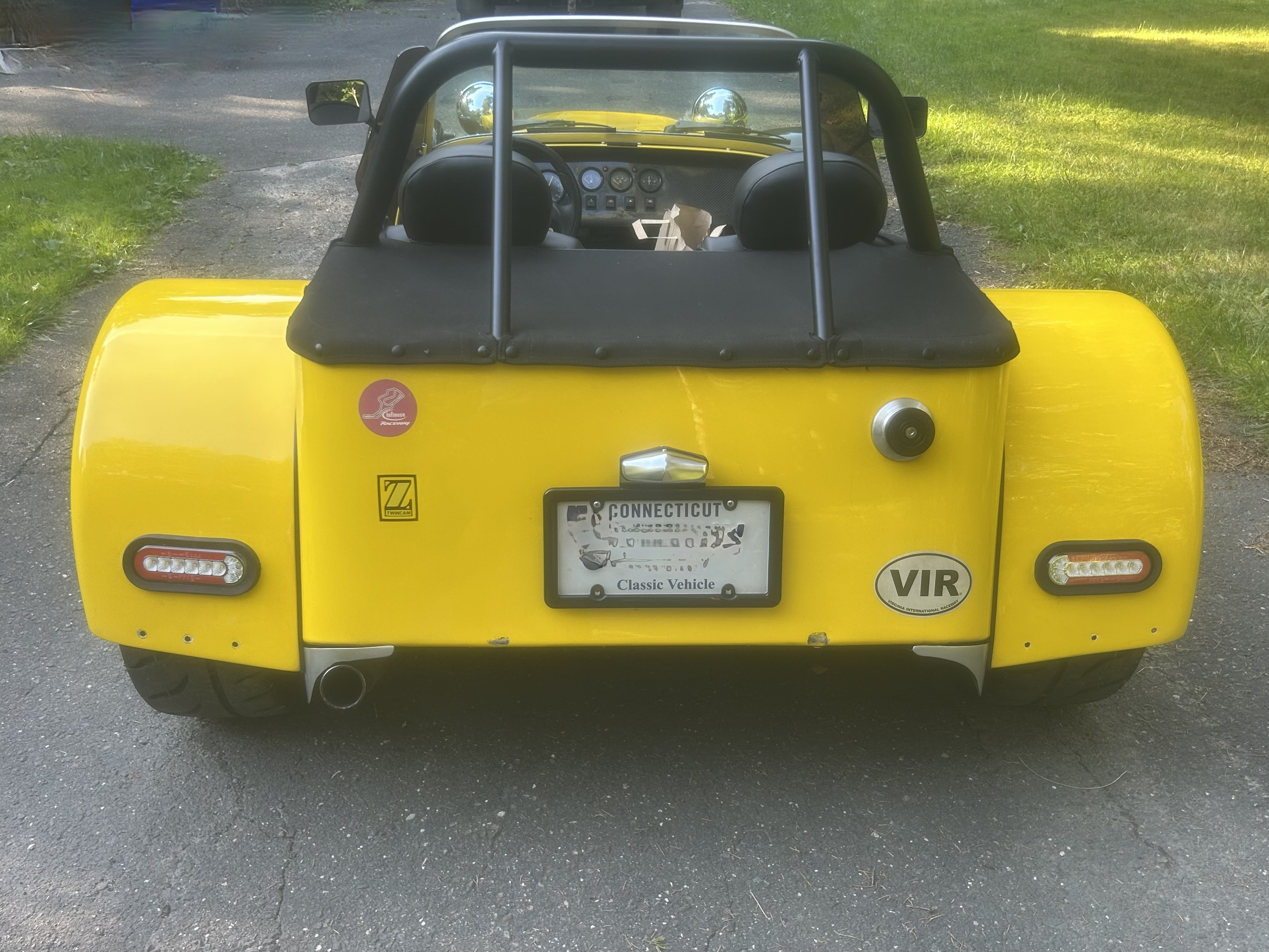

JB455 Posted July 25 Author Posted July 25 Didn't get them installed today- yet. The good news- I did try the grommet in the hole. It's perfect! Even covers the screw holes. So these lights will work. I left the silicone (and dirt) on the fender so you can see the size of the original light. 1

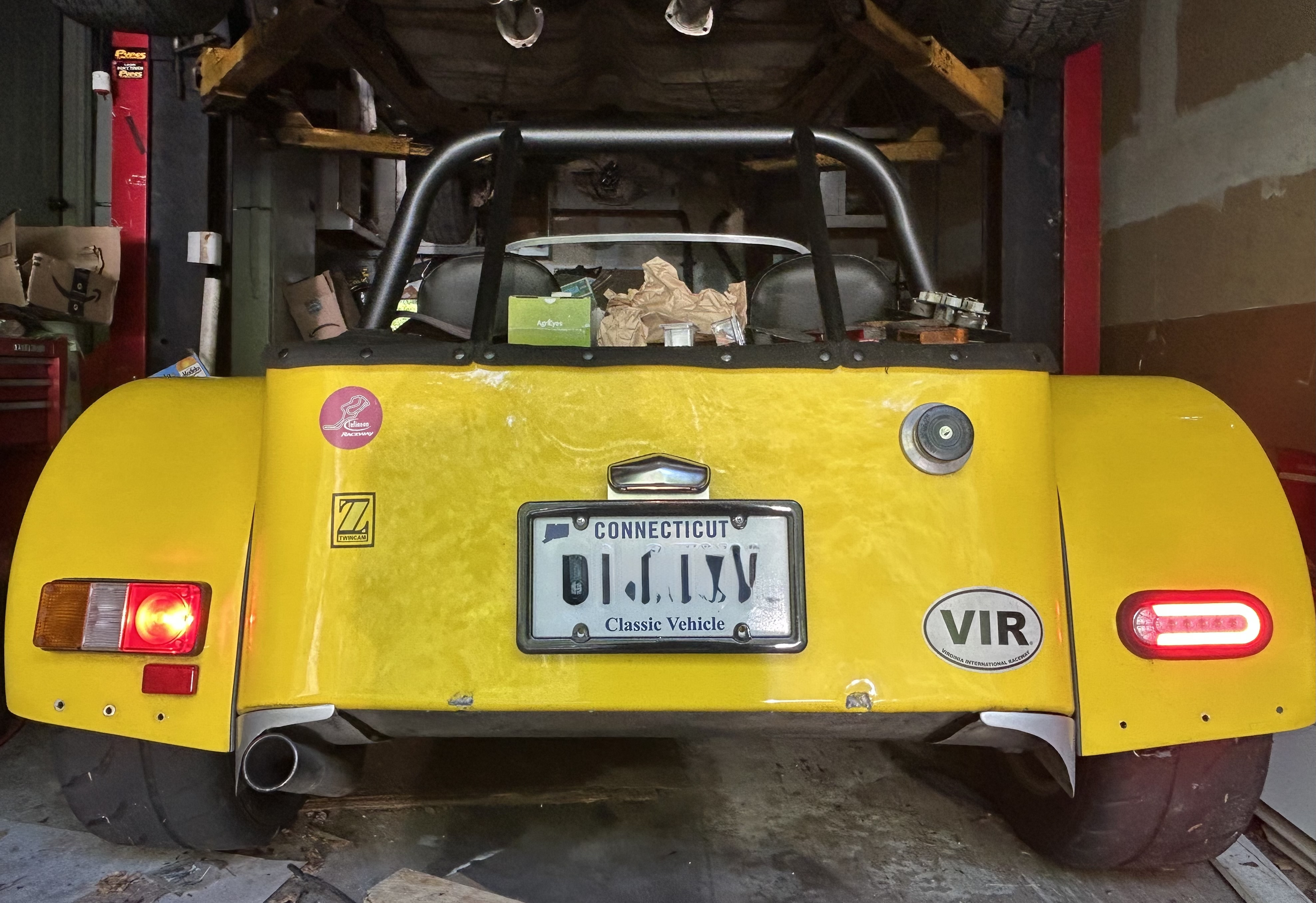

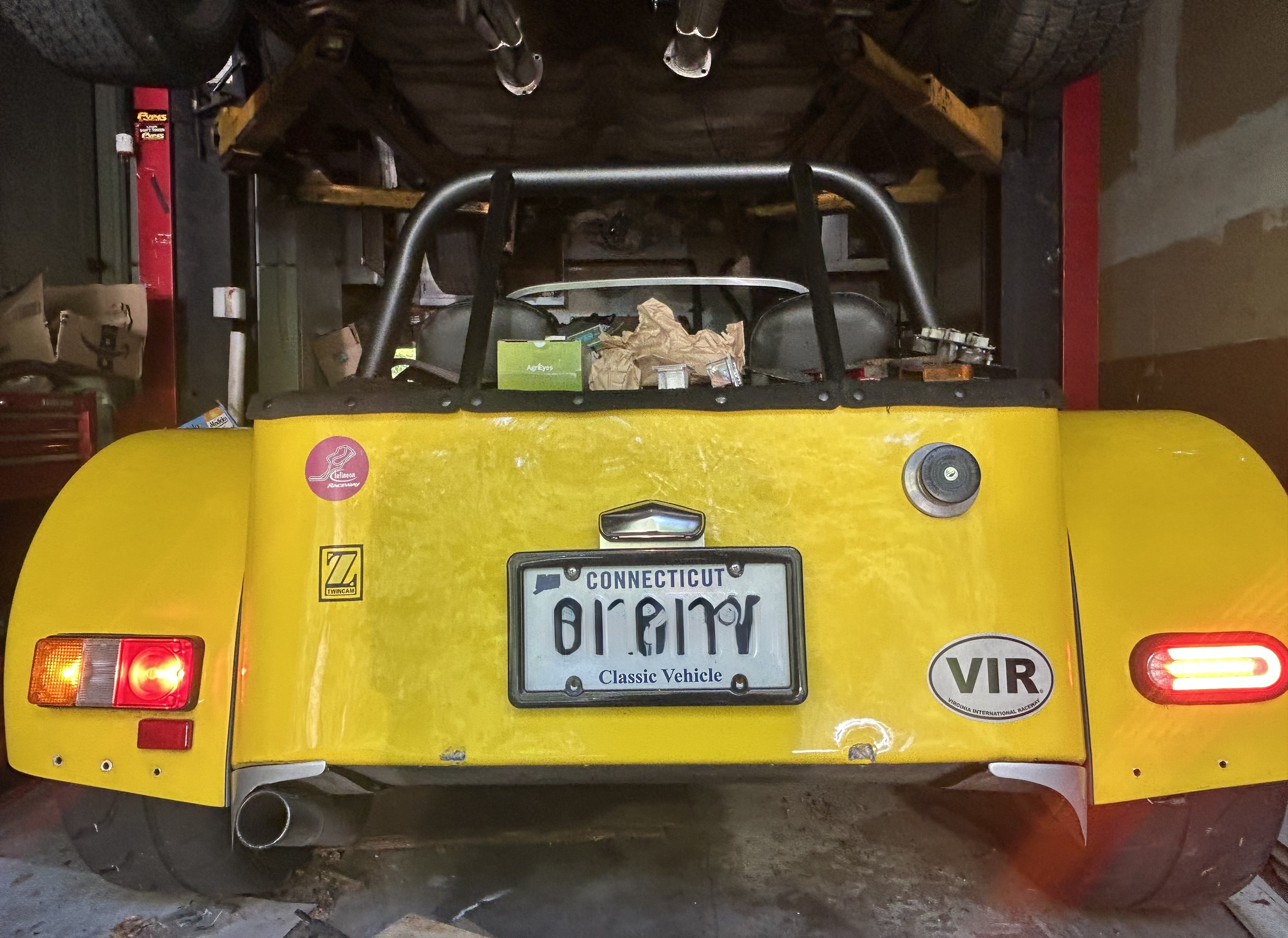

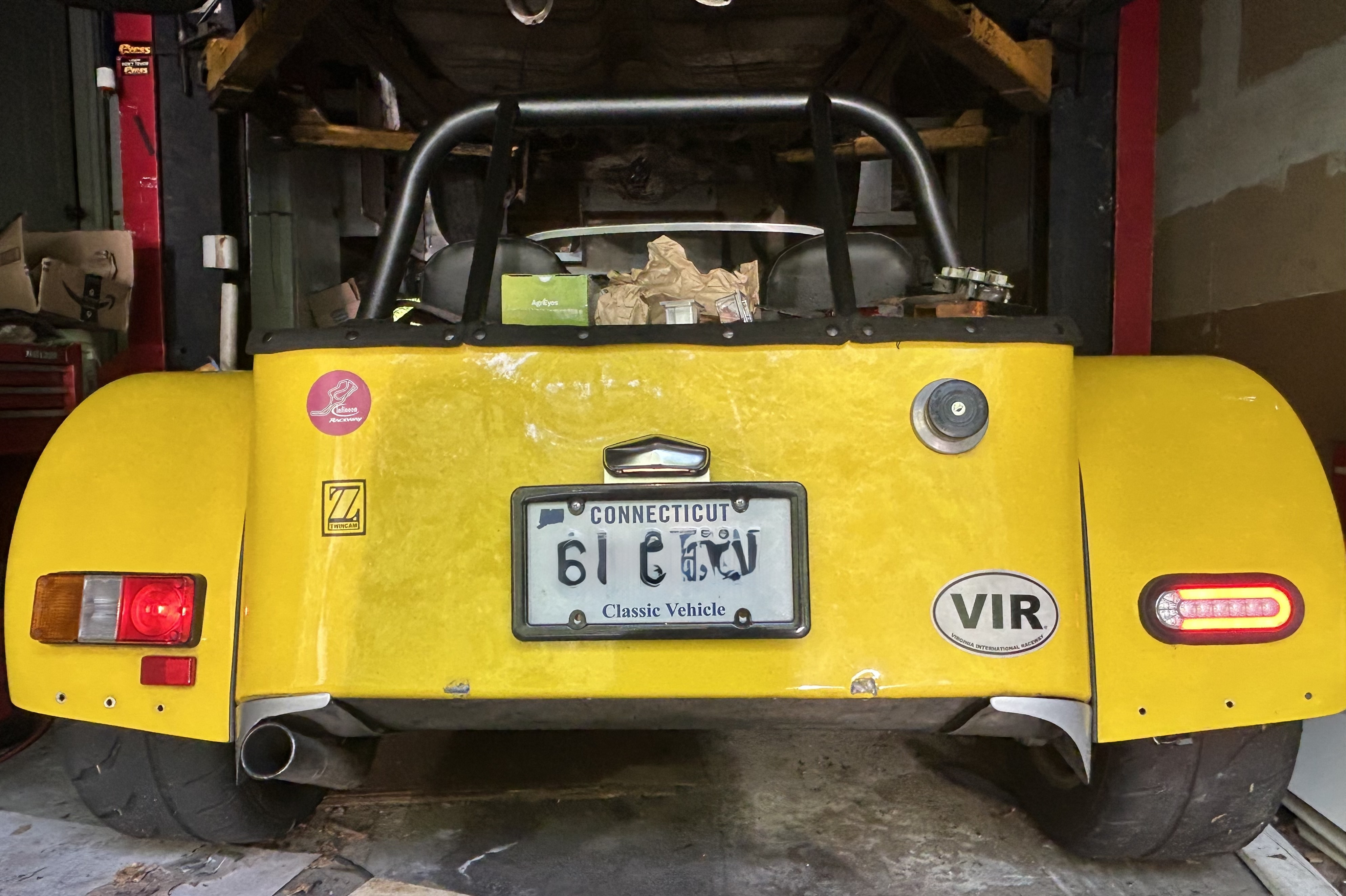

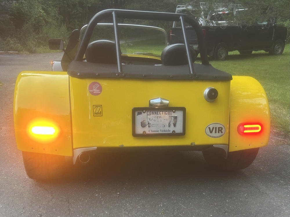

JB455 Posted July 28 Author Posted July 28 (edited) Finally got the lights installed yesterday. I've included pics of them in each function side by side with the stock lights. The LEDs are significantly brighter in every function. The red running and brake functions are very red to the human eye, but don't show well in pictures. The brake function is significantly brighter than the running function, so they should do their job. The blinker is sequential, a little too "bling" for me, I'd rather just on/off. It is yellow, but not a deep amber. They are VERY bright and will get other driver attention. The installation is very straight forward and is easily reversed. I crimped on blade connectors to the new lights so they plugged directly into the existing leads. I did need to open up the bottom of the openings in the fenders. The grommets fit fine, but the ones I used had small small ridges added at the mounting point, presumably to make the mounting extra secure. That would be fine on a heavy steel trailer mount, but the light weight fiberglass needed to opened up slightly to avoid deforming the opening. I took off approximately 1/8" just from the bottom. You can use dish soap on the rubber to allow the light to seat more easily. Ignore the cluttered garage in the photos! 1st pic is running lights. 2nd pic is brake function. 3rd pic is turn/hazard function. Edited July 28 by JB455 1

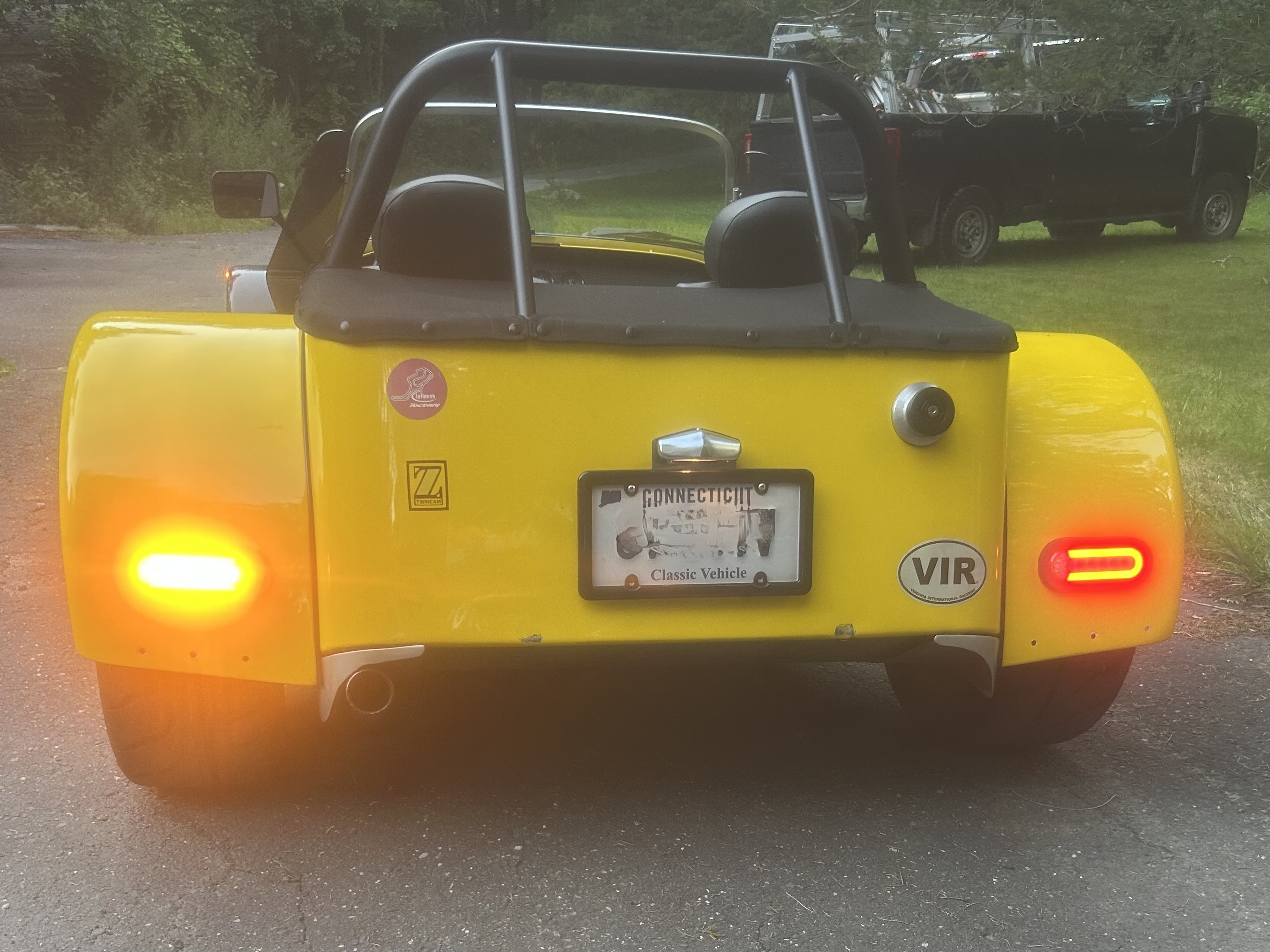

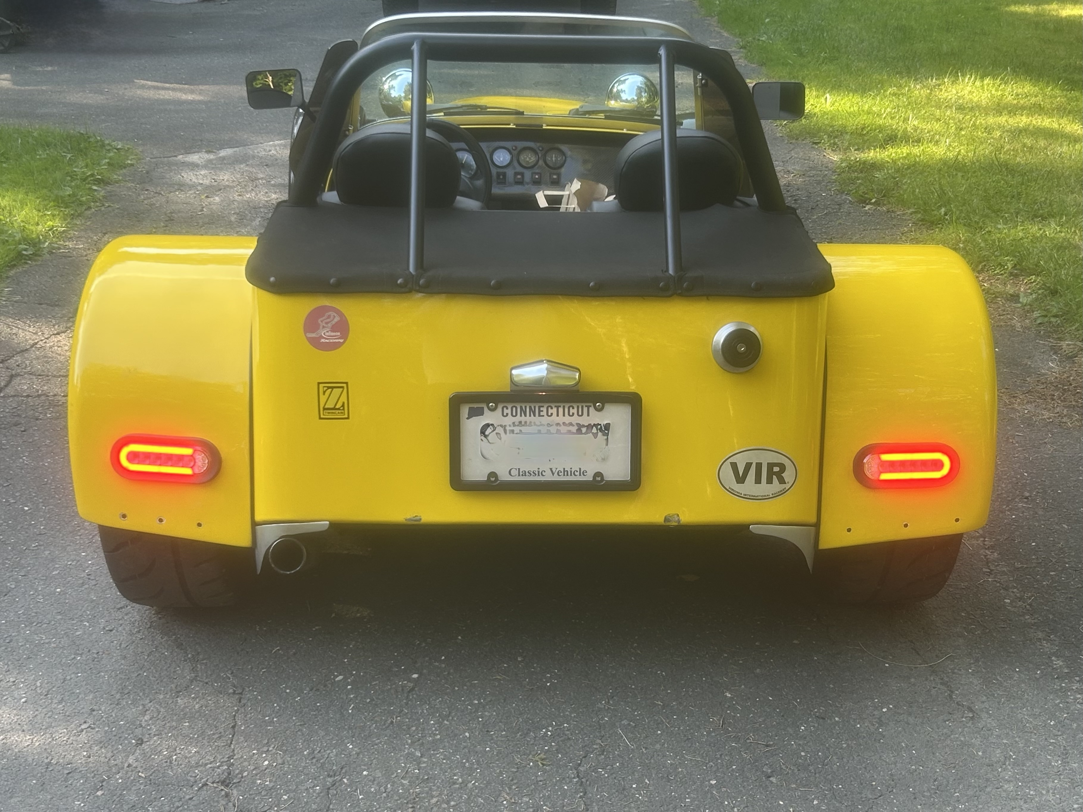

JB455 Posted August 5 Author Posted August 5 (edited) Finally pulled the car out today for the first time since doing the lights. I'm really starting to like them. I think I'll keep them a while. Here's some pics with both of them installed. Light off. They look modern, but not gaudy. Running Lights on. The blinkers are sequential (meh), but they sure are bright! No way anyone could miss them! This picture doesn't do them justice. Edited August 5 by JB455 1
