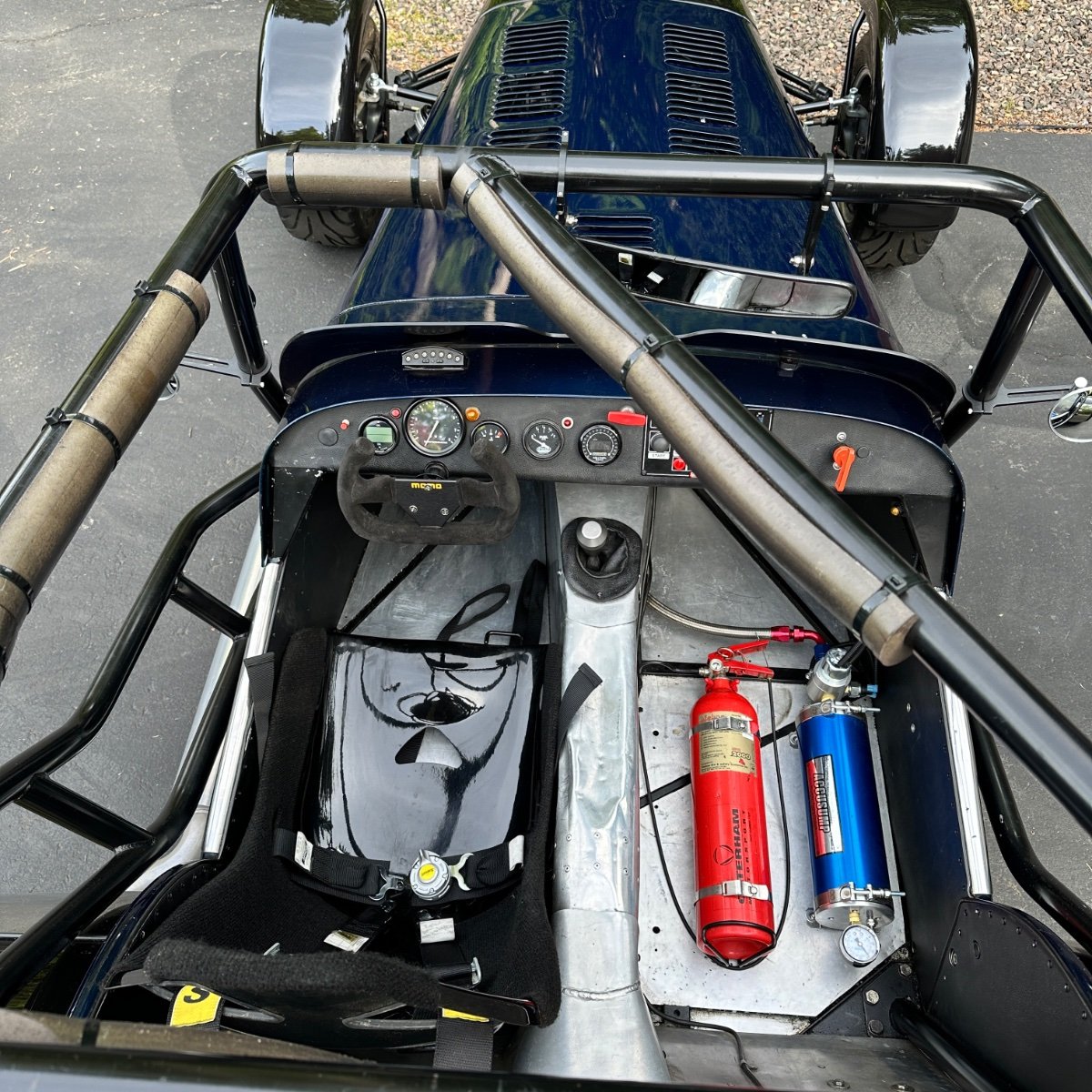

Thanks @Croc, I'll take a picture of the gauge on the fire extinguisher and get one of the Accusump's gauge too. I should probably mention in the ad that I raced the car sporadically so it has gone through the annual technical inspection process. -

Thanks @Kitcat. I'll add the MOMO quick release steering wheel and fire suppression. The fuel pump has a separate switch too rather than operate using the ignition, and there is also a transponder. While it may be possible to license for street use, that would require a title which this car does not have. If I had the Manufacturer Statement of Origin like what Caterham provides now with the kits we import then it could be done in Washington State, but I've no idea what the rules are for other states. In either case, I'm selling as a track/race car only as I really don't like dealing with bureaucracy. -

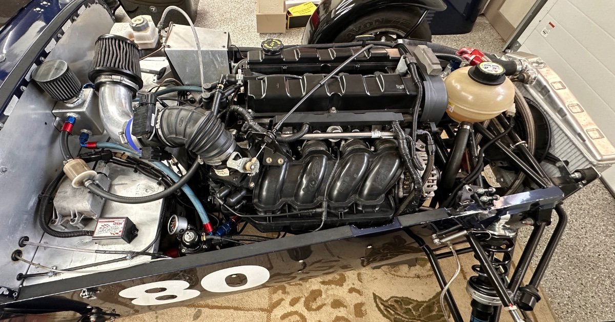

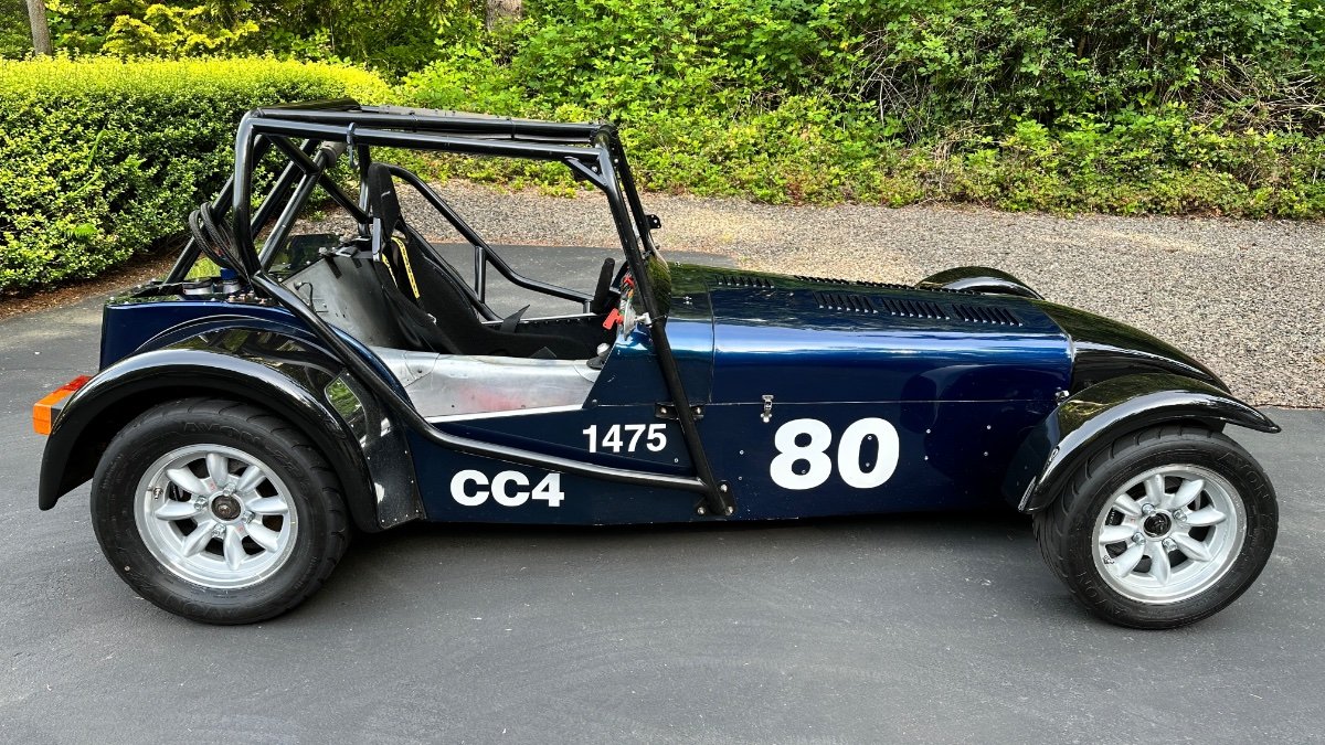

I know some on this forum are familiar with a car I'm preparing to list on BaT as it was owned and tracked by @Kitcat, so I'm hoping to enlist help in making sure what I've written for BaT is accurate and complete. Any comments or suggestions would be greatly appreciated! Here we go: This 2003 Caterham Super 7 race car was imported as an SCCA E-Production model as part of a SCCA homologation program. This program was created in the early 2000’s by Jon Nelson with Caterham USA and Jez Coates with Caterham UK. The number of cars imported under the program is unknown, but several dealers participated, including George Alderman (Delaware), Chip Lamb (Virginia) and Jeff Sloan (Texas). This car is thought to have been imported by Alderman’s Delaware dealership. Homologated models were configured with an imperial S3 chassis, 147bhp Zetec, Watts linkage supporting the De Deon rear suspension, 250# front and 215# rear springs with nonadjustable Bilstein dampers, 10-inch AP Racing rear discs, clamshell front wings, and cantilevered slick tires. After racing in SCCA the car was acquired by Beachman-McClure Racing and modified for NASA racing. During this period several changes were made: · The homologated Zetec motor was swapped with a Zetec SVT · The homologated roll cage was replaced with the current tall cage with side intrusion NASCAR style bars · The homologated fuel cell was replaced with a 21-gallon fuel cell for endurance racing · A jack point was brazed to the rear suspension for use with a quick-jack style jack · A brake bias (proportioning) valve was added · The clamshells front wings were replaced with cycle wings · PIAA night race lights were added (since removed but wiring remains) · The OEM SVT oil pan was replaced with a Raceline wet sump · And an Accusump was added for extra oiling protection The car is best known for placing third overall in the 25 Hours of Thunderhill in 2009 (https://beachman-mcclureracing.blogspot.com). Beachman-McClure Racing sold the car in 2013 to the prior owner before the current owner purchased in 2022. Under the prior owner the fuel bladder and hoses were replaced in 2017, and a short block Zetec SVT engine swap was performed in 2019 (see attached dyno report). The original Zetec SVT engine is included in the sale. In preparation for the 2022 sale the prior owner had Rocky Mountain Caterham go through the car replacing worn and damaged parts: · The 22% “fast” steering rack was replaced with a new 8% rack and rod ends · The A-frame was replaced as the existing A-frame was binding · The front dampers and springs were replaced with new Bilstein dampers and new 250# springs · The rear dampers were replaced with new Bilstein dampers and 215# springs reused · The brake rotors, pads and fluid were replaced · The radiator was replaced as were the coolant hoses · The nosecone, front wings and wing stays, and rear wings were replaced · The Momo containment seat seen in historical pictures was replaced with a Caterham GRP seat (same as used for Caterham Academy racing) · And a new Sabelt six-point harness good until 2028 was installed Rocky Mountain Caterham also set up the suspension, using 2-2-2 for the A-arms and corner weighting (see attached suspension setup sheet). Under current ownership the following noteworthy changes and maintenance were done: · The Accusump valve was replaced with an electric valve and cutoff switch · The front upper ball joints were replaced with Jack Webb Motorsports heim joints for easy camber adjustment and wing stay removal · A Quickcar Racing Products ignition panel was added · The transmission and differential fluid were replaced · The clutch slave cylinder was replaced, and a Caterham clutch pedal stop added · And connection points were added for an AiM data logger
